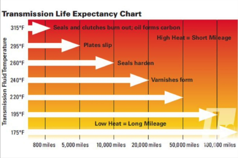

Heat Is The Main Enemy & Yours Is Fine When Cool - A friend sold me an 88 or 89 Mazda 323 sometime early 2000. The trans-fluid was silverish. Did a flush with some generic ATF. Didn't last long and it limp home on a hot summer day. Had to get off the freeway and take local roads. Long story short. After installing a cooler and better Trans-Fluid it ran great.
