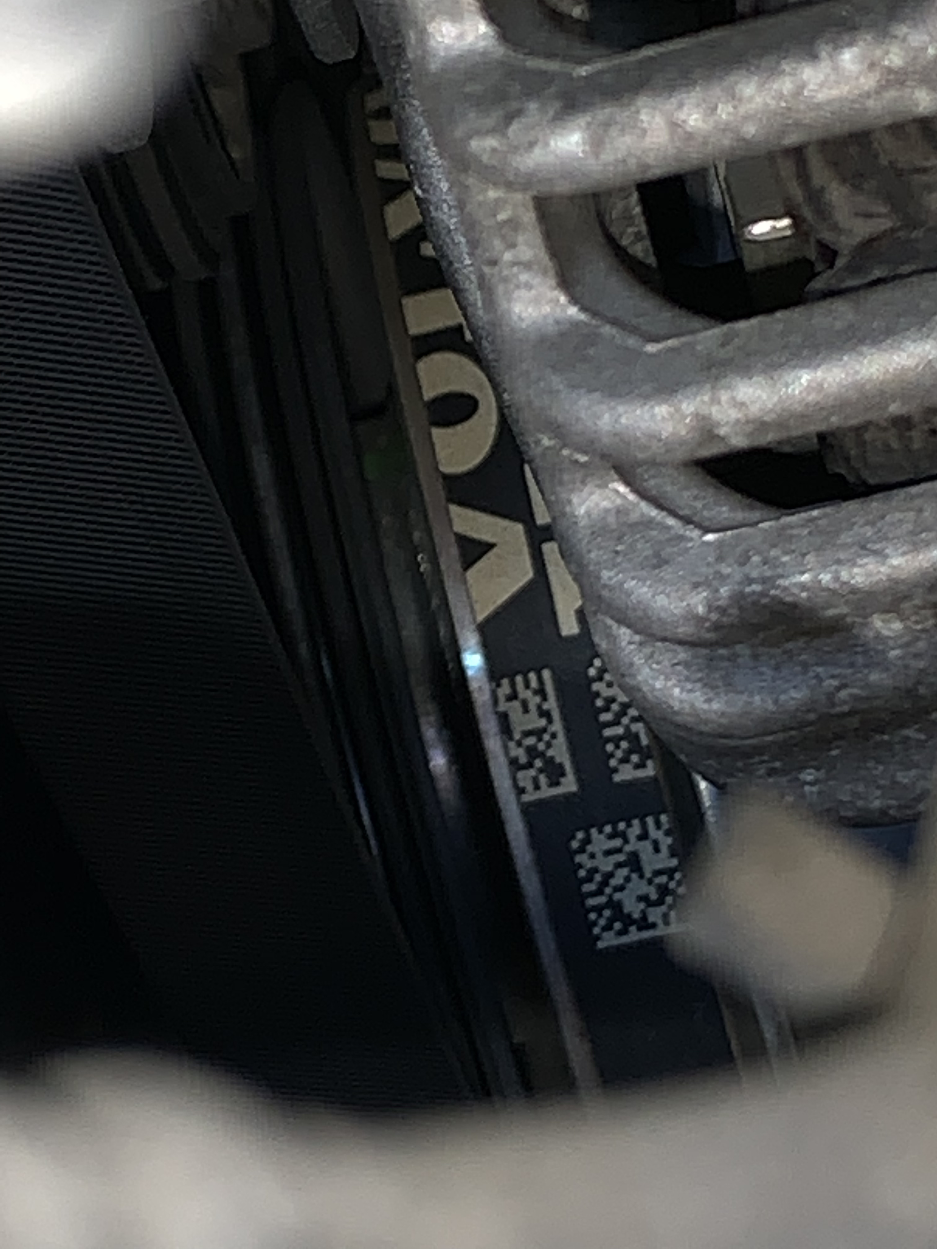

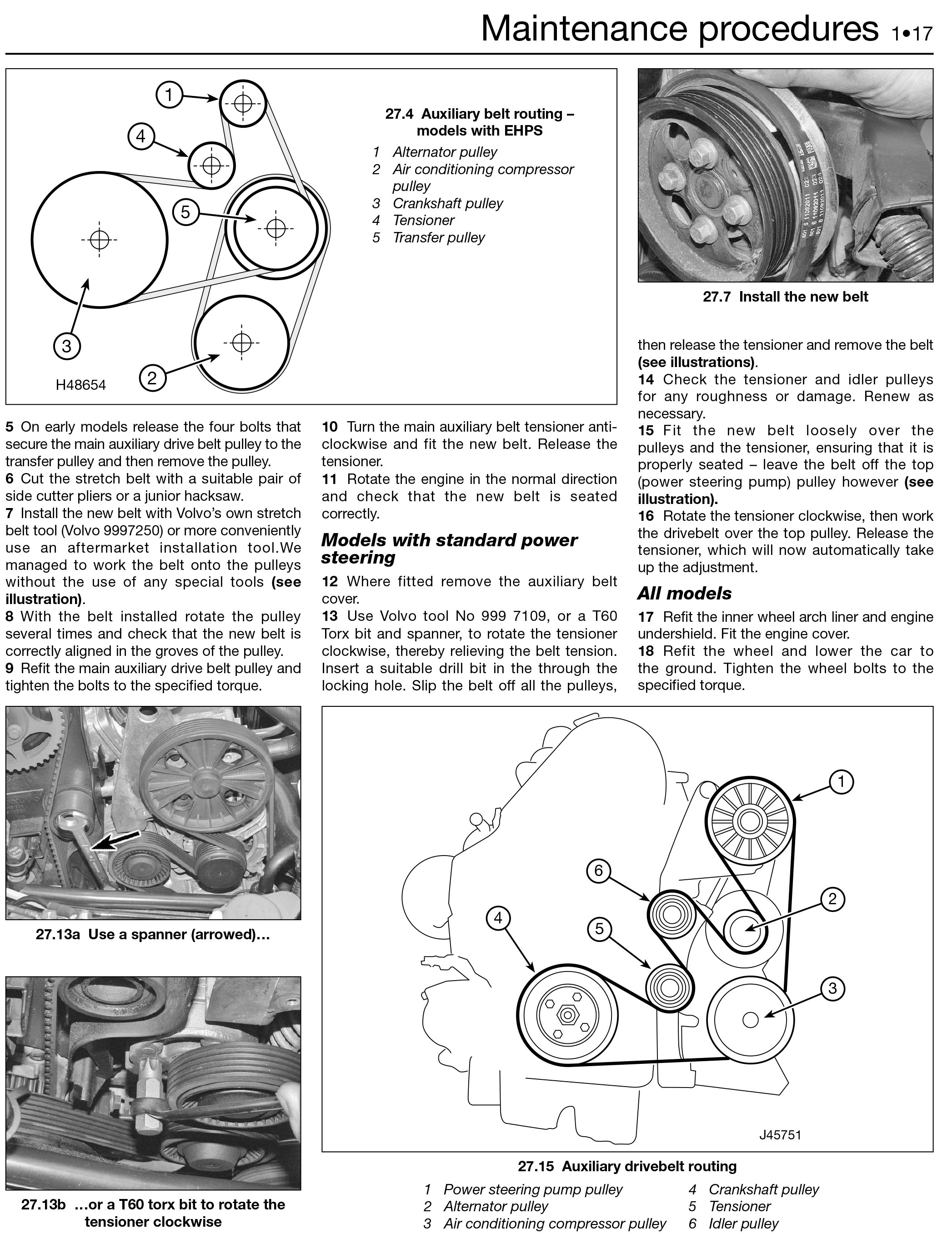

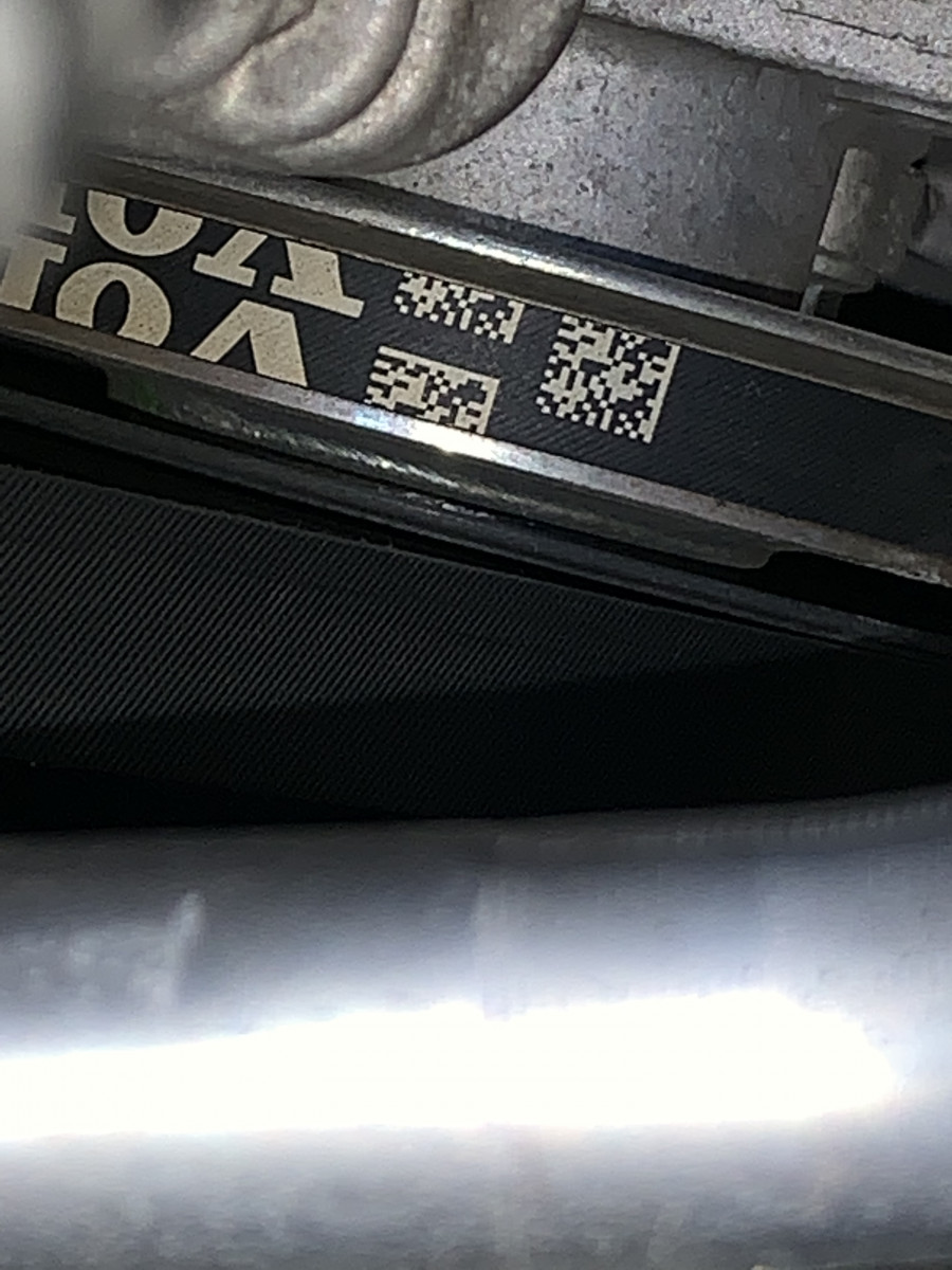

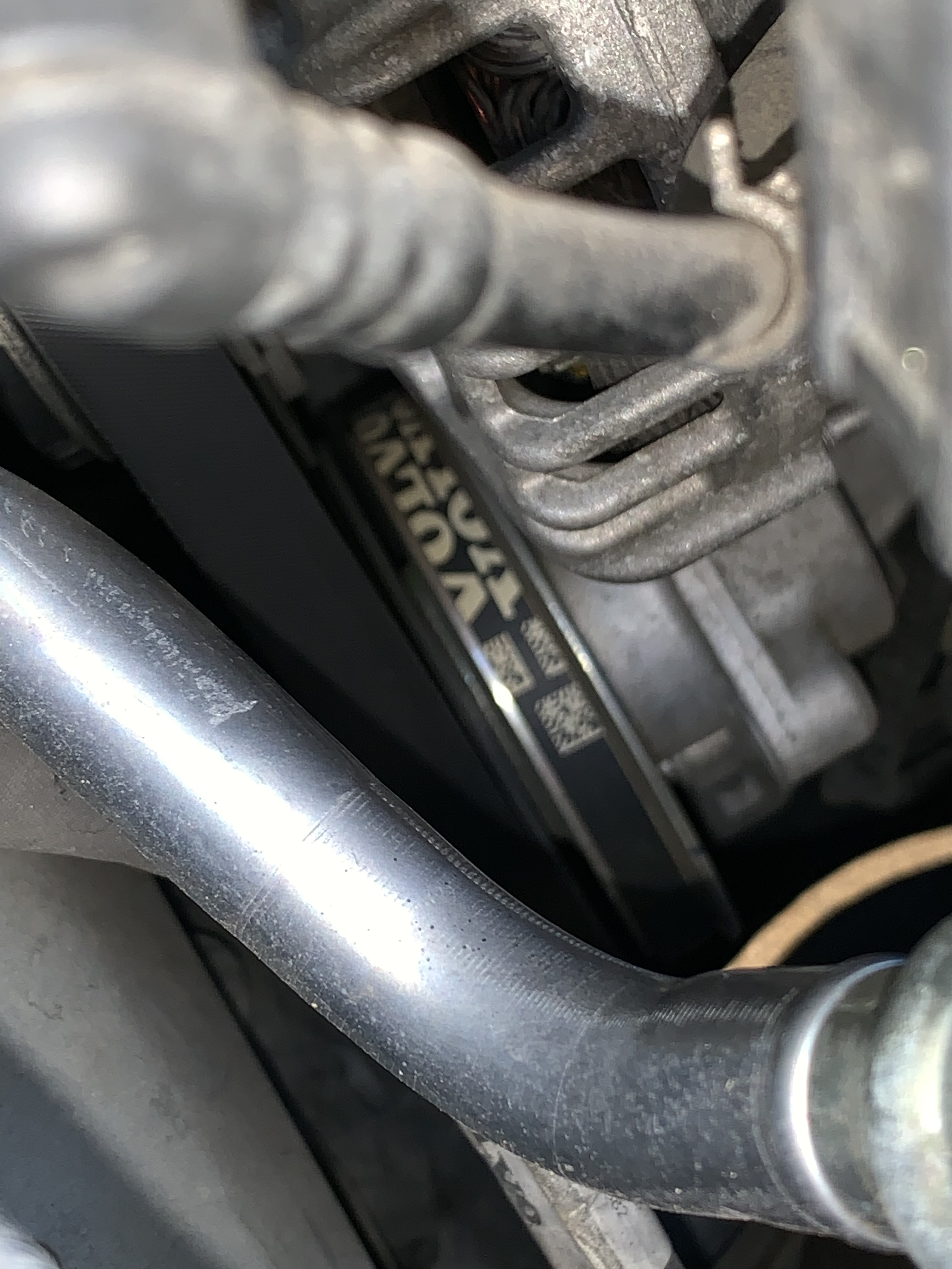

Every compressor I see on the internet that is for an S60 shows the clutch assembly with the grooves for the drive belt. It’s real cramped to be sure, but mine has the main drive belt and I swear there is a smaller belt between it and the compressor itself. I hate to sound dumb, but it just looks different than what I see on the internet.
Ok, a bit more. The pictures show what I thought was the pulley that drives the compressor. Apparently not. I can’t see anything, so I started feeling around. The pulley with the serpentine belt on the front and smaller belt on the back apparently drives the compressor pulley with that smaller belt. All this time, I had thought that was the compressor. I just can’t find anything online showing multiple belts like that. I can’t find any type of parts listing for the smaller belt, any picture I find of a serpentine belt routing doesn’t show it. This really has nothing to do with my ac isn’t running correctly, it just kind of makes me nutty that I can’t find anything showing this.

I have a 2012 T5 and it appears i also have a separate belt for the compressor. I have vida/dice and wonder if it would show me anything.
Anyway, rockauto shows compressors with 6 rib, 5 rib, and 3 rib pulleys. Doesn't help much. I suspect mine is a 3 rib as it does look narrower.
Maybe go to a volvo dealership and get a part number from them.
I also think it is a stretch belt and my limited experience with those is that it sucks getting them on, even with the tool.
I’m positive it’s a 3 groove pulley. On most of the new compressors I’m seeing, they are 5 groove. The salvage ones on eBay etc and rebuilt ones all look to be 3 groove. That control solenoid looks to be pointing up and towards back at a 45 degree angle so I’m assuming the only way to get it out is to remove the compressor.
