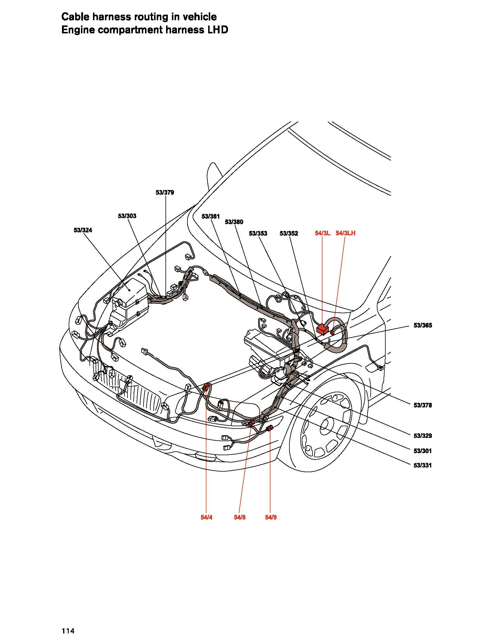

Looking for this connector. I need to find it so I can check it for corrosion.... anyone?
- RickHaleParker

awesome! Thanks!!! have a ecm 2400 signal high permanent fault. gonna check connection between that and fuel pump relay
