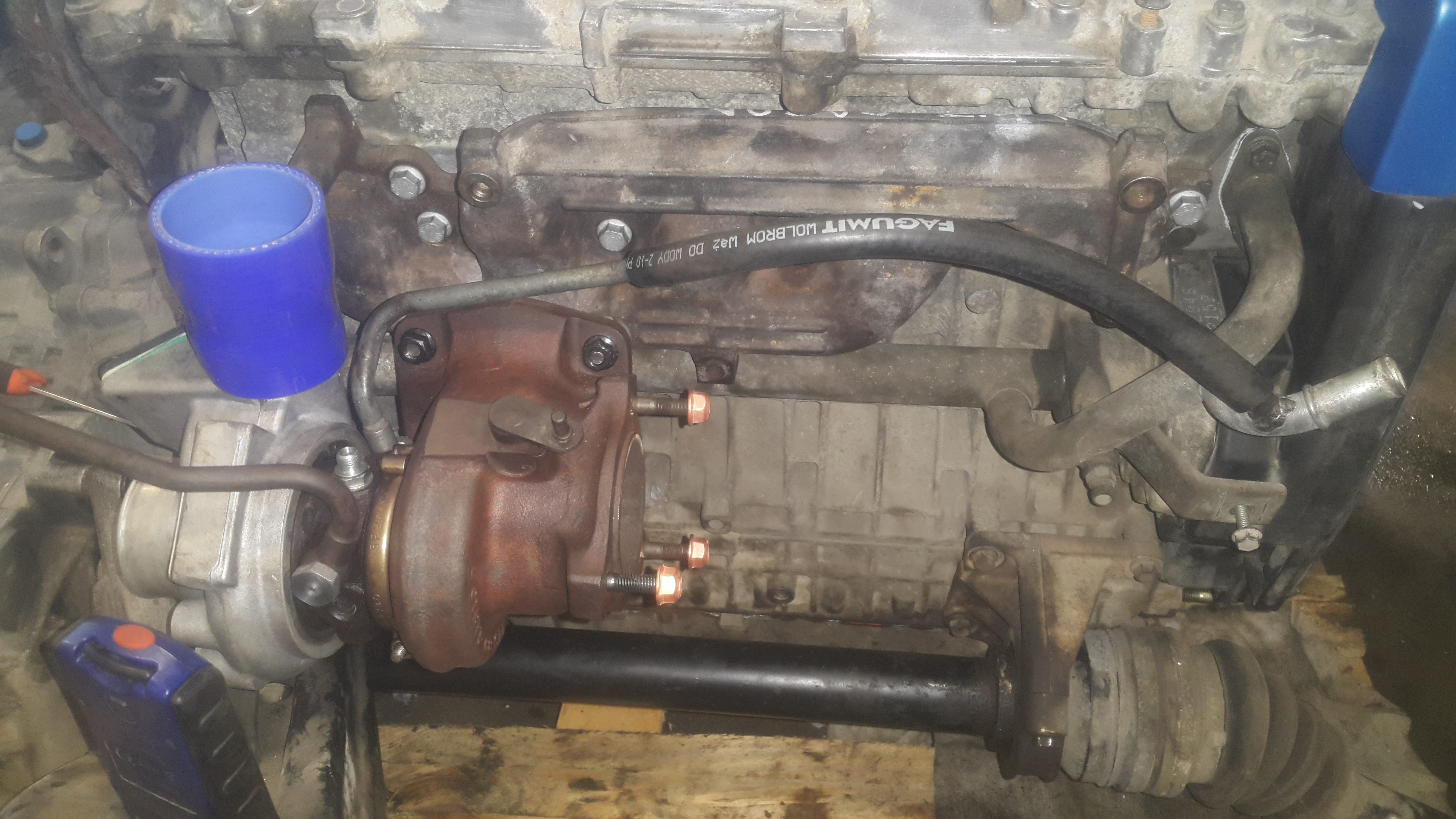

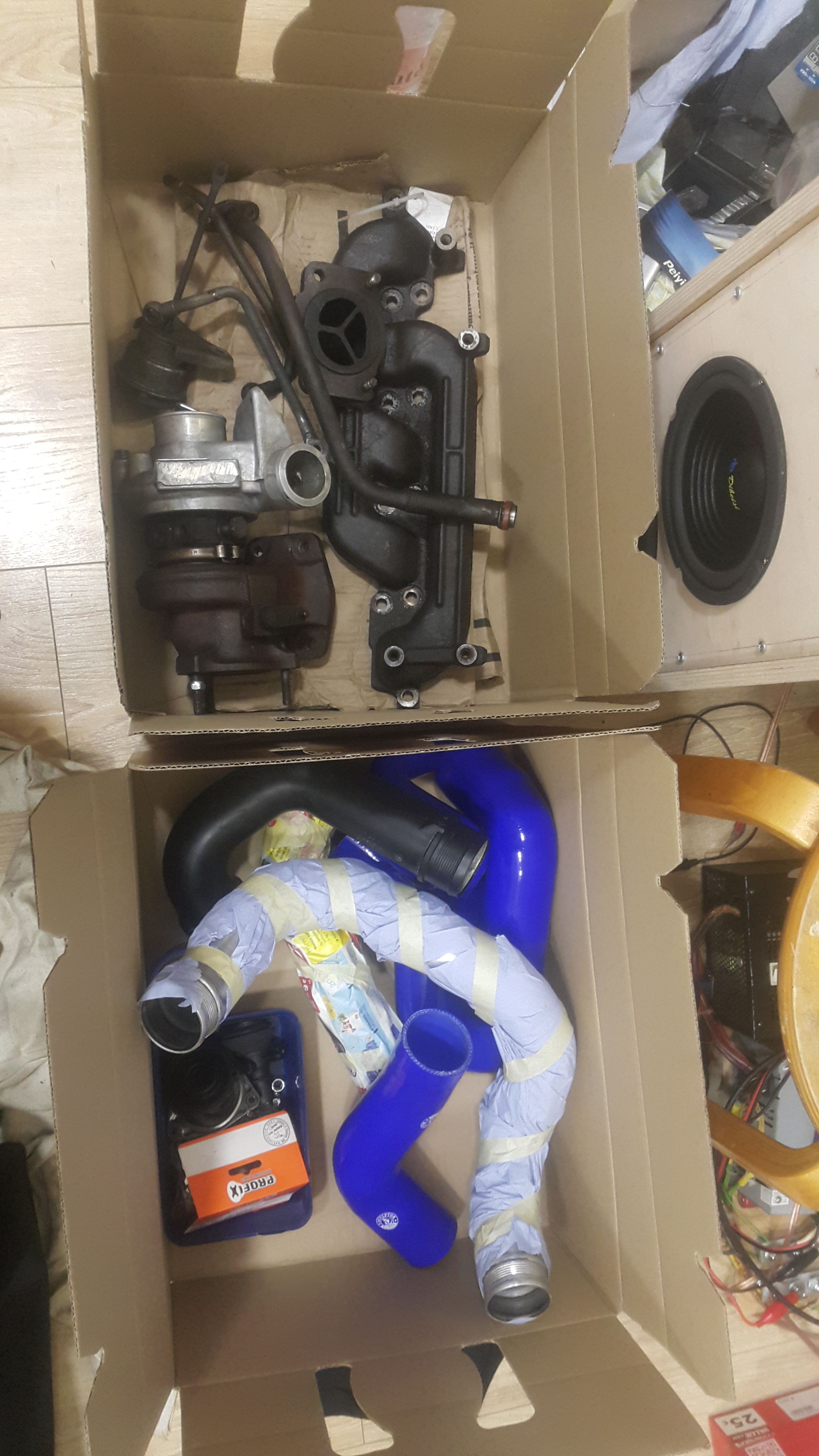

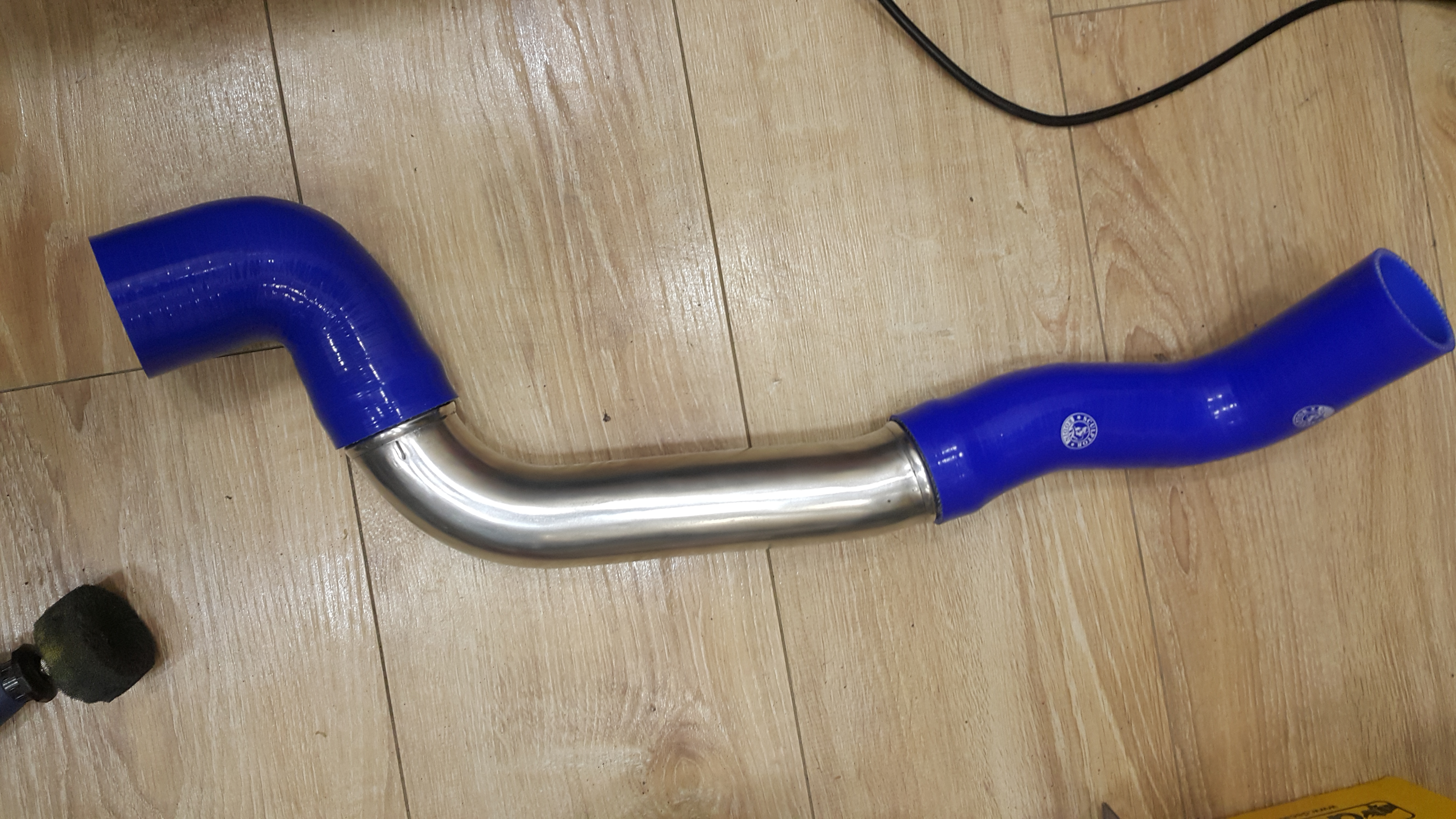

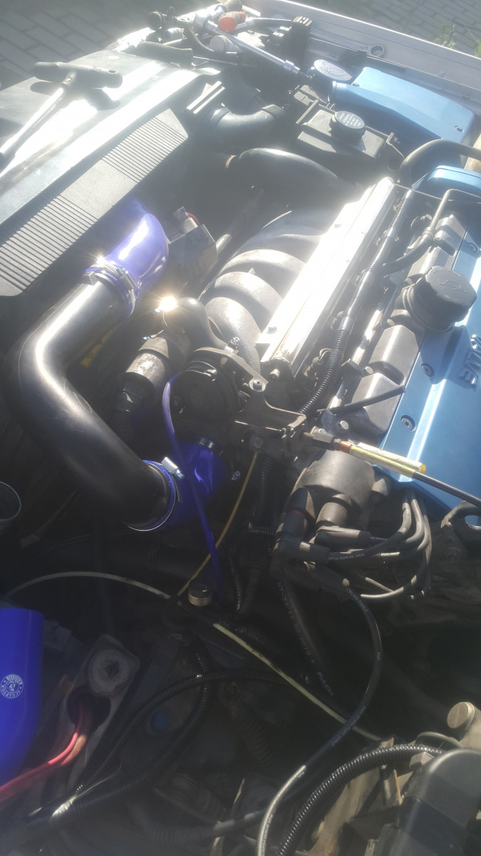

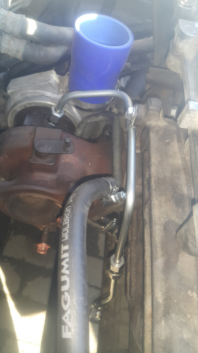

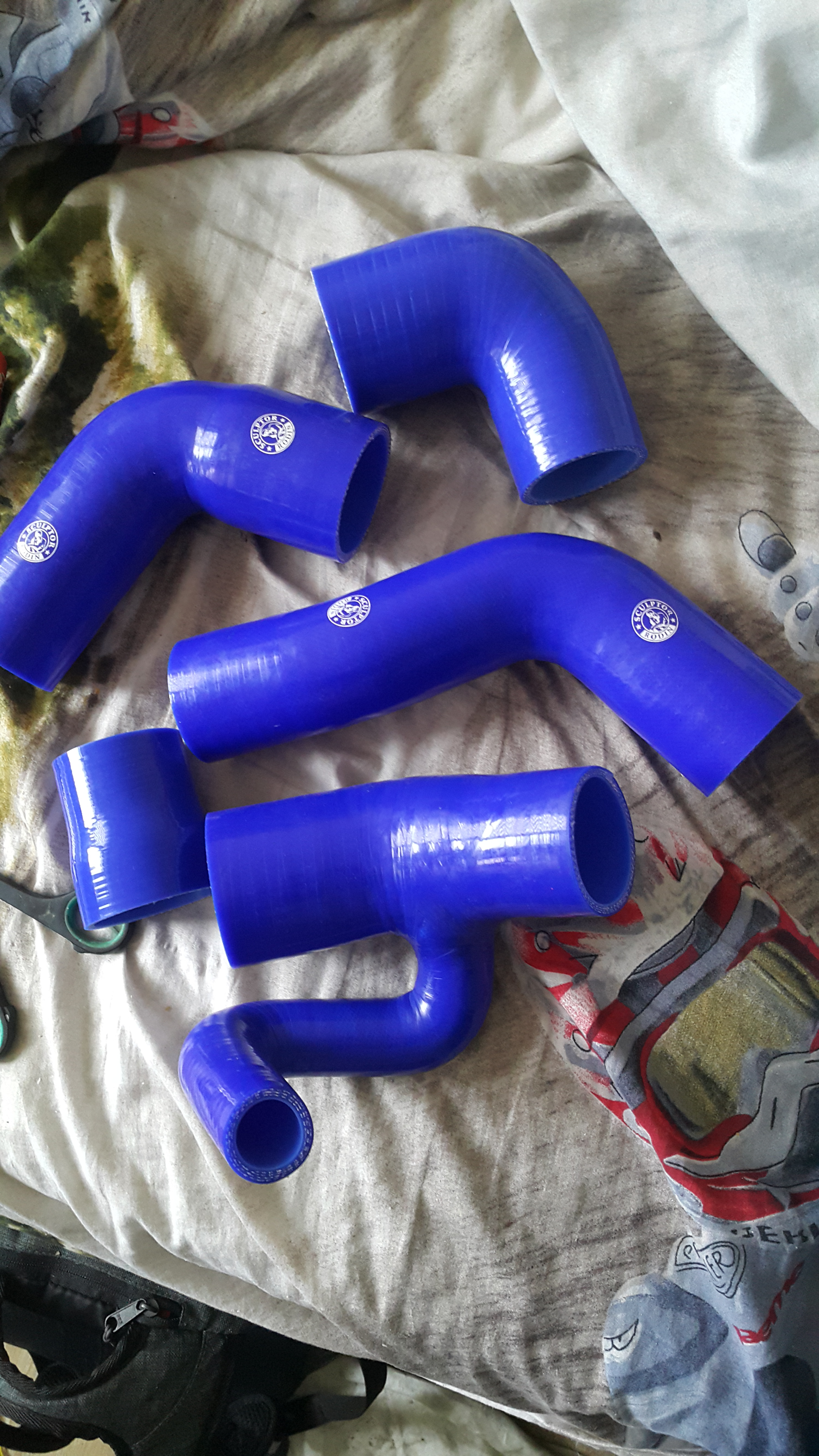

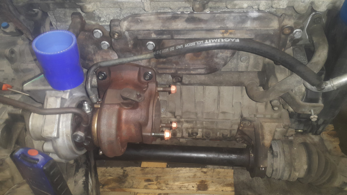

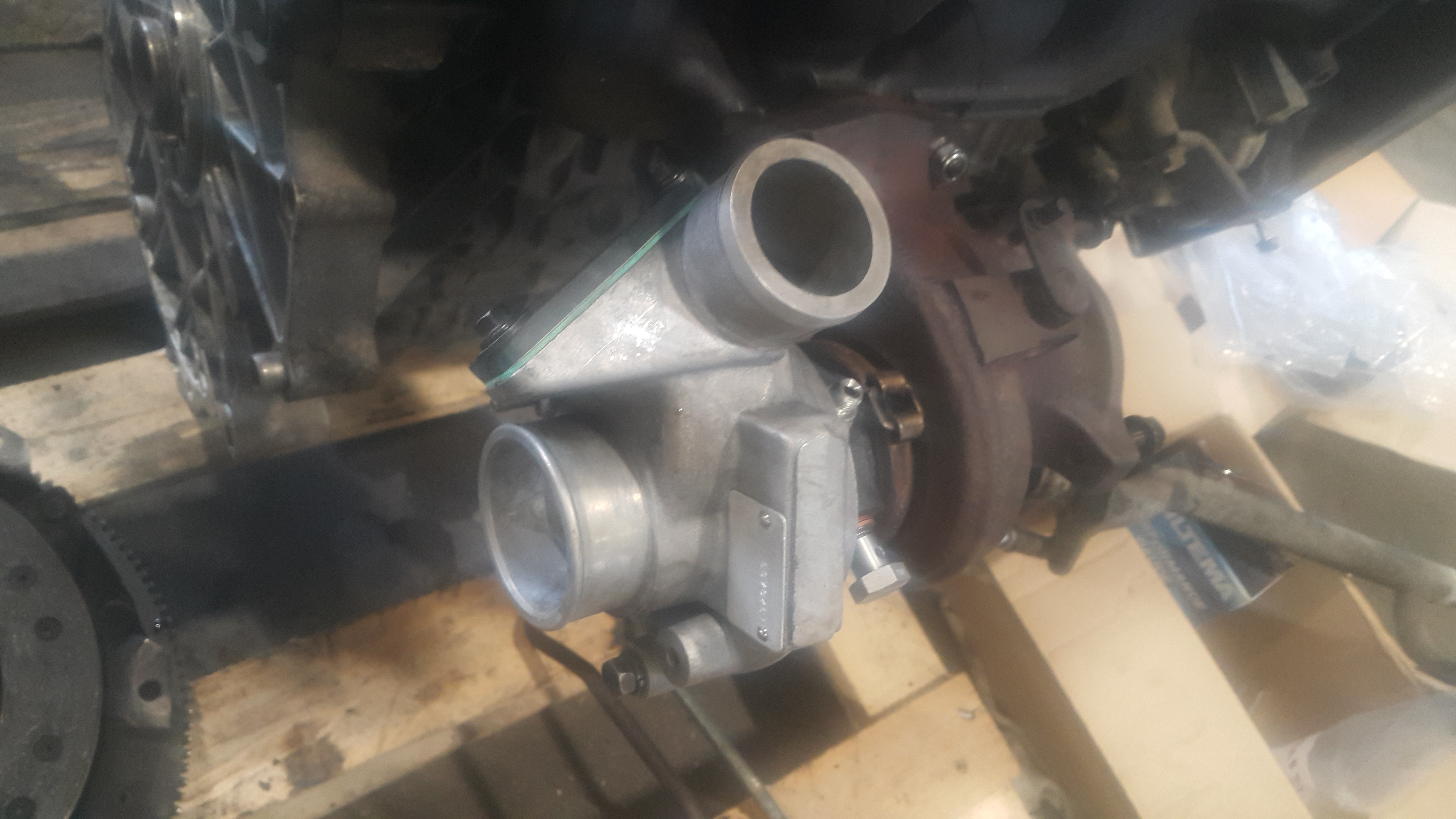

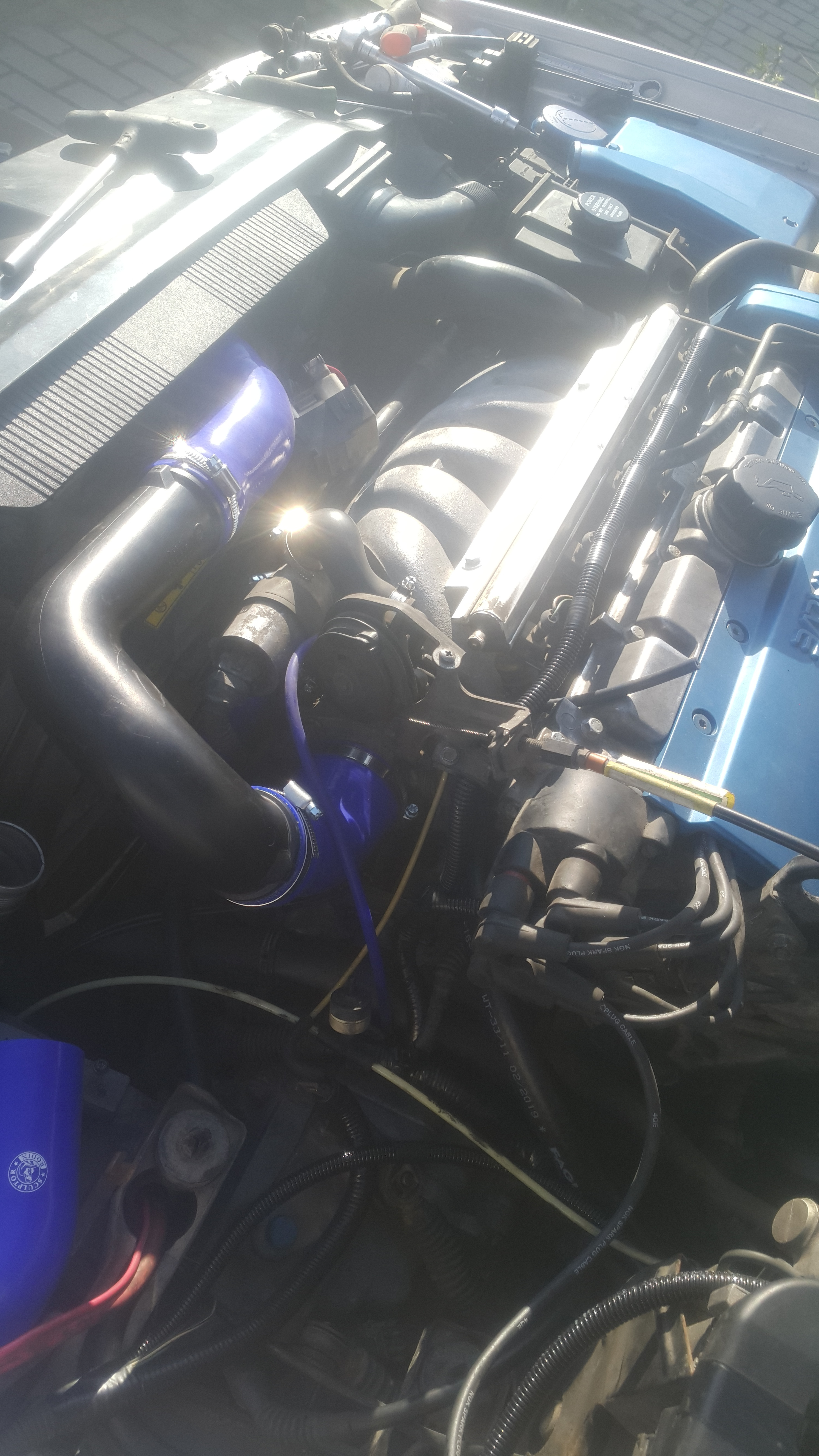

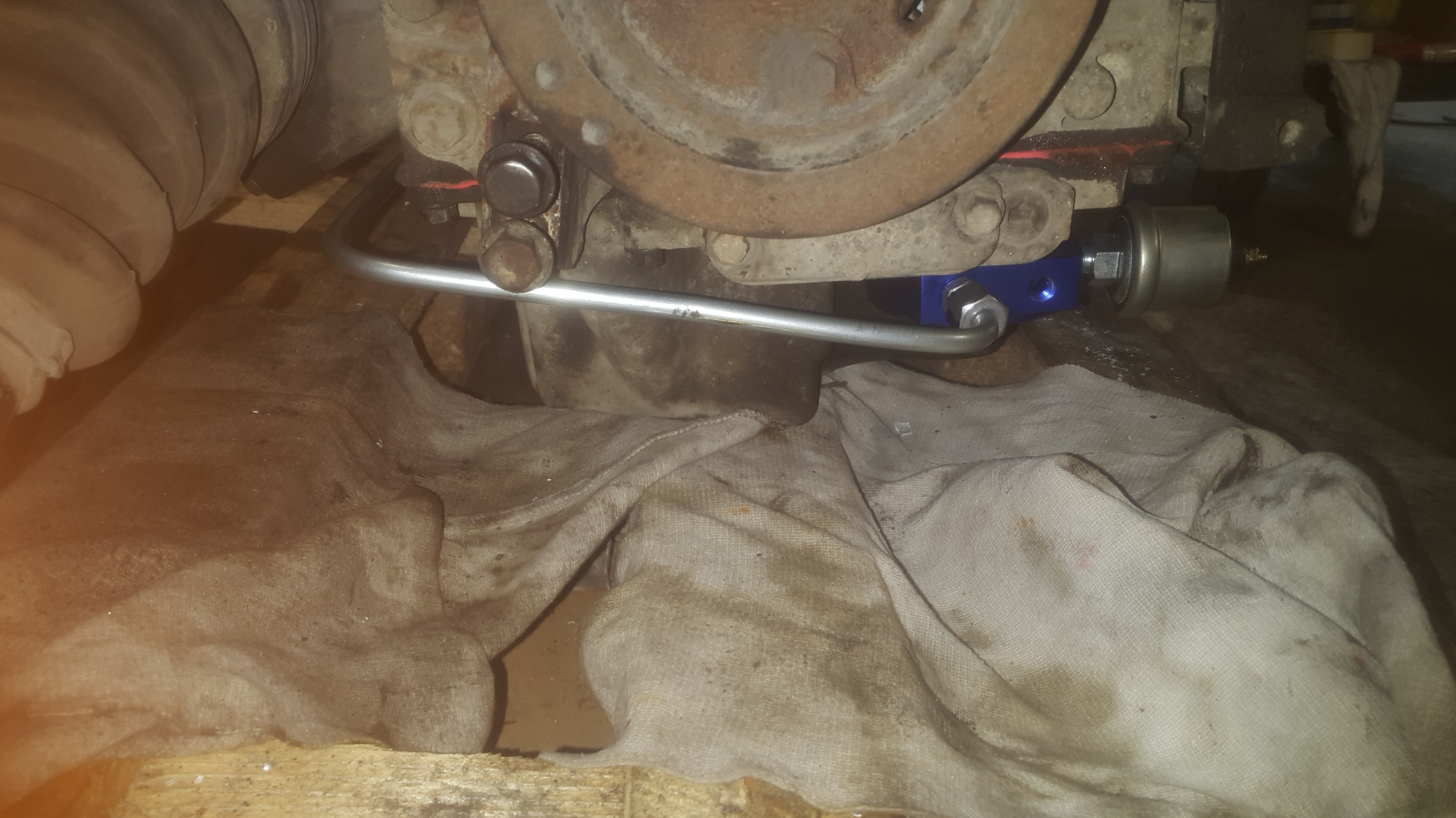

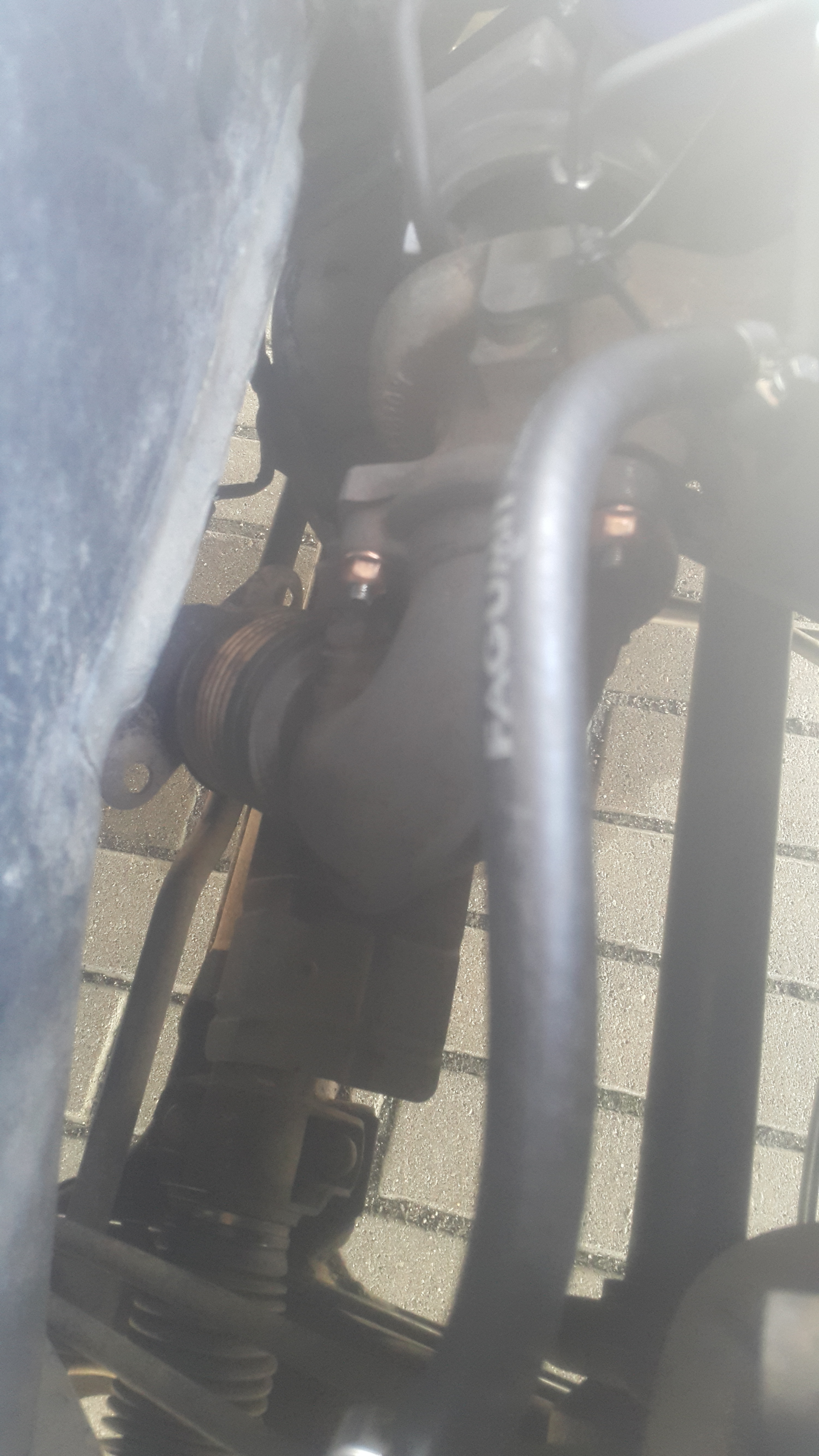

I have build 1993 volvo 850 with b5204s engine .
I used mitsubishi turbo from volvo 940
You can find videos of my car on my youtube channel "Erikas Ambrozas" I will post video of build deatails and photos on my channel.
I am currently runing stock jetronic ecu on low boost I will swap ecu and wiring harnes.

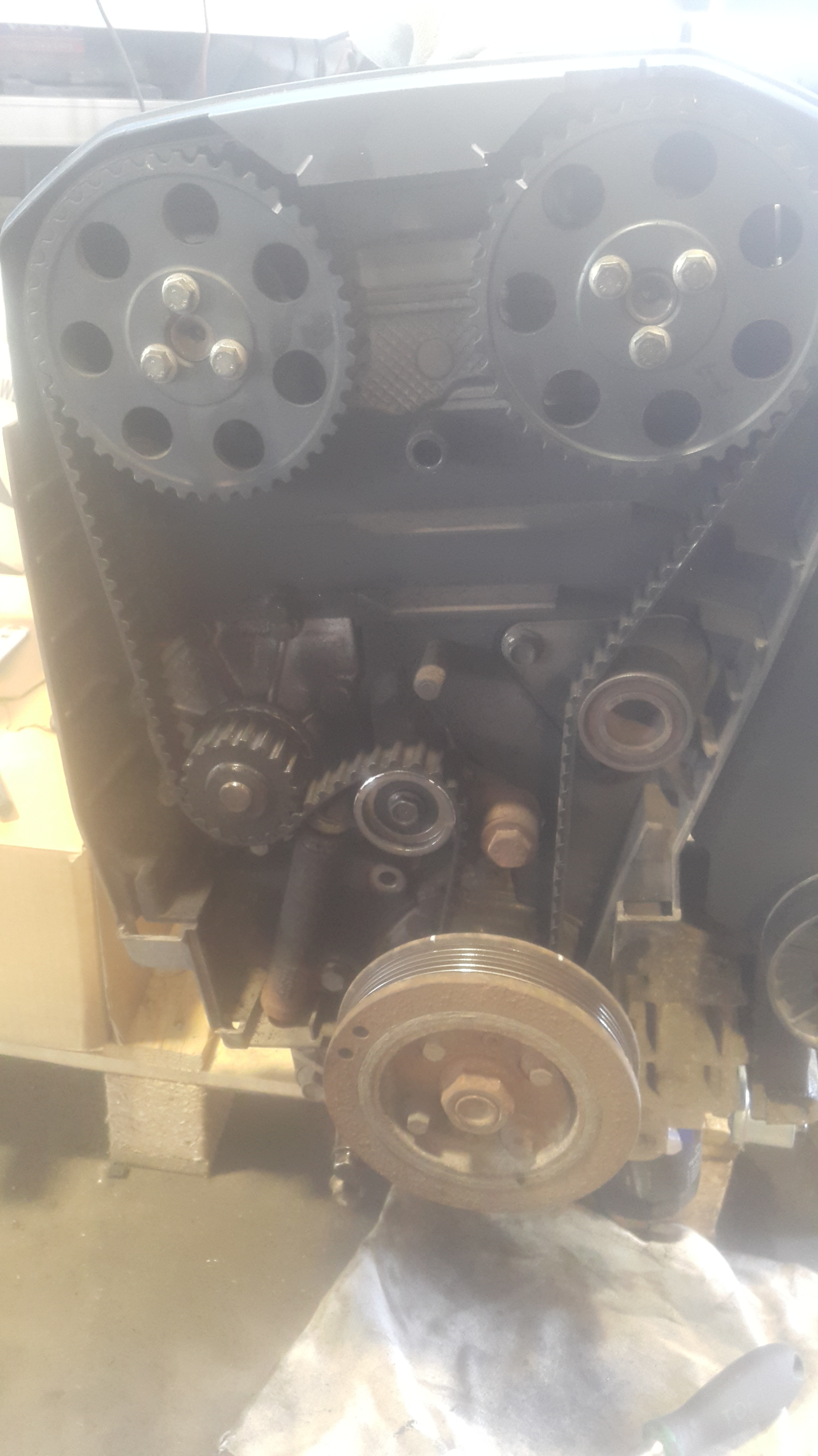

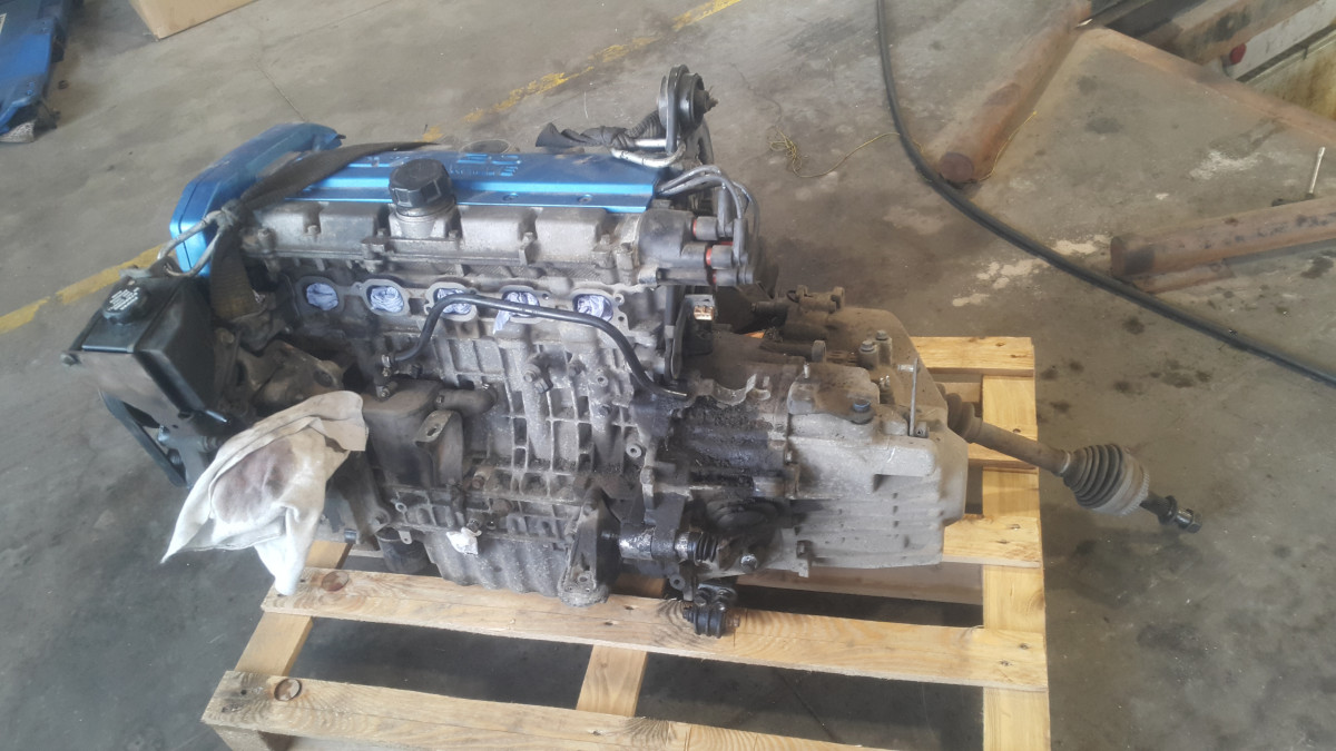

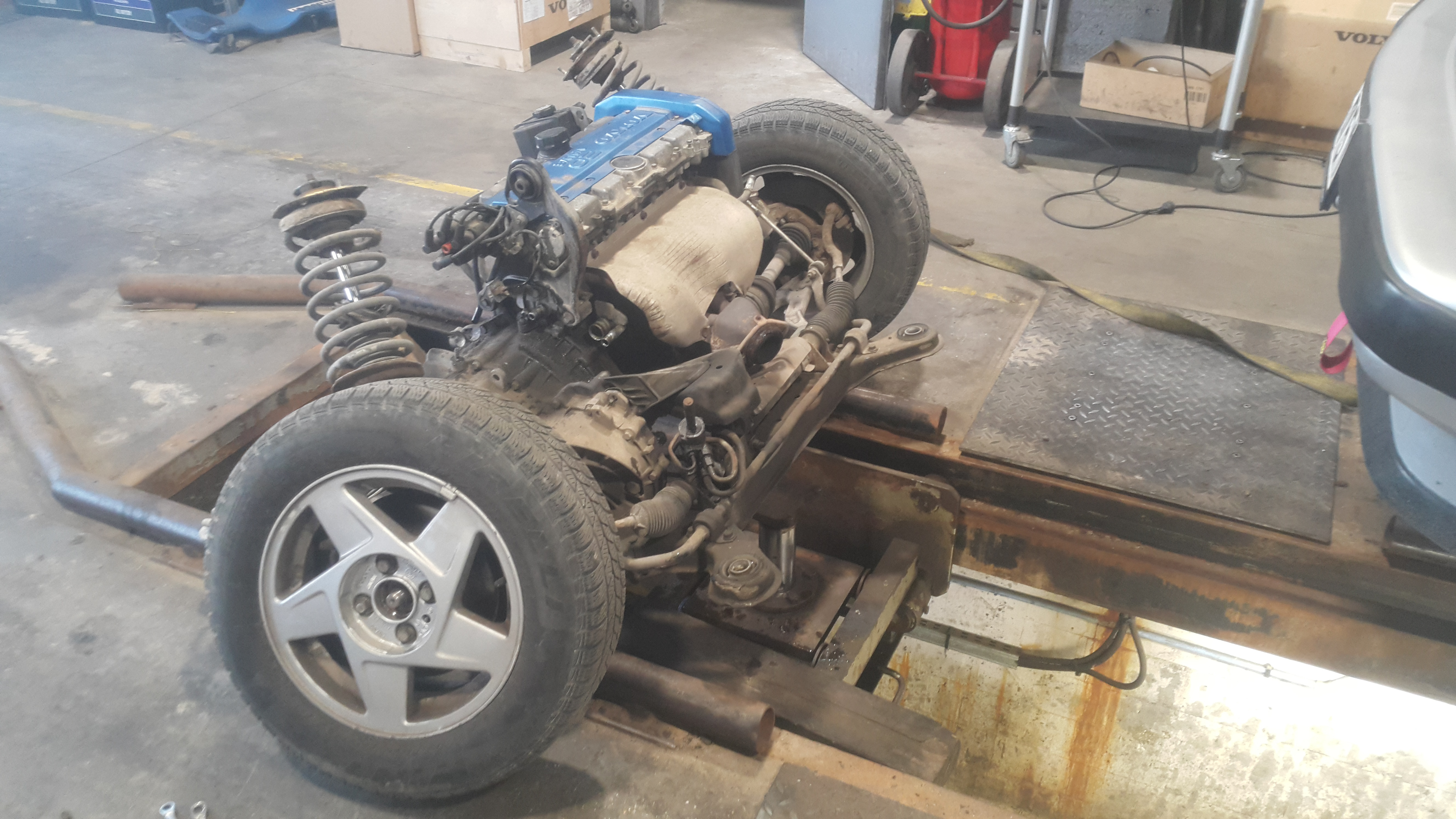

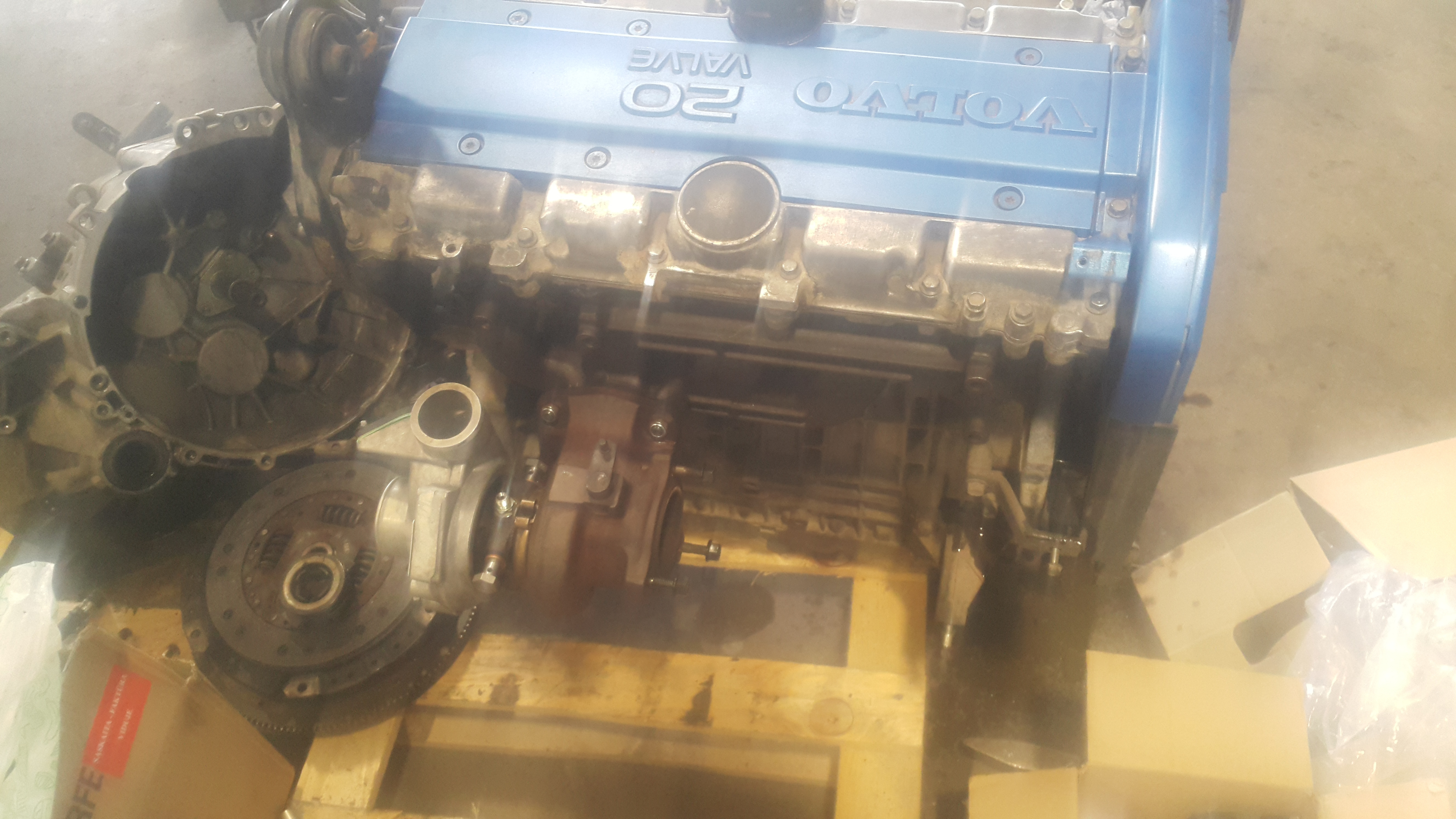

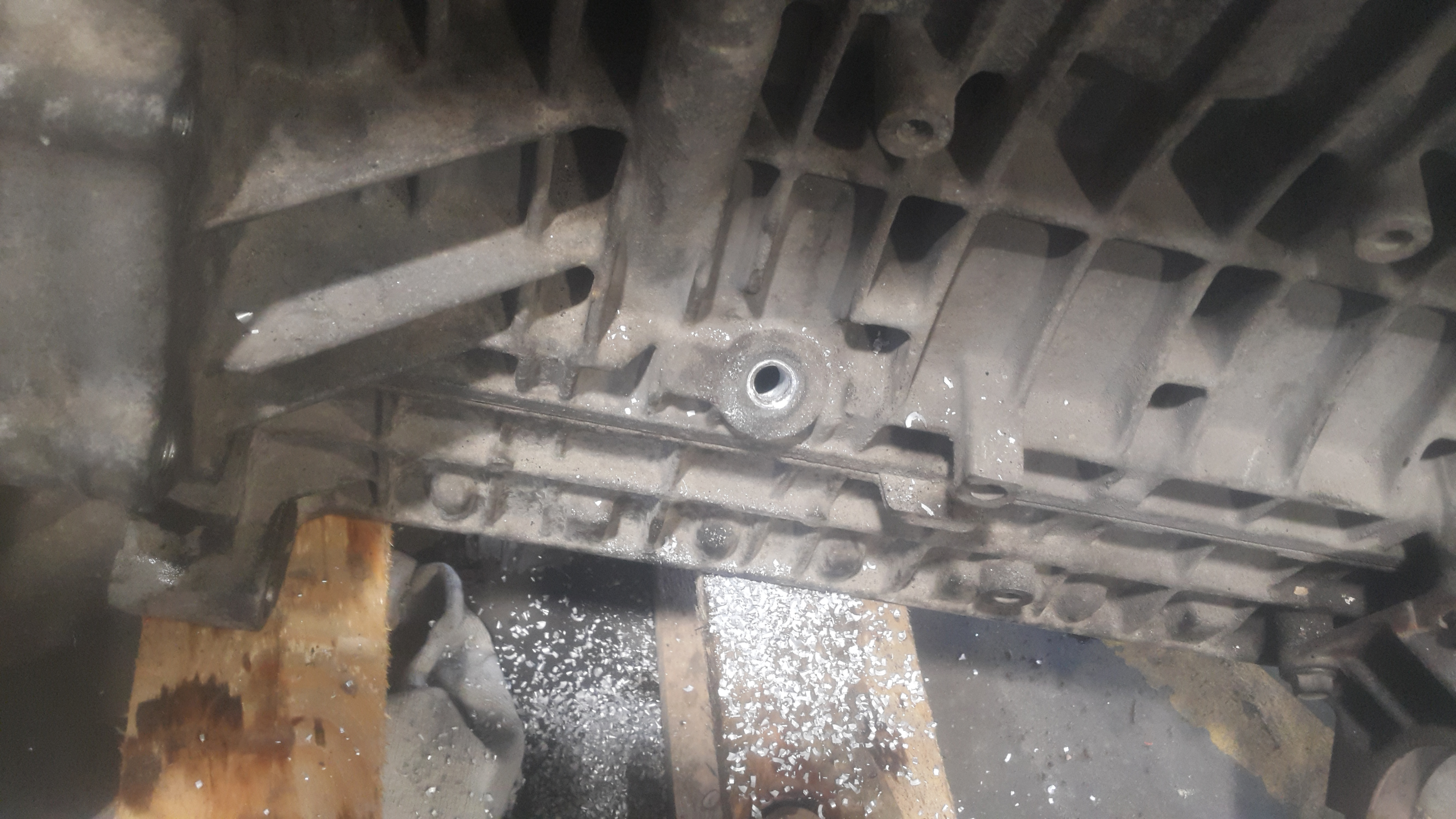

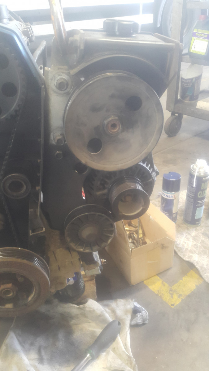

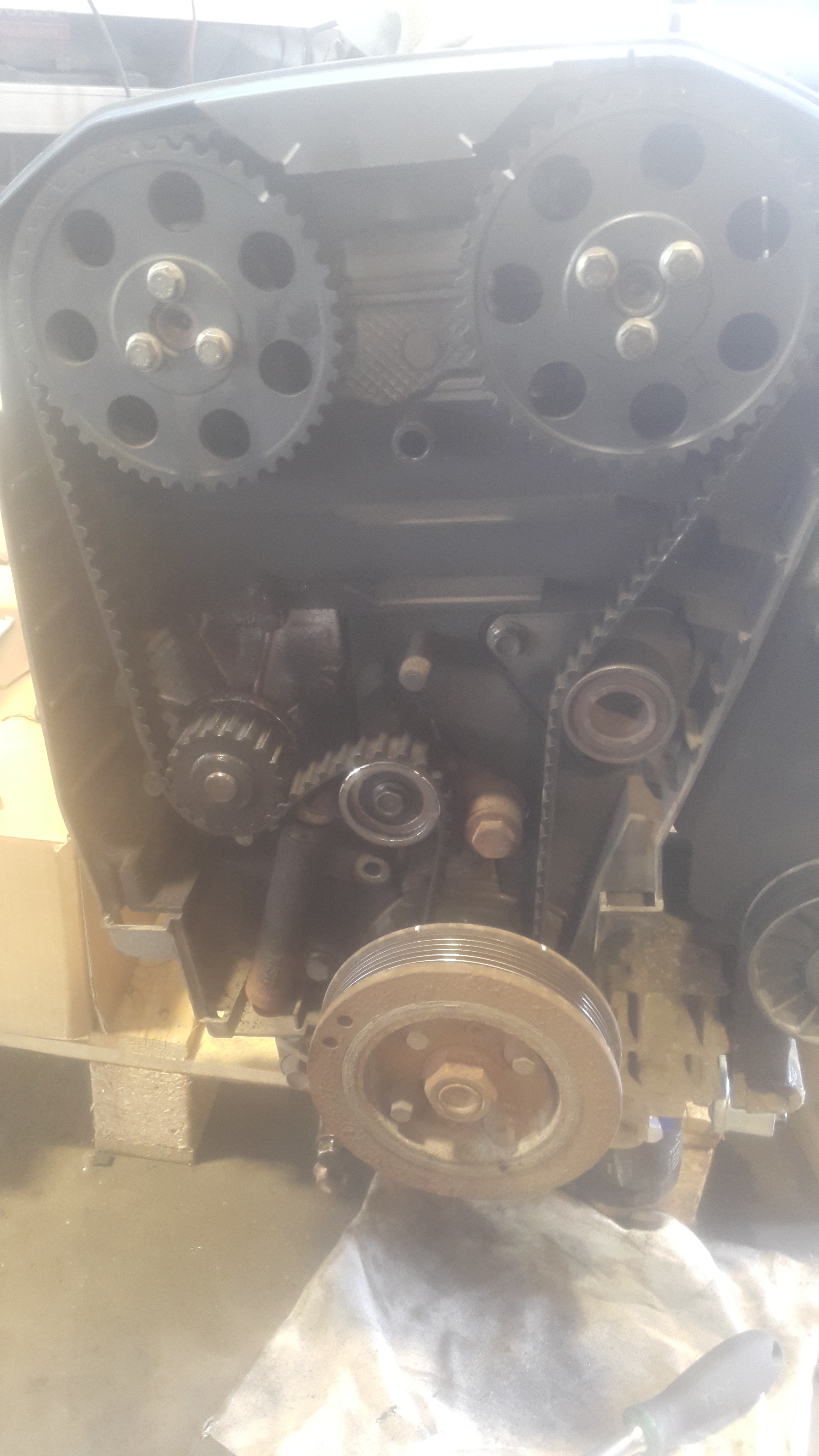

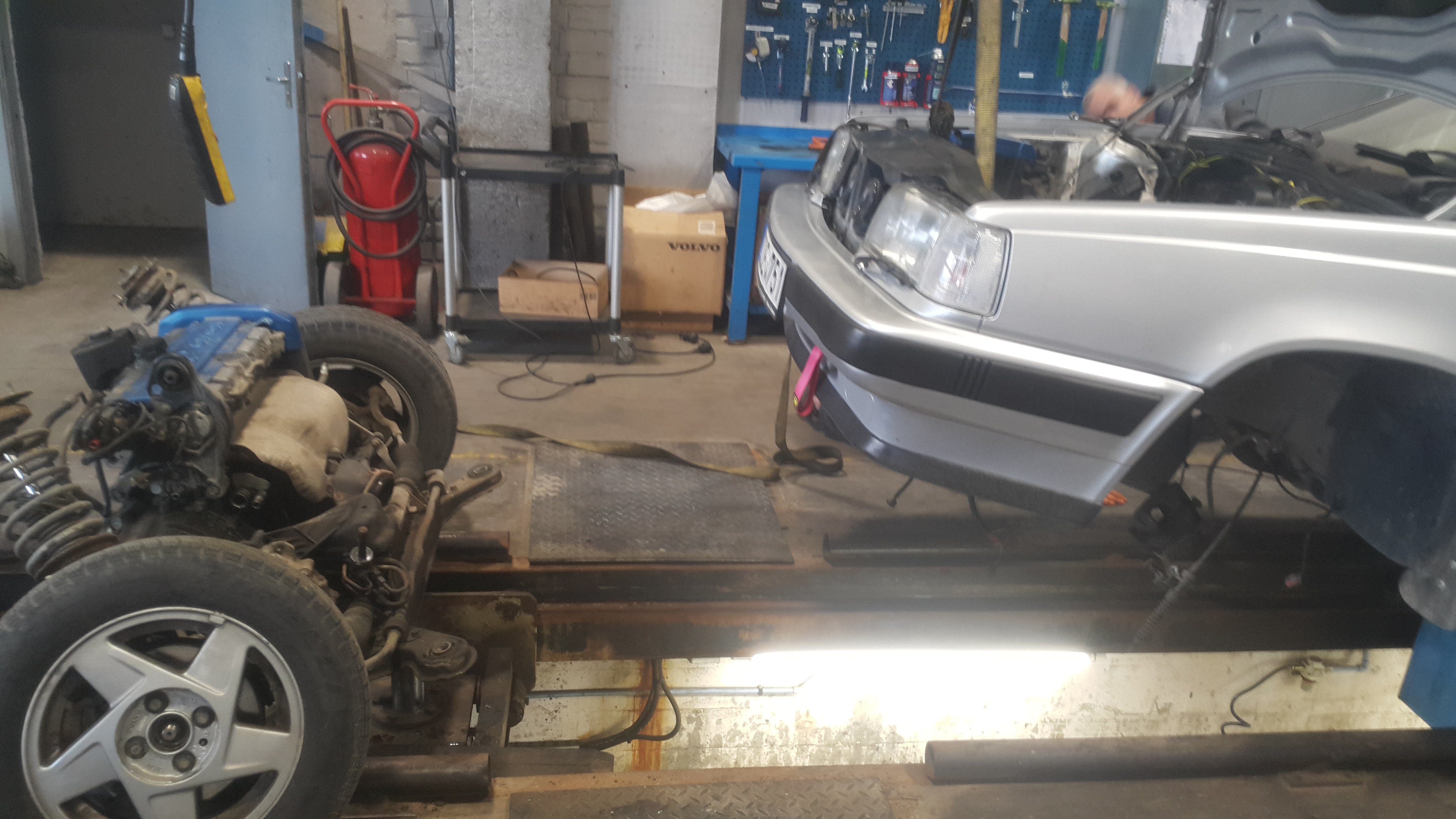

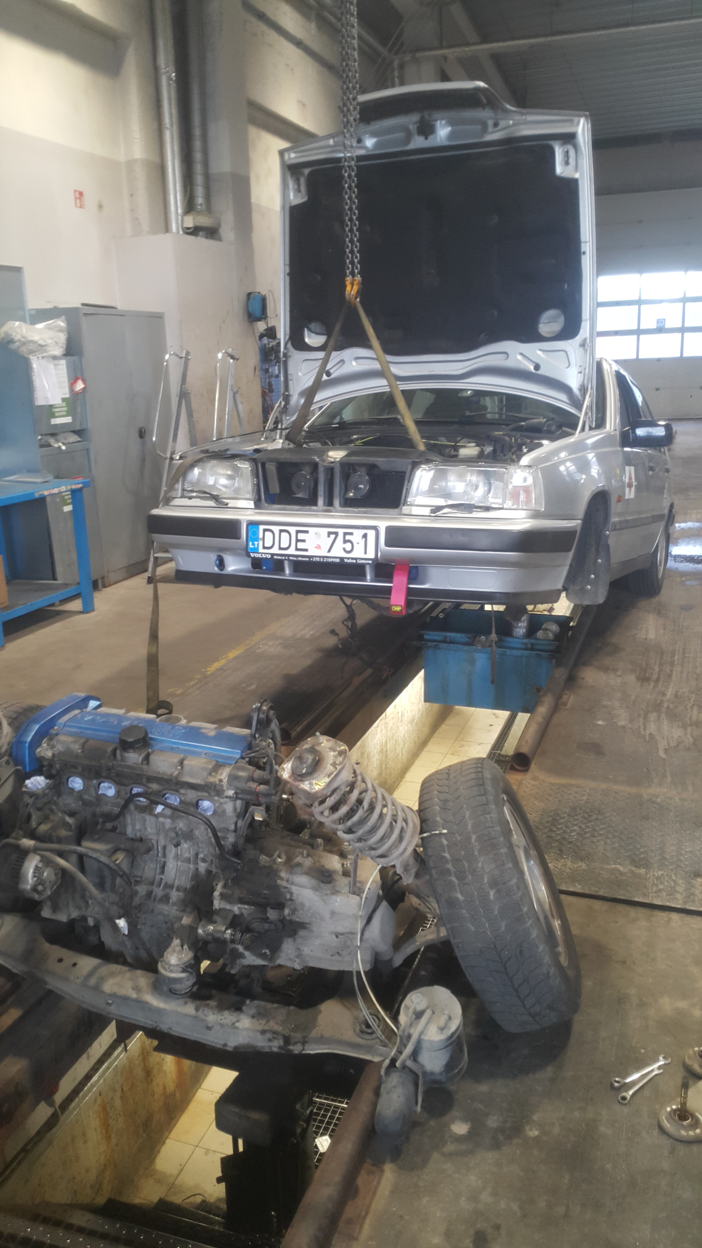

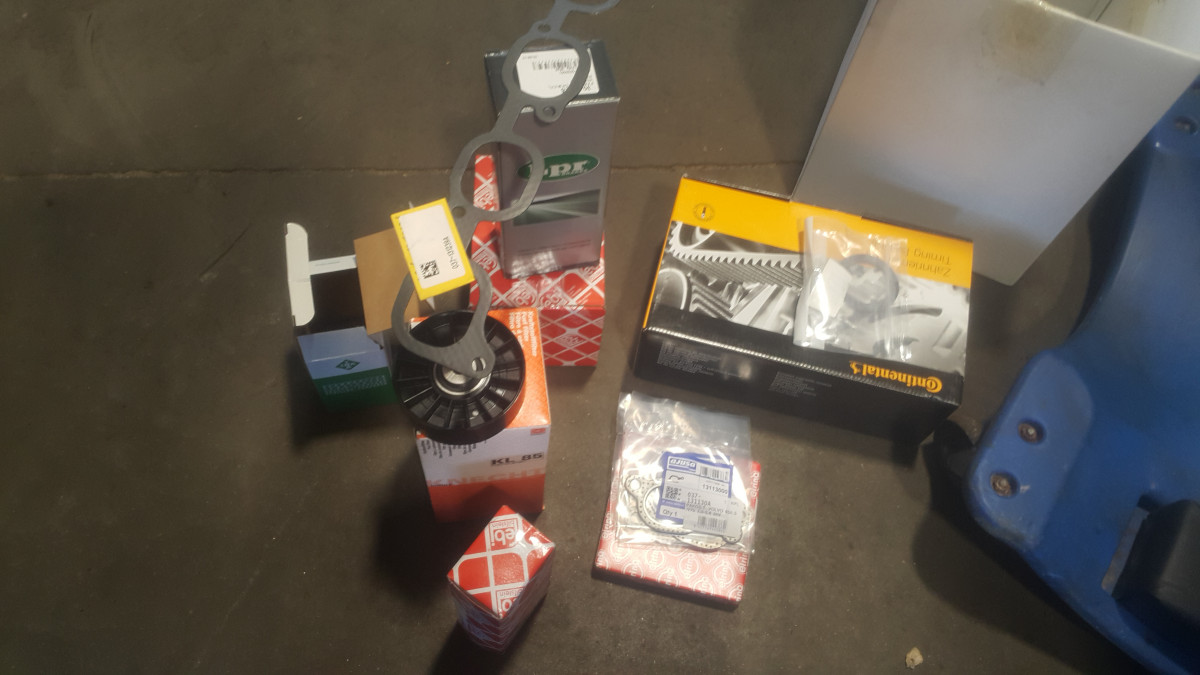

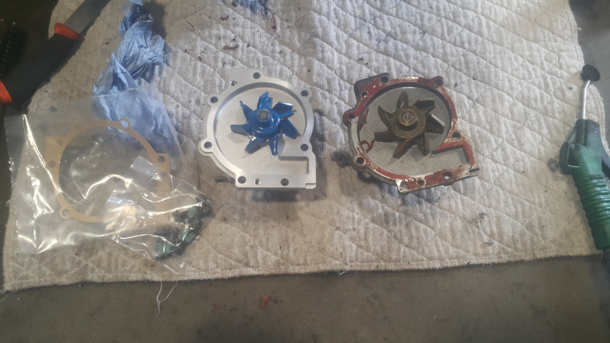

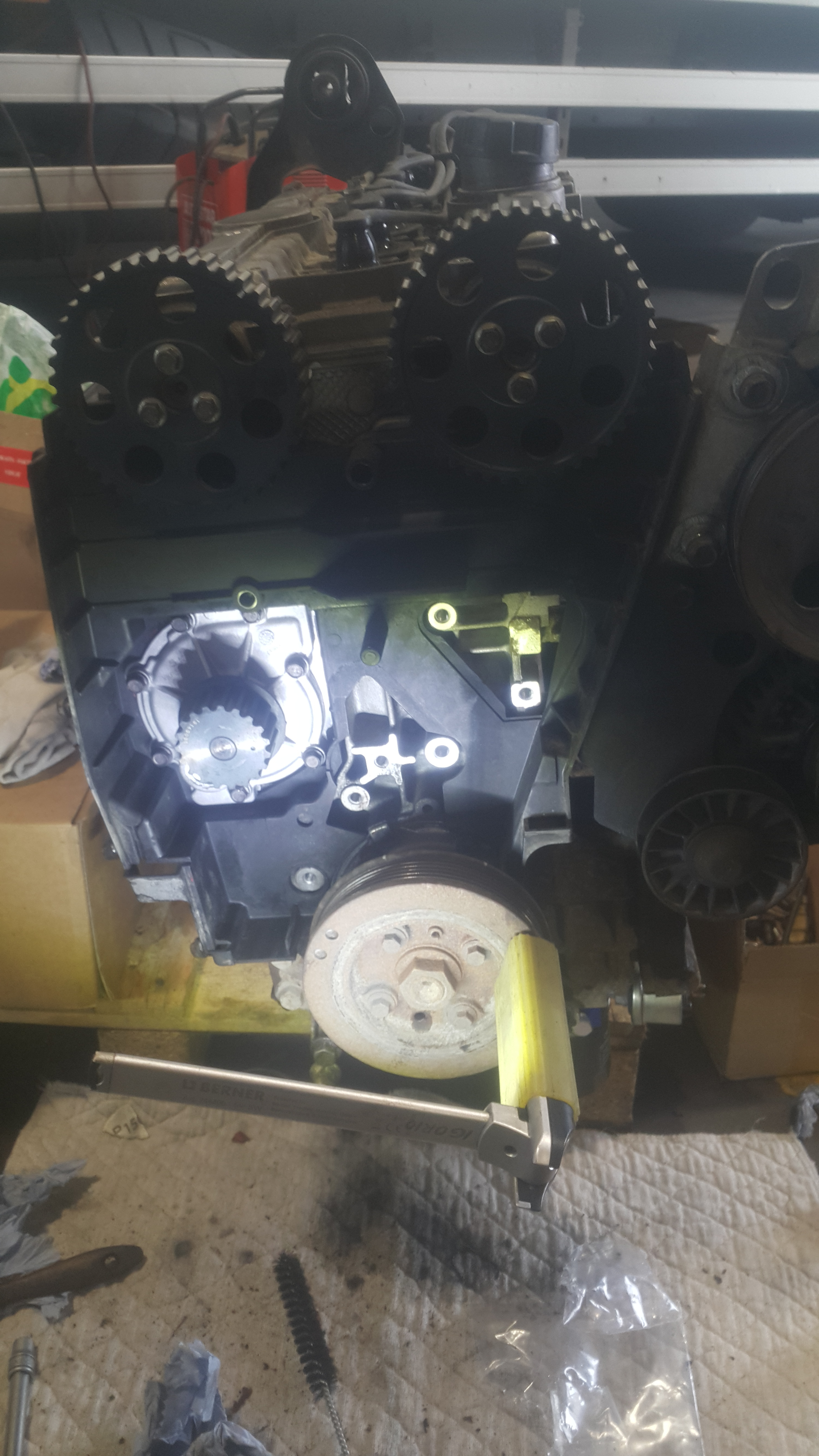

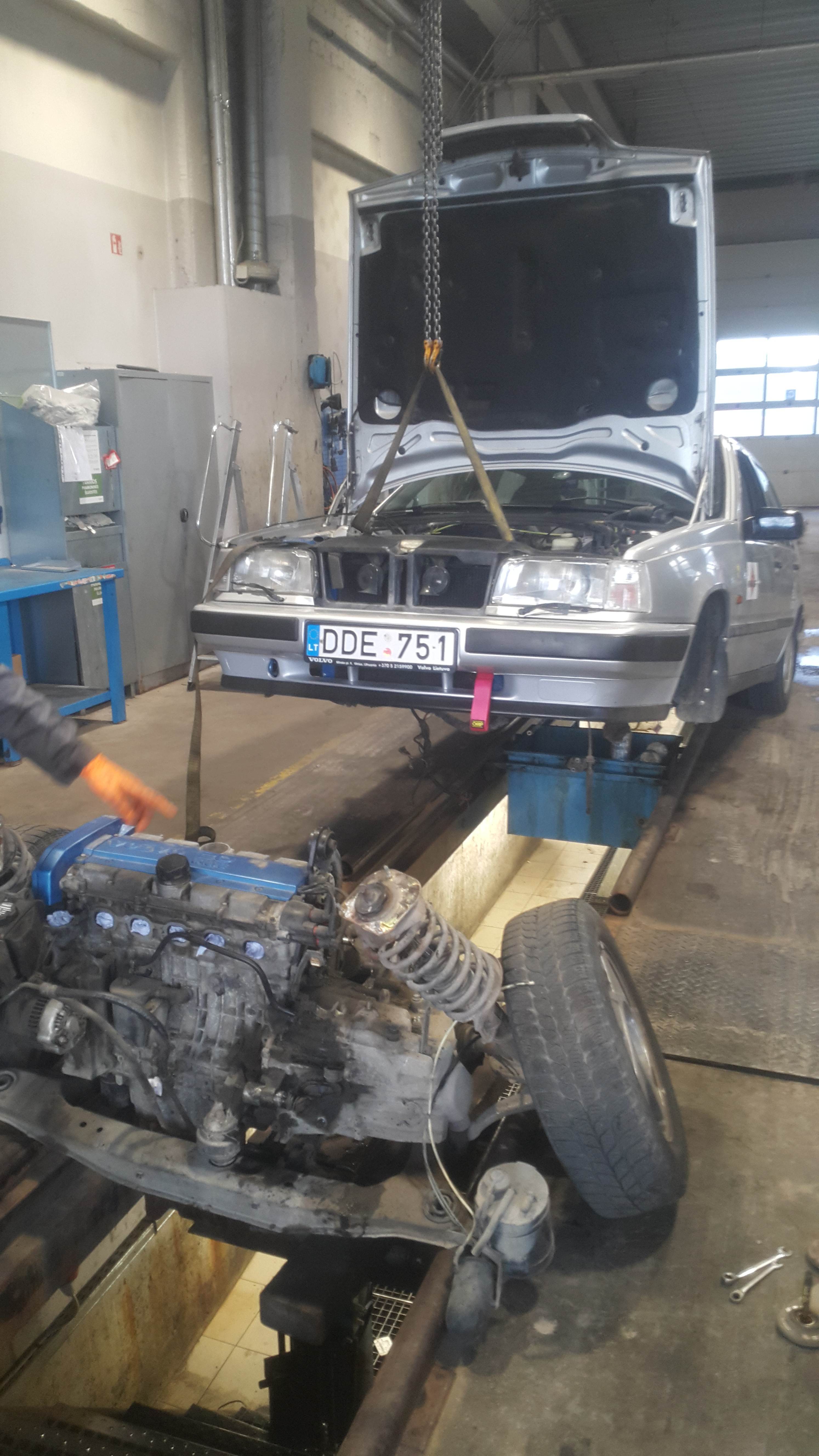

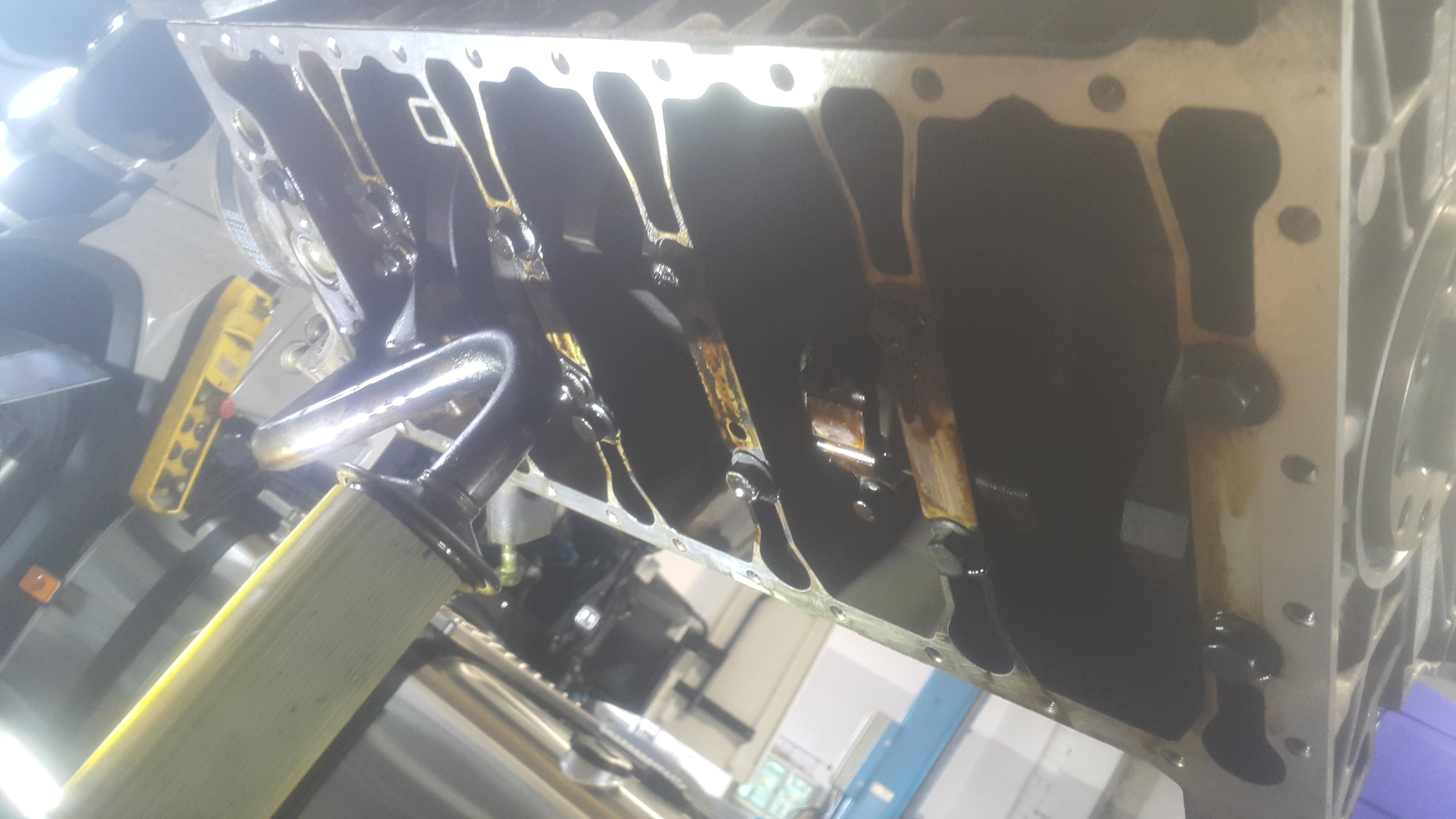

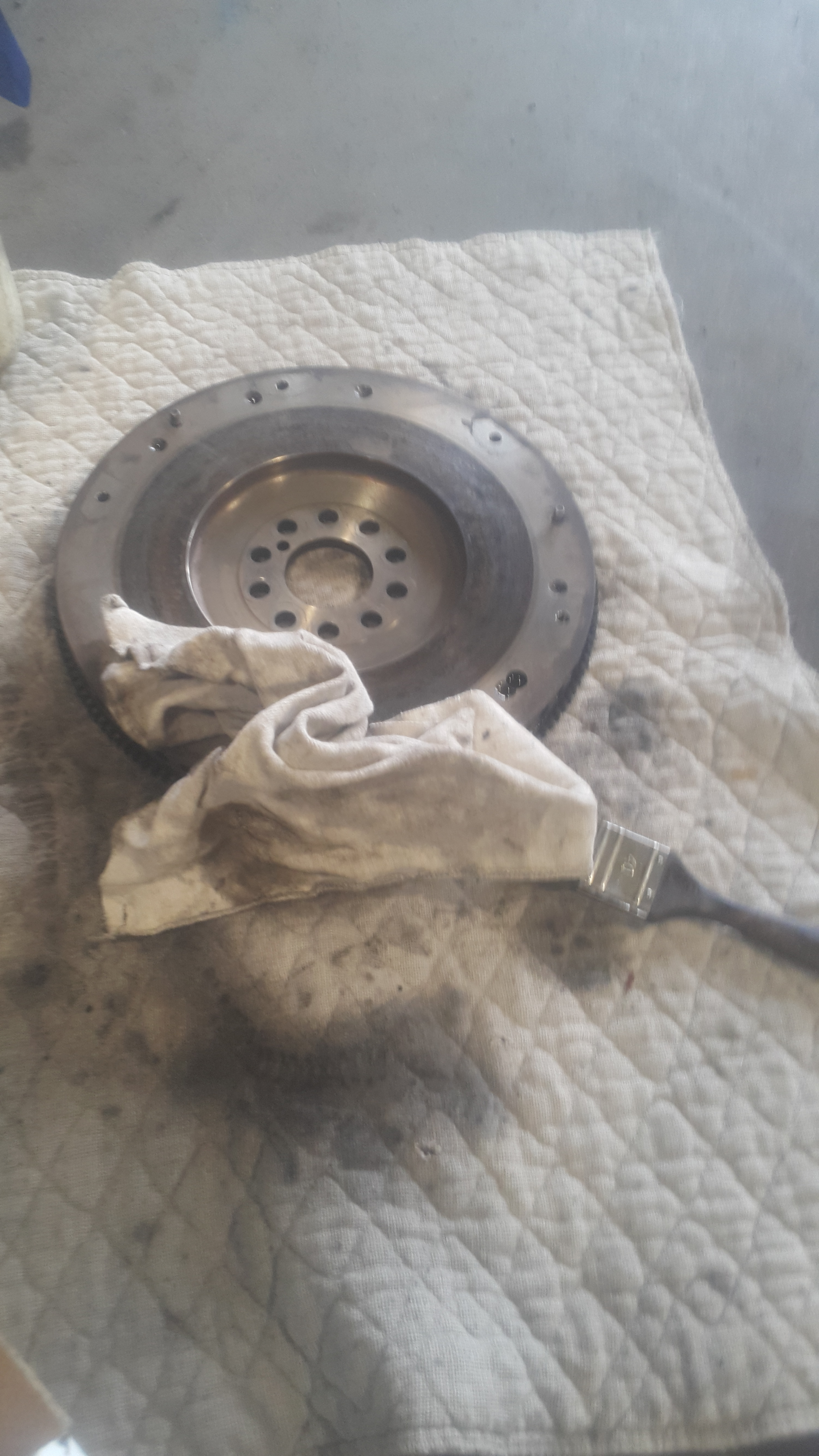

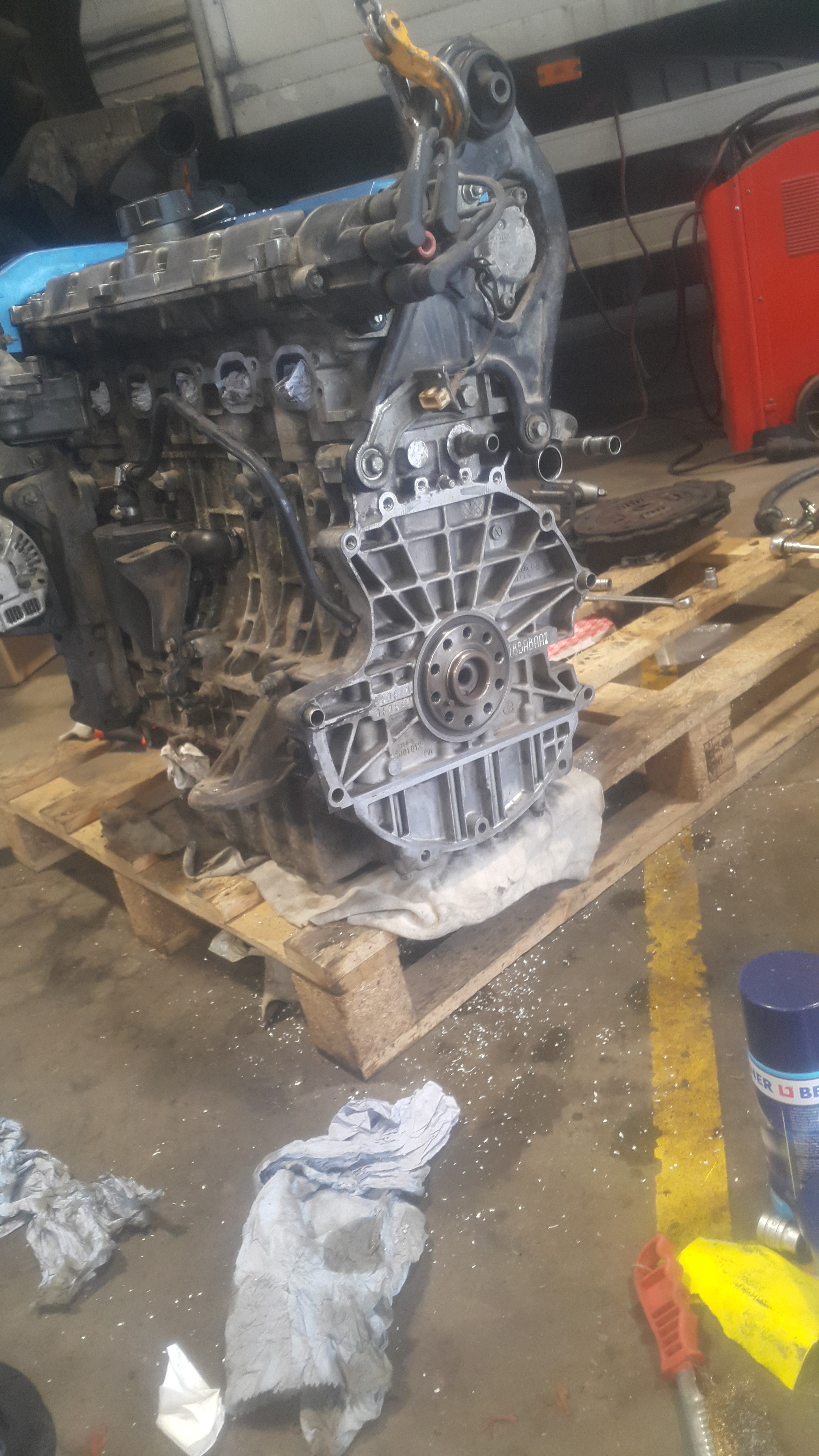

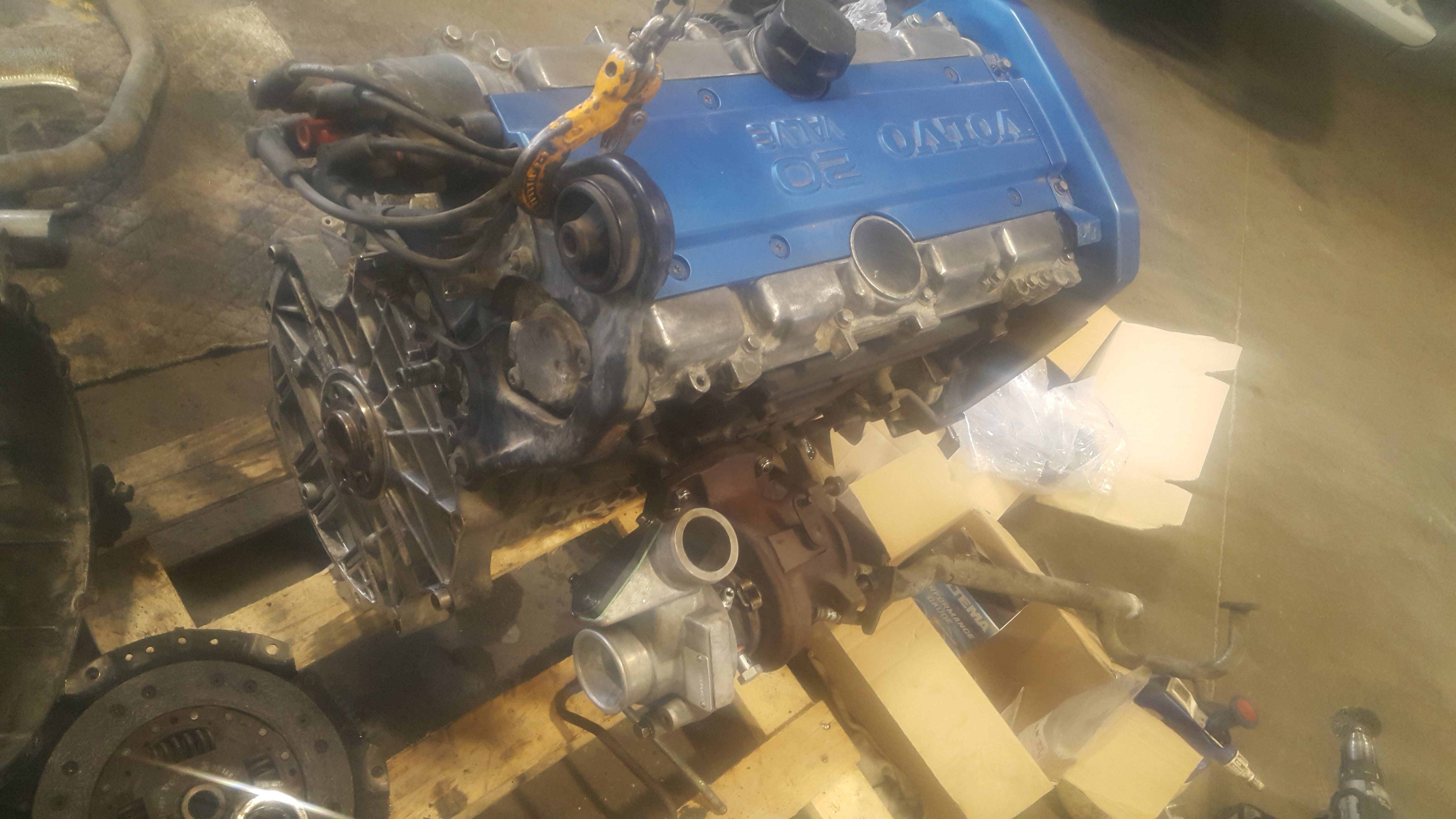

Here is some pictures of my turbo na build engine had to be removed because rear main seal was bad.

Post by bmdubya1198 »
Cool! Looks like you're doing a turbo swap the right way! I'll have to check out your Youtube channel when I get a few minutes!

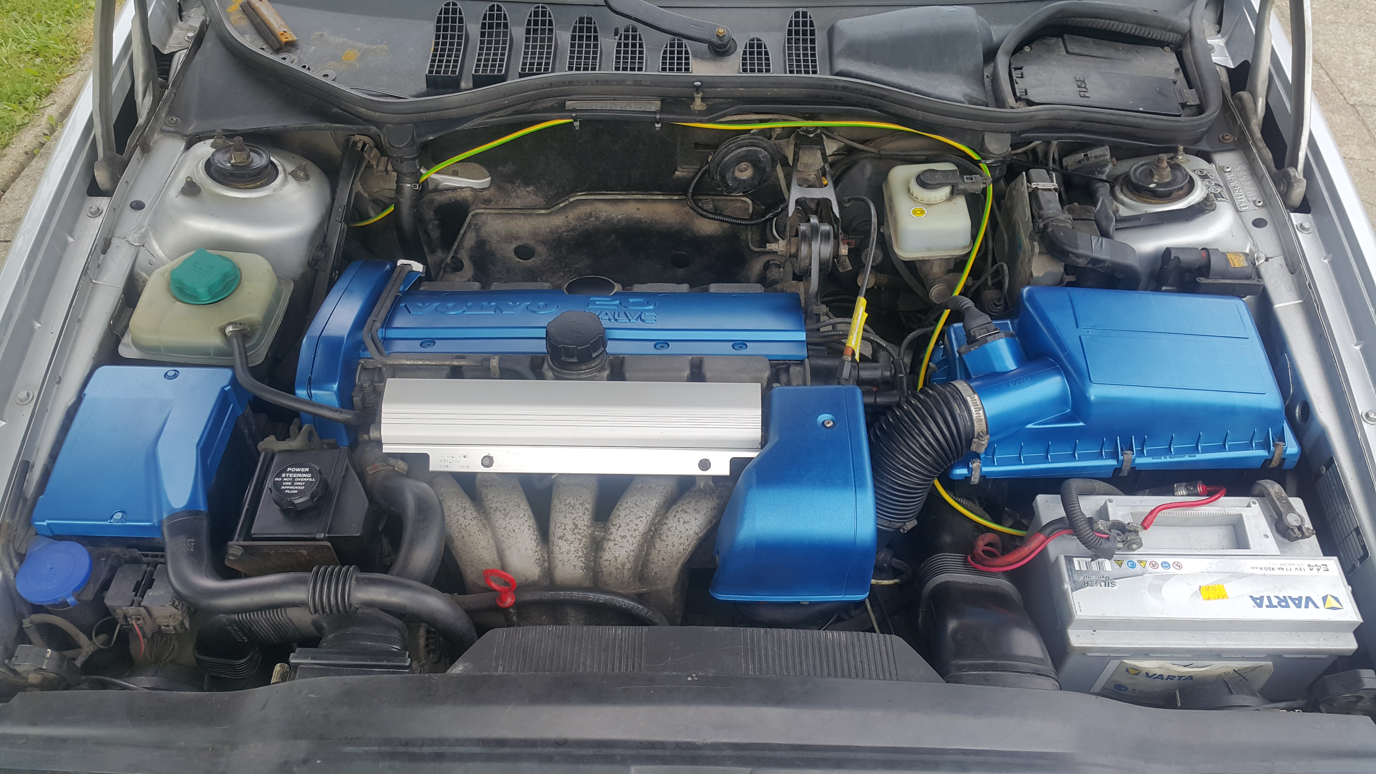

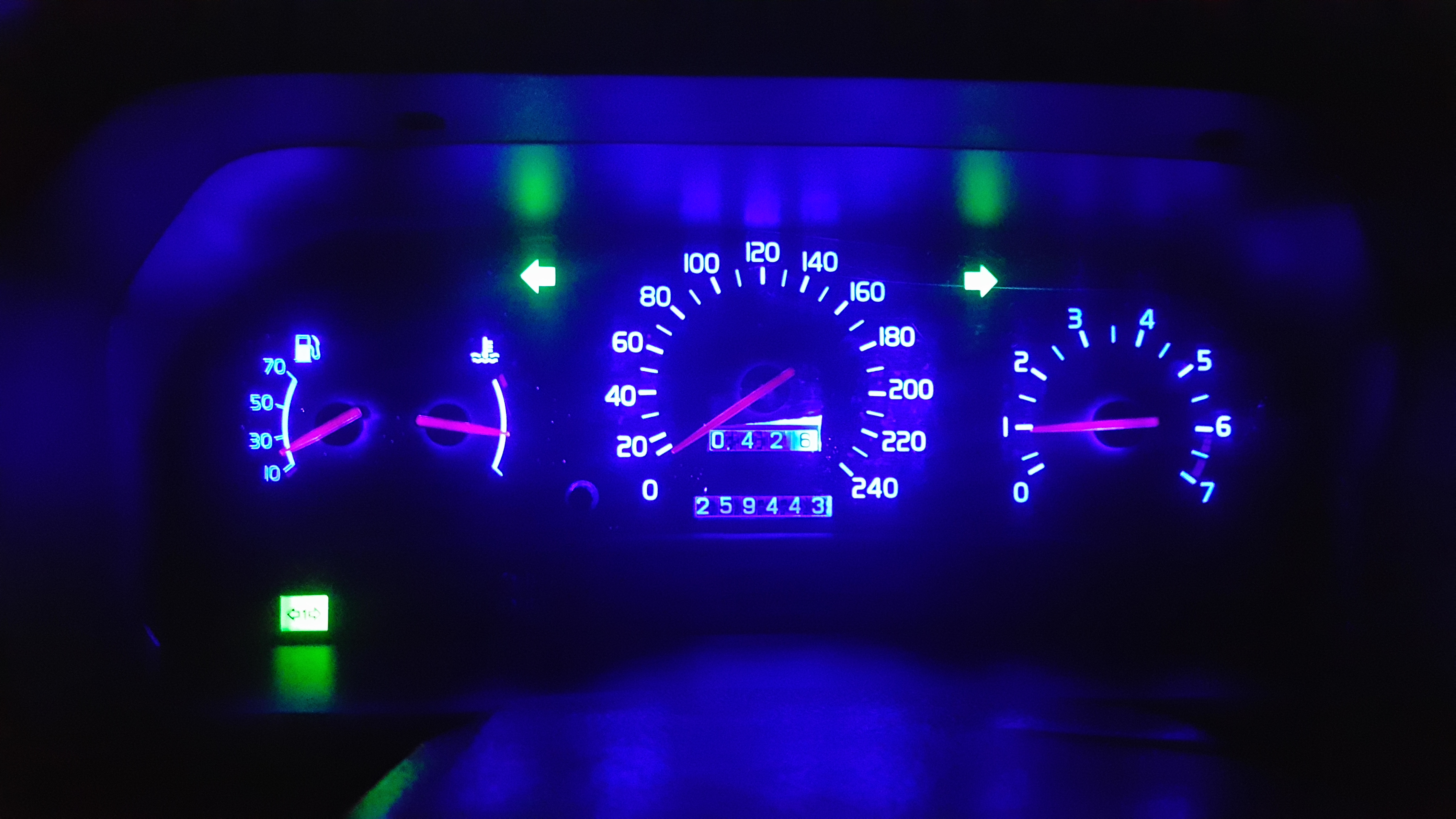

I like the dash mod, I would want red personally, did you just replace the bulbs?

I replased original bulbs with blue led bulbs from aliexpress.

how much power are you making? and how much did this all cost? curious because i wanna know if this was really worth it all
'94 854 NA 287k (bought for $400)
'98 s70 GLT 243k (bought for $250 currently non running)
'96 854R 173K (bought for $900)
'88 245 DL who knows (bought for $600)
erikasambrozas
Posts: 5
Joined: 30 Jul 2019, 14:08
Year and Model: 1993 volvo 850
Location: Lithuania
Been thanked: 1 time
Post by erikasambrozas »
To turbocharge na engine it cost my 350€ other parts that were old and needed to be replaced not included in the price. Im runing 0.3bar of boost car pulls hard compared to stock na engine in few weeks I will dyno my car. In the future I am going to run on megasquirt ecu . If I have to guess engines horsepower I would say its about 200hp.
