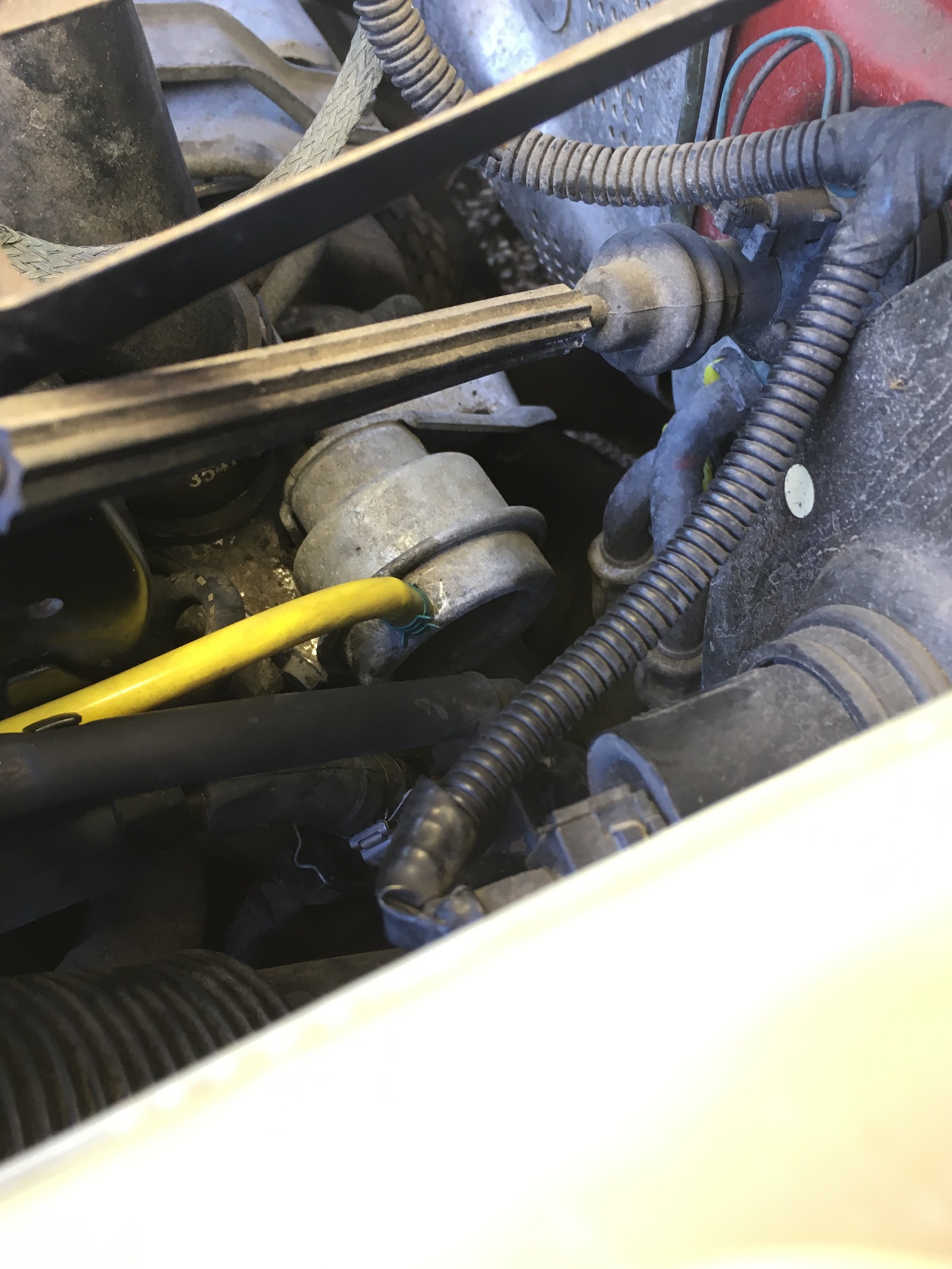

I've had a funny random stumble with my 850T on acceleration, like a cracked boost hose. Sunday I dove into finding a hose leak or intercooler hose problem.

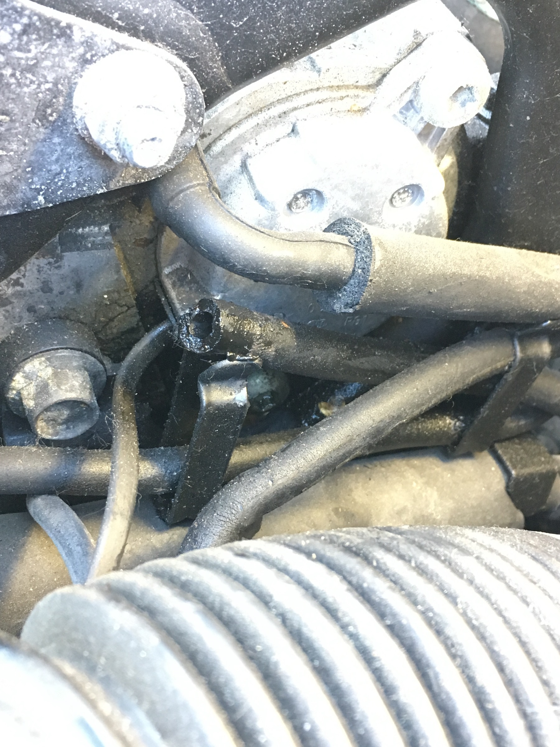

Found one of the vac lines broken in half at the clip on the rear of the head, others seemed pretty dried out.

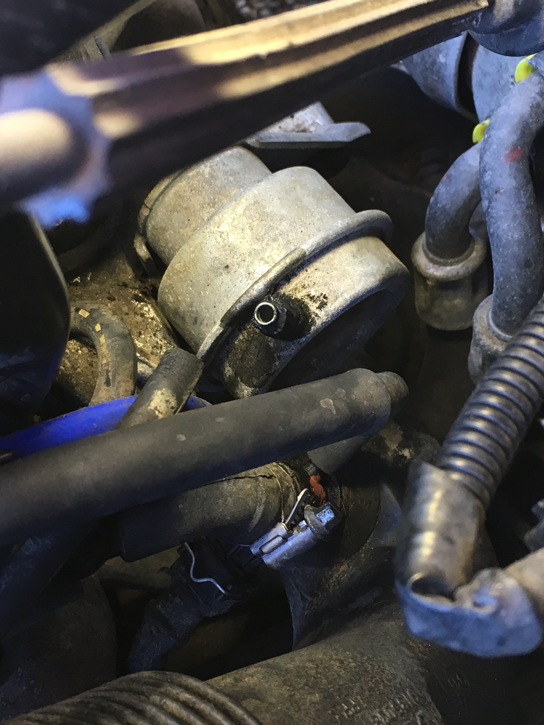

The lower hose (yellow this diagram) goes to the boost control body, the middle (blue here) goes to the intake hose close to the filter box, and the upper (green here) goes to the bottom of the turbo body. (hard to get to that one from under the car).
I checked mine before I took anything apart, and the upper and lower hoses were flipped from this diagram. The parts diagrams I have don't name body #16 where they all connect. Are there ports inside it that route the vacuum from one hose to another, depending on what the switch tells them? Is it just a hollow body and it doesn't matter where the hoses connect?

Old & Busted

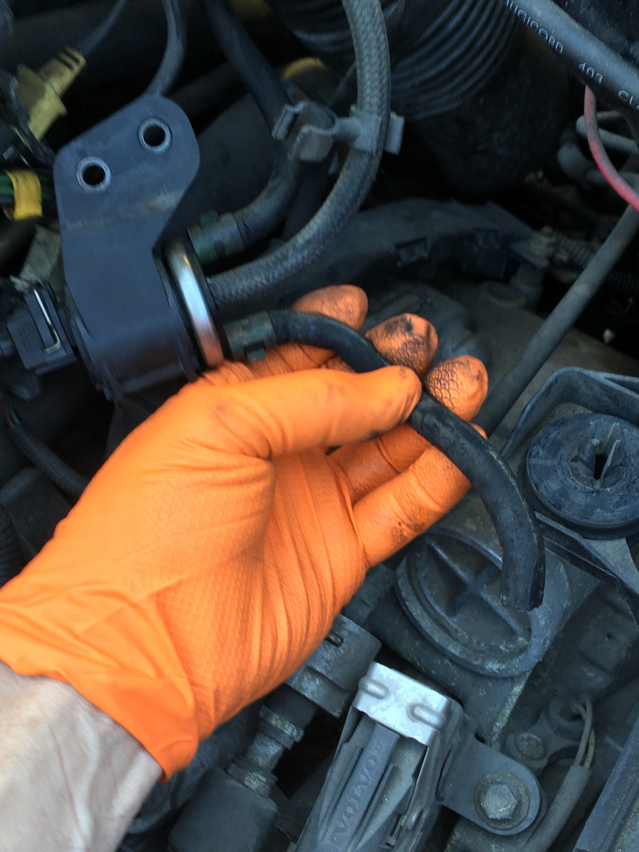

Other end broken off
They were all dry and just snapped off.

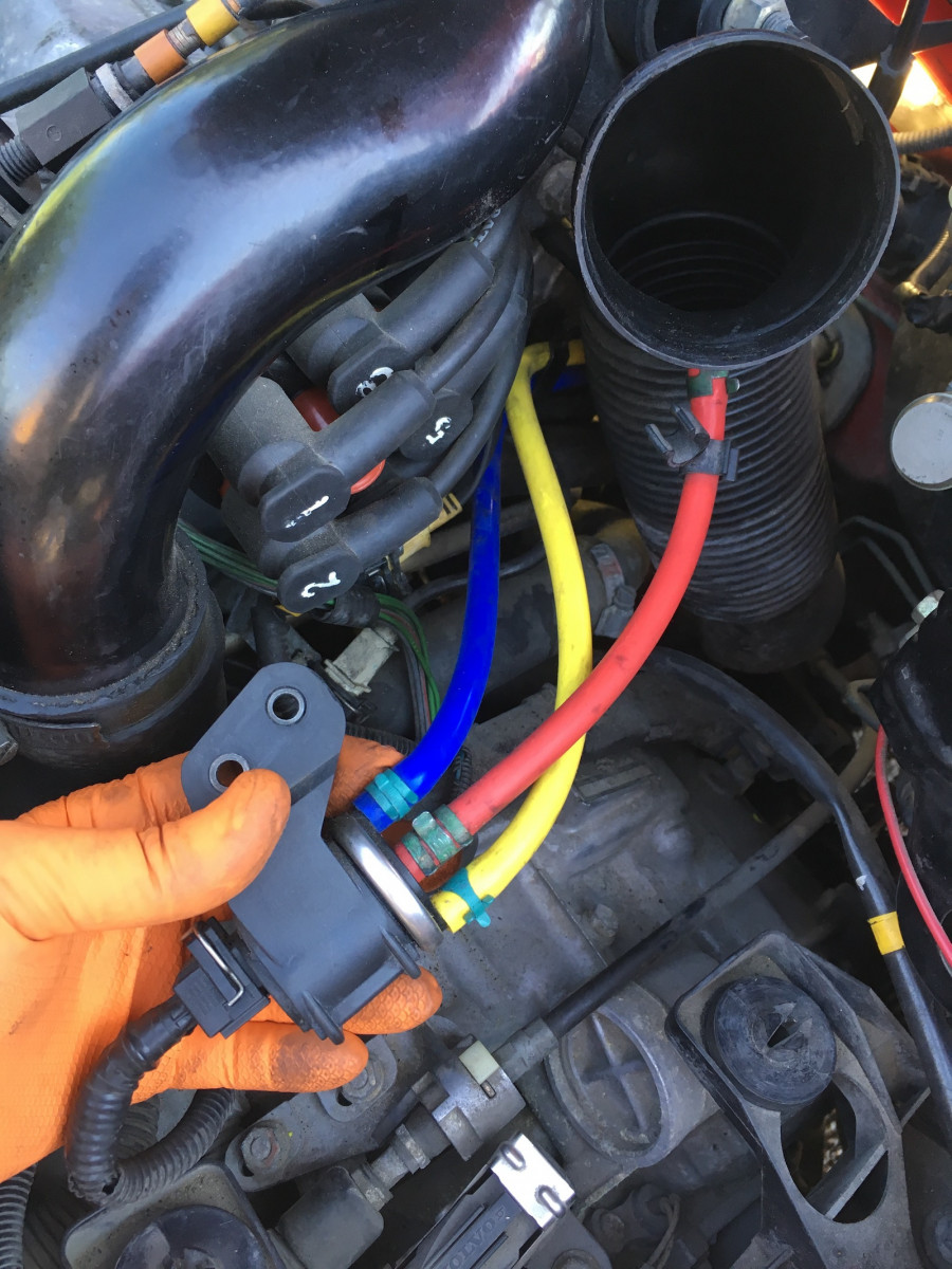

All new. My blue goes to the bottom of the turbo housing. My red goes to the inlet hose. My yellow goes to the boost control body.

You have found the other one of the 6 hose connection permutations that will work as planned.
The turbo control valve connects pressure from the turbo spool to either the waste gate (red) or dump (blue)
If the spool pressure (green) and waste gate lines are switched, the valve is connecting them exactly the same.
the other four combinations of hoses will not work correctly'
