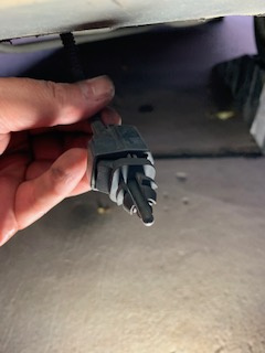

Doing some work on my 02 c70. There are 2 of them. They attach to the plastic windguard (under carriage/bumper). Remove the cover and now not sure how the go back on or what is there purpose.
- 2254B649-F262-4B97-9BD7-4E00E245A4EE.jpeg (28.92 KiB) Viewed 573 times
- 4404CCBF-85E9-4559-B65C-AA32F8879ADA.jpeg (24.17 KiB) Viewed 573 times

Temperature sensors. One is for the display in the car, and I think the other is for the ECU (could be wrong). There should be little holes on each side in the air guide where they clip in.
