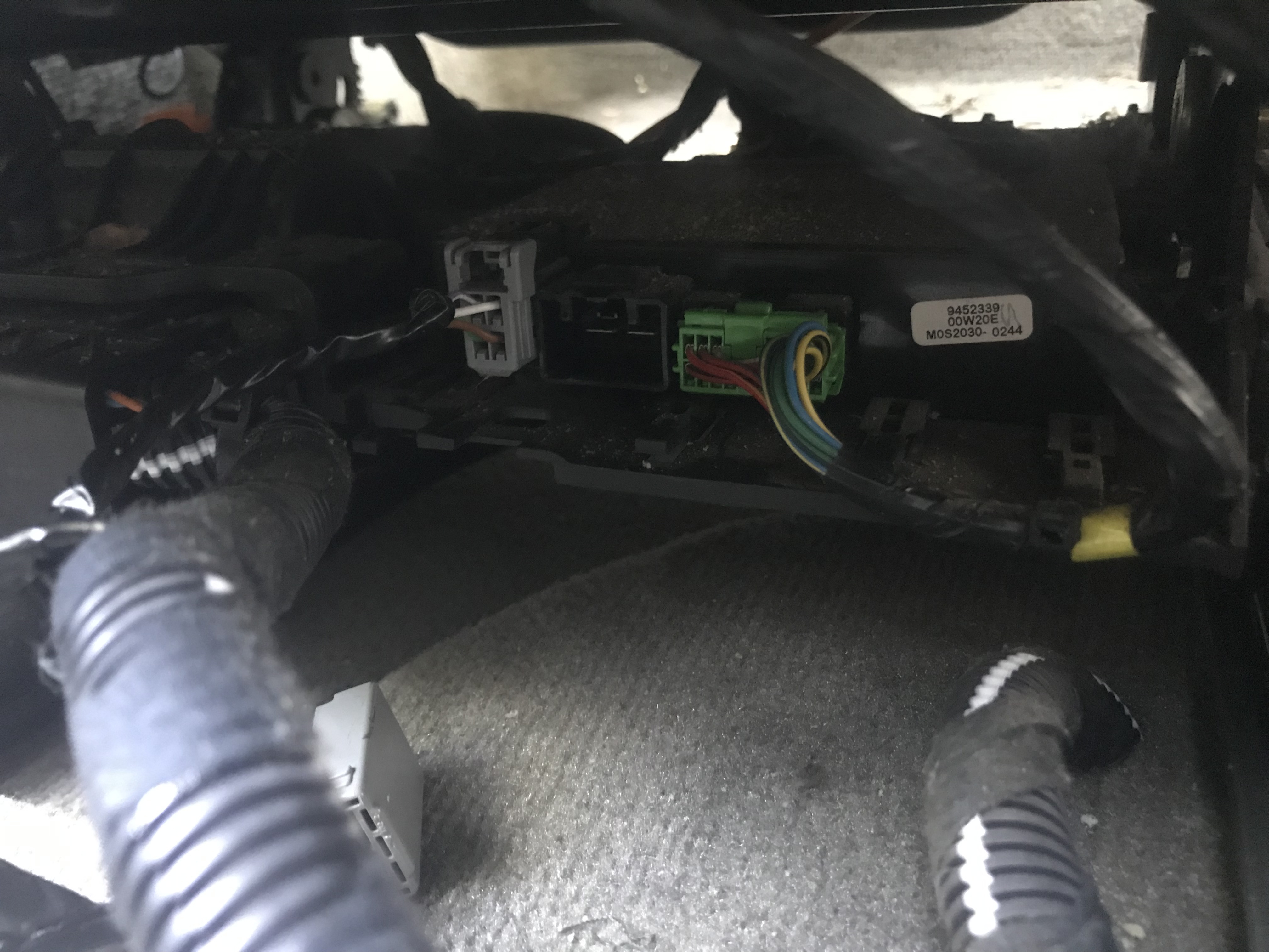

Howdy all. I have the famous SRS light on so I used my scan tool to find it saying, "Front left airbag resistance too high". I'm assuming that's the bag in the seat with the module underneath. I looked under there and everything looked clean and connected. I unplugged the red and black plug and plugged in a little 2 ohm airbag simulator I bought cheap to make sure that module was the problem, and after clearing the code, it came back. Ay ideas?

That isn't the airbag connector. Check that your airbag emulator is still good by cjhecking for 1.8 - 2.5 ohms. Find the orange - amber connector and with ignition for a minute, better if batt is disconnected, plug in a good emulator into harness connector. Now you will need a scan tool with srs capability to clear it. It will not turn off light and message juat by fixing it.
Hey thanks for the reply. It’s not the red and black wired plug in? I guess I don’t know which wires to bypass then. You say it’s the orange and amber wires on that green plug in? And yes I have srs clearing tool. Thanks again

No, it should be an orange connector housing. The box in your picture is only the power seat module, there are some other connectors higher up on edge of front seat cushion. On a 2004 there may a "gang plug" and the orange connector is docked in it. I think the harness in foreground of this photo running diagonal is the harness to the seat
