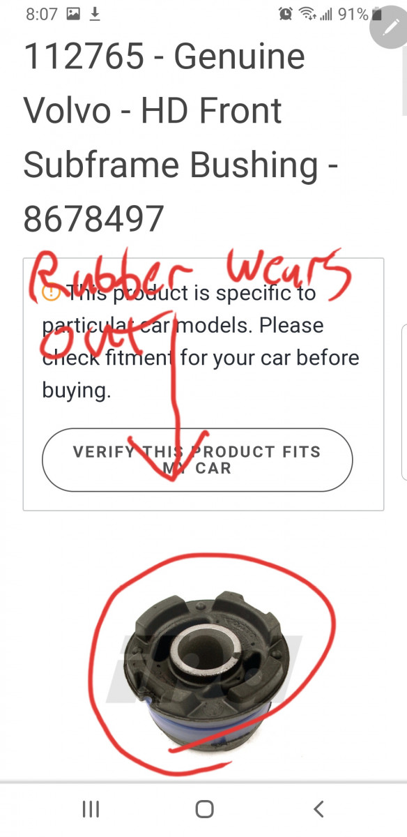

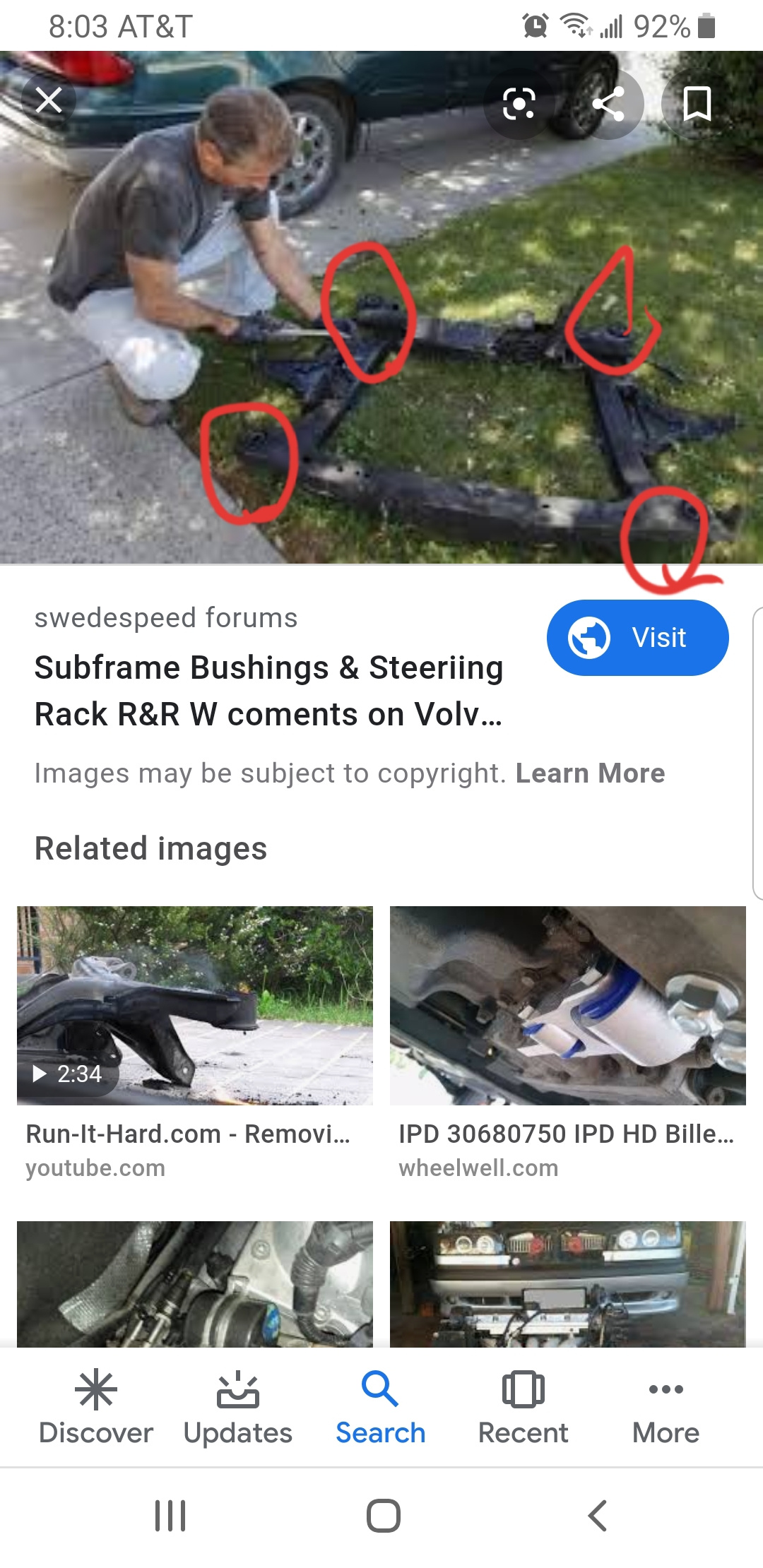

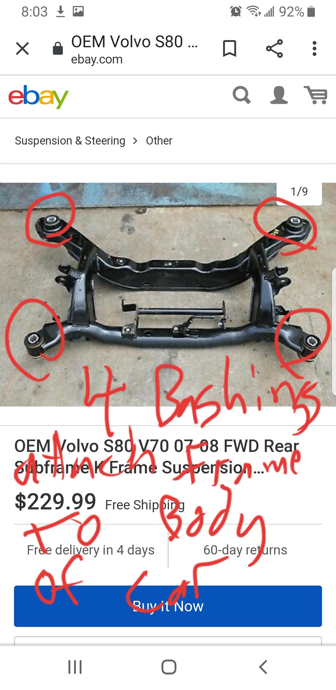

Here are photos of the subframe and a genuine Volvo new subframe bushing. The subframe is where the lower engine mounts attach the engine/ transmission and suspension to the body of the car. The rubber bushings wear out and make a popping sound with the engine torque. Also when they get really bad the car will pull one way than the other going down the road. JuneKidsV70 wrote: 22 Aug 2019, 17:30Interesting, June. Can you explain more about what you mean by subframe bushings, though?June wrote: 21 Aug 2019, 20:31 My 2004 P2 it was the subframe bushings. Absolutely drove me crazy enough to replace every suspension part to no avail. Then the rear main seal sprung a leak and I insisted the subframe bushings were to be replaced since the frame was on the ground. To my surprise it cured the problem. So if everything else checks out consider the bushings. June

Also the bolts are torque to yield one time use only. So new bolts must be installed. June
