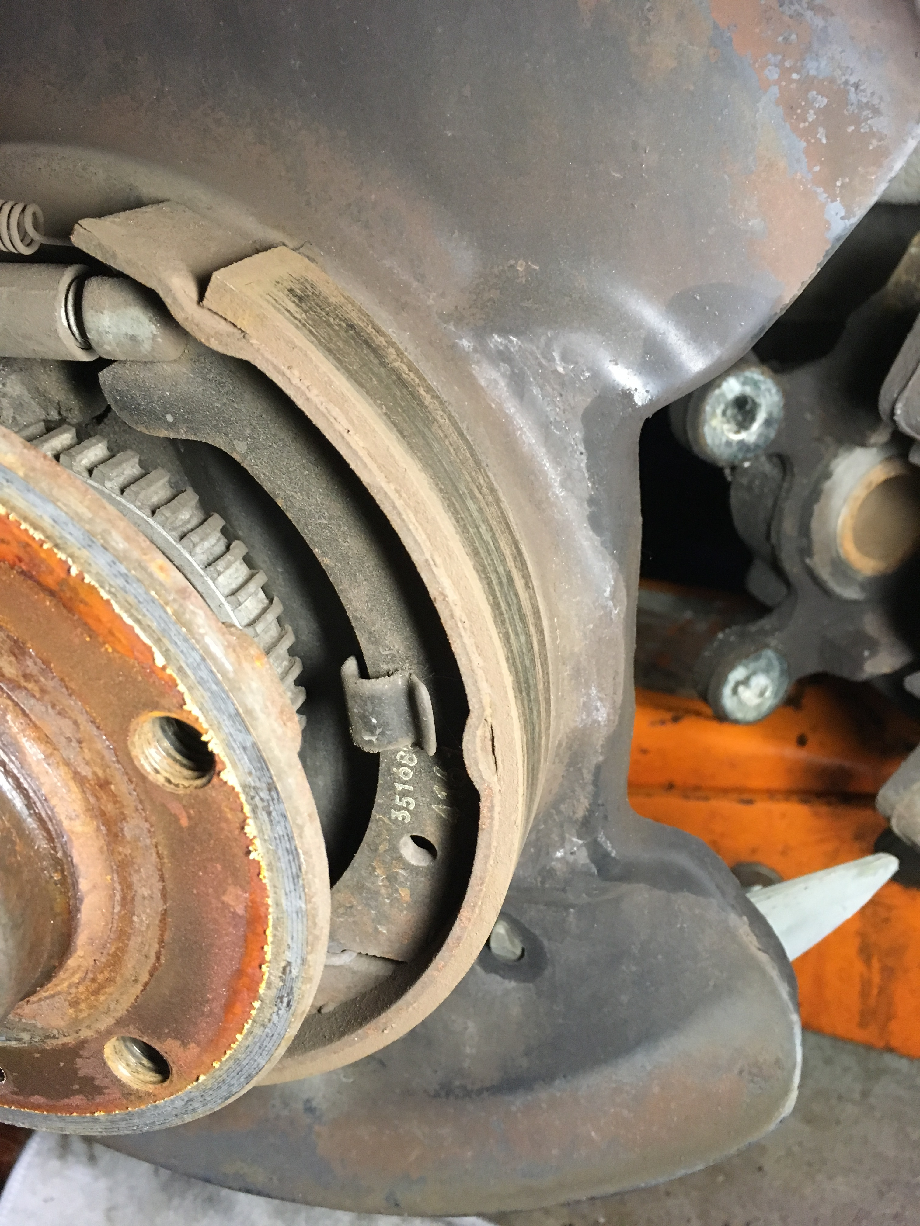

OK, the scraping is there without the pads and caliper. There's also a single wear area inside the drum part of the rotor.

I loosened the parking brake adjuster all the way, the handle has no tension at all on it, pulls straight up. Put the rotor back on and it's still scraping on rotation. One spot per rotation. There's at least a 1/4" of parking brake pad left, they don't seem worn out. Are the springs not pulling the shoes away from the drum surface?

You are either rubbing the backing plate or the shoes are slightly out of arc with the drum.
Put the shoes back on and just them to locked up, then back up 3 clicks. Now set brake cable tension to full brakec5vlever clicks up.

Yep, I looked at all the parts I could throw at it - shoes are fine, springs are fine, clips are fine, adjuster is fine, wheel bearings no play. So, I just took everything apart, cleaned it all, and reassembled the parking brake. Adjuster full loose, tighten 'til rotor is locked, back off 4 or 5 'til no binding per the book...should be good. Did the right side as well, rotors back on, and the brake lever comes half way up and both sides are locked correctly! So that seems to be ok now.

Horribly worded, sorry. I meant just drive the car, using the hand brake as you normally would. I actually make a couple of handbrake stops then gone back and adjust them again when new shoes go on. You are trying to make sure the shoes radius matches the drum radiusabscate wrote: 24 Aug 2019, 15:50 You are either rubbing the backing plate or the shoes are slightly out of arc with the drum.
Put the shoes back on and just them to locked up, then back up 3 clicks. Now set brake cable tension to full tension on brake lever 5 clicks up.

Volvo has a bedding in/cleaning process recommendation for parking breaks involving driving for a short distance with the parking brake engaged. Can't recall the exact details but think it was around 50 meters.
The insides of your drums for the parking brakes look really rusty. If I have a car with drums like that I uses a rotary wire brush on a drill and clean all the rust off first and then rub the faces of the drums with a fine emery paper to roughen the surface a little for better grip.
I am also assuming you checked the parking brake cables are not kinked or broken and move freely. Finally make sure (FWD cars) that the plastic tie back is in place on the parking brake cable to keep it off the back of the rear tires.
