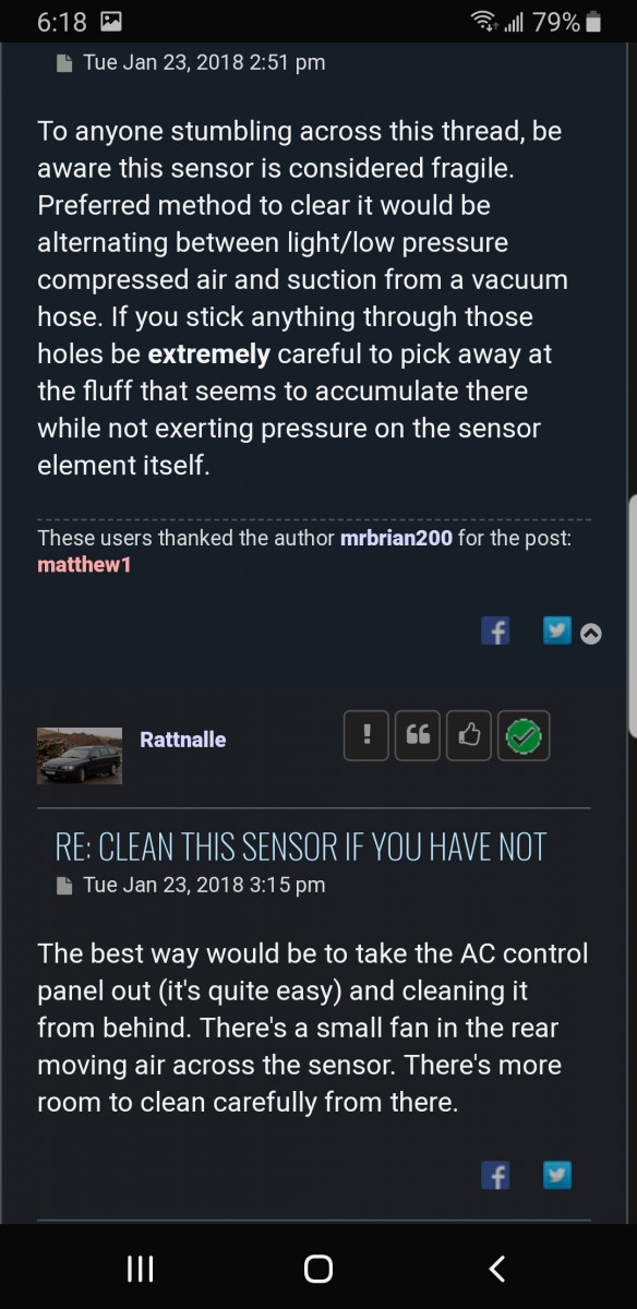

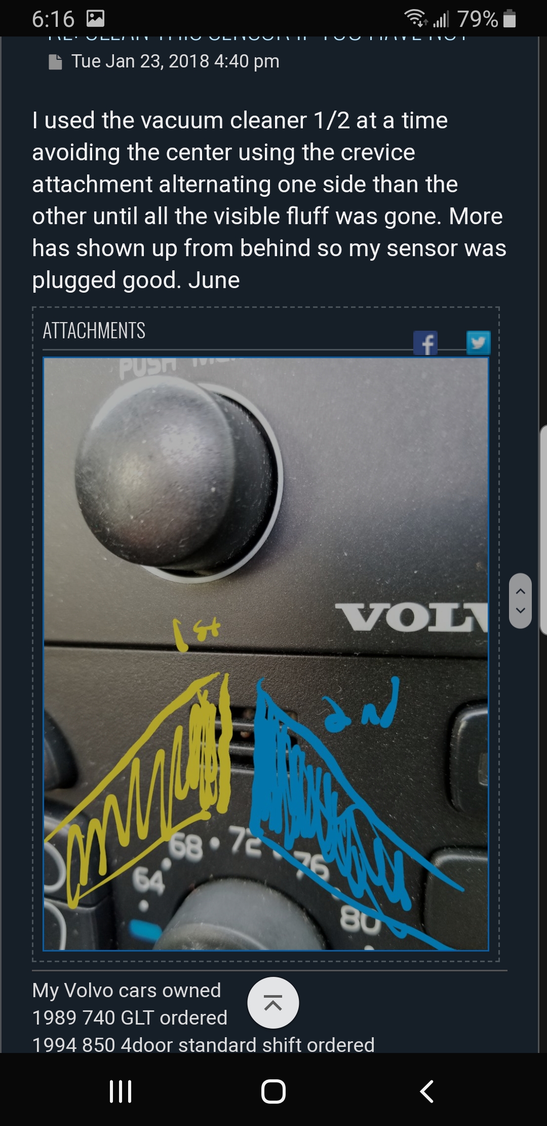

Not dumb, just uninformed. Unfortunately you broke the sensor. For future reference you have to use a vacuum cleaner just a bit at a time. I believe you will have to replace the control panel. June

Here are some screenshots of a previous thread about cleaning the lint out. June
