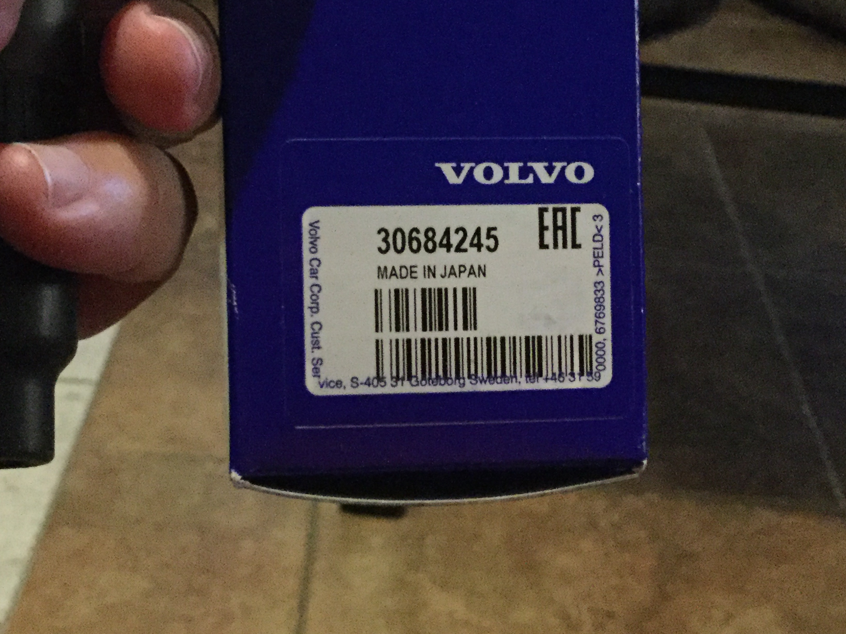

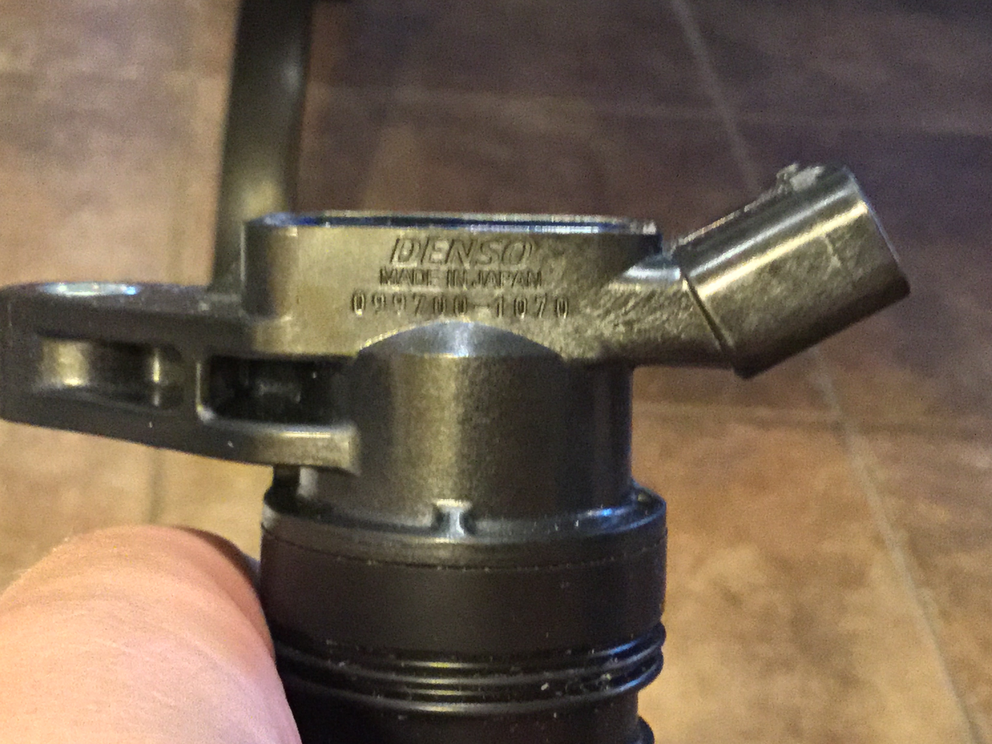

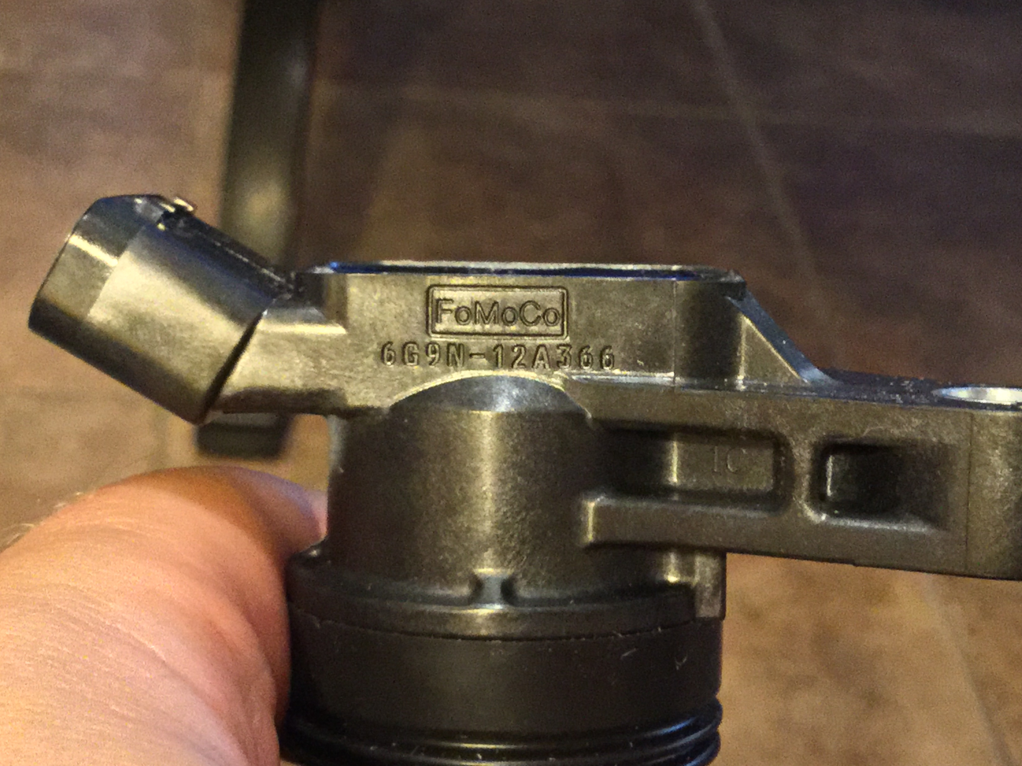

To answer your question: Denso
I did recently buy a coil but it just sits on my shelf.
I own two 3.2s and so far I’ve replaced zero coils
There is evidence that suggests that coil failures are related to a Thermostat failure and/or worn spark plugs
Pictures of the coil pack
Good luck
Paul
