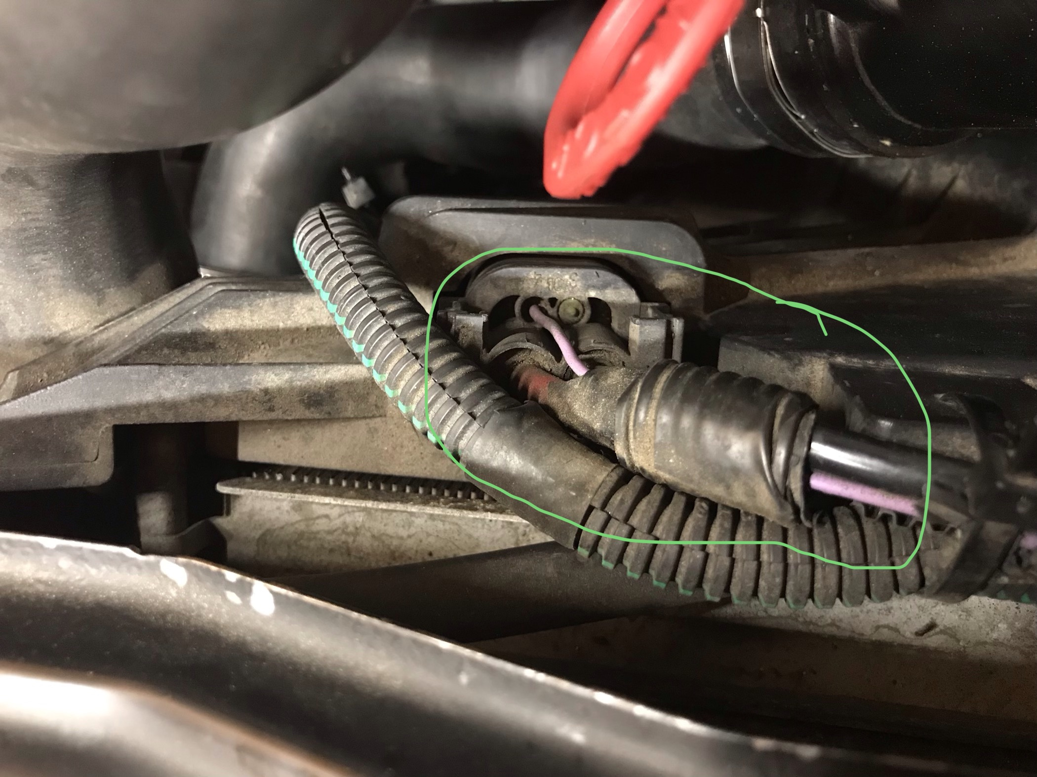

It’s the tiny purple one between the fat black & red wires. Look at yours, it’s the same on all of them. I just circled the area in green on the picture so you know where to look. I’d say probably 10-15k since I soldered in the new section of wire.

I see what you were seeing, that green little nub is just a cap or nipple recessed into the big plug. I’m sure a lot of P2’s & others use the same plug & that port may be used on other vehicles. On these it is not, just the purple wire coming out adjacent to the green nipple/plug. Look up about 1” or so from where the wire comes out of the plug & if you see a small section of green corroding copper type stuff that’s your issue.

I see - you said yours was green, but you meant corroded and green.
I asked him if he would show me the shop report, and I'll look at that wire if he's up for it.
