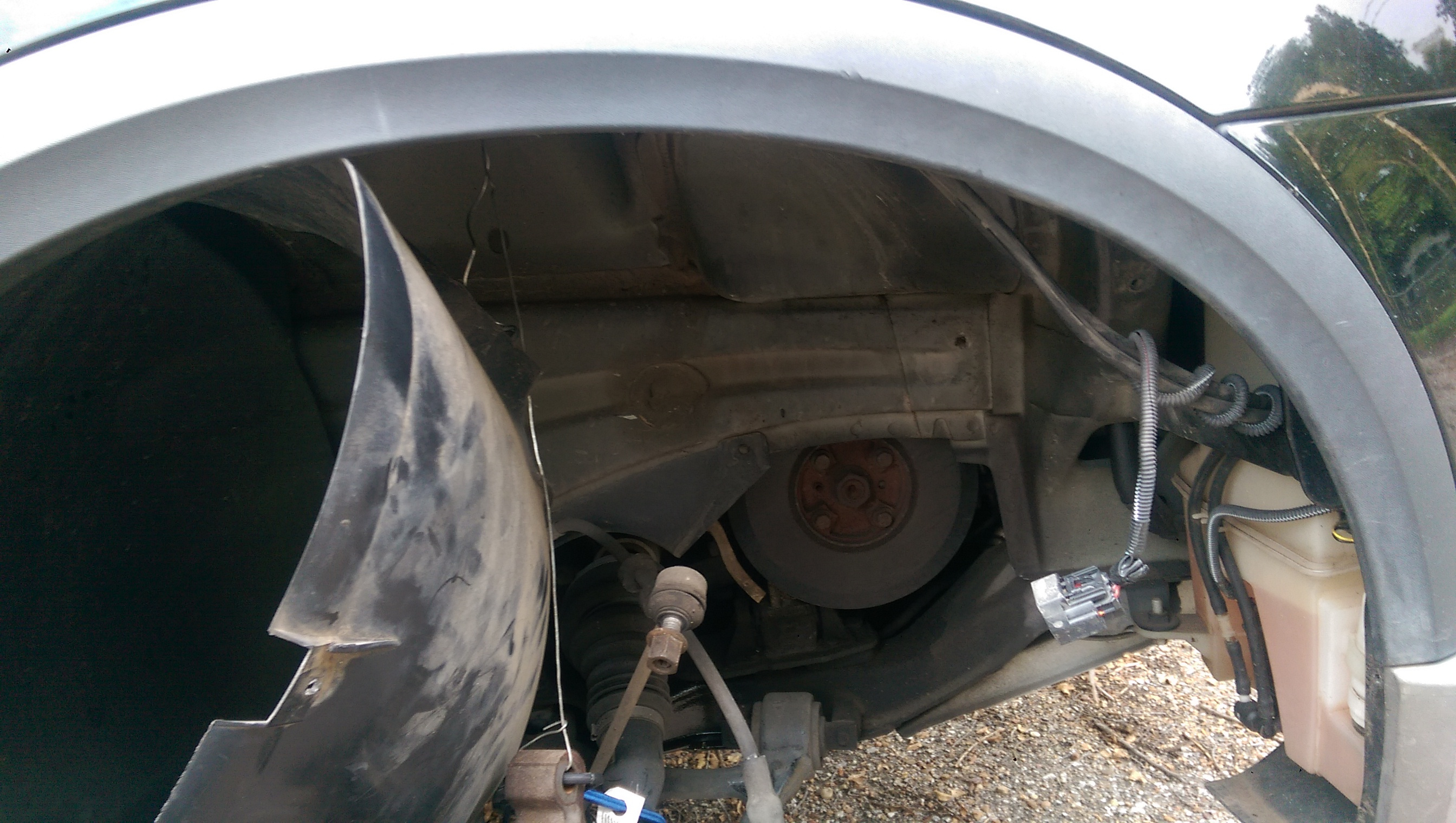

Getting the liner out of the way was not too hard.
1. Removed the fasteners on the front edge.
2. Removed two nuts on the backside.
3 Drilled one rivet on the plastic bracket holding the liner to the molding.
4. Pulled the backside over the bolts then down until front edge slipped past the plastic bracket.
5. folded the liner back and out of the way.

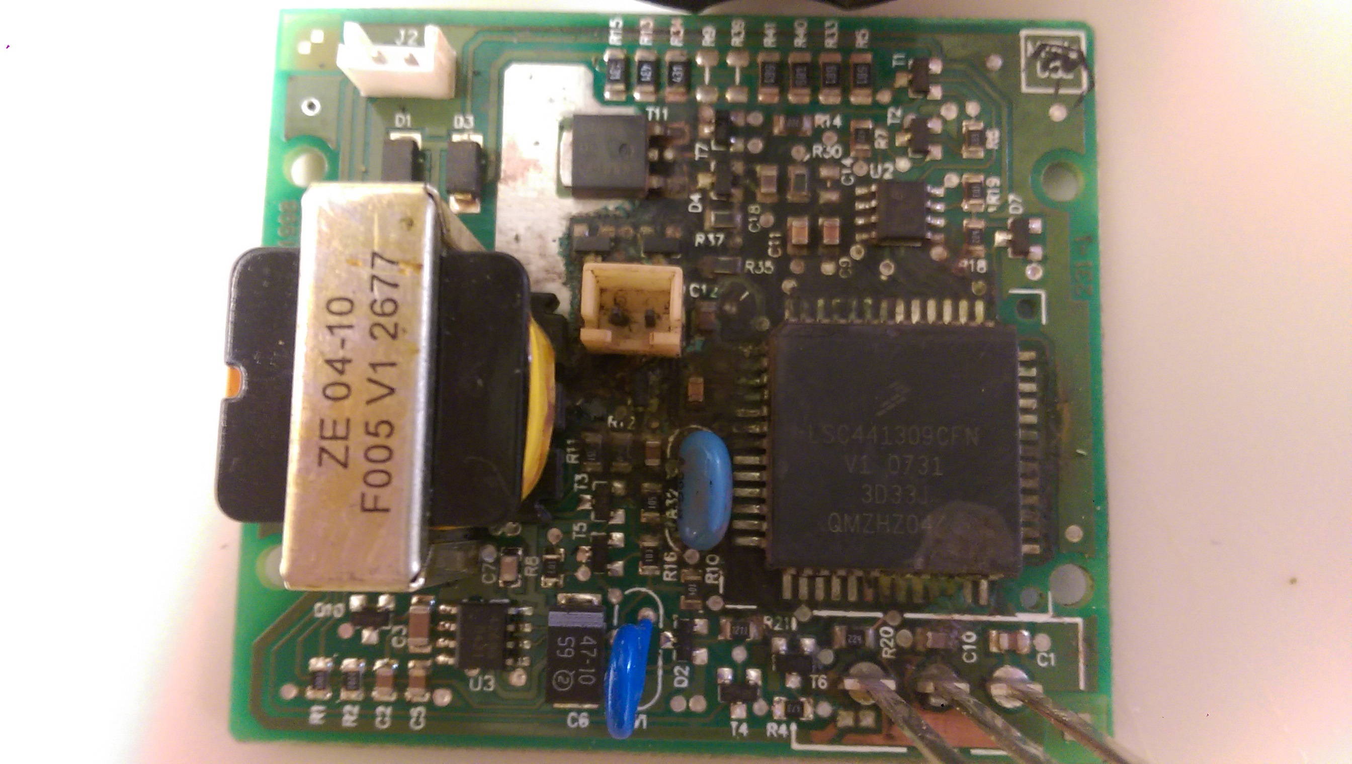

Cut a slot on the security bolt. Could not turn it with screwdriver. Cut a edge on the security bolt, then used a hammer and chisel to back it out.
Disconnected the alarm siren and the sunroof came back to life.
Both leads to the battery are burnt in two. Board looks cooked.

Board actually doesn't look too bad. If you have a VOM and a soldering iron you may be able to save it. Depends if you want to do the work.
Start by cleaning it with some alcohol and a Q-tip, but be careful not to further damage any of the traces. Once it is cleaned up use your VOM and check if the circuit path is still working. By this I mean pick a spot and follow the trace and check for continuity. Do this for ever trace that looks suspect. If you find some broken ones either use a very small wire and bridge it or just use solder and bridge it that way.
I forget what the battery voltage on it is (7.2V), but that should be easy to dig up. You can power it with regular batteries to see if the unit works (not sure if you even need batteries for testing). If it works then figure out how you want to power it (plenty of write ups and ideas on the forum). There is a charging circuit for the NiCads so don't leave non NiCads hooked up for too long). Get some epoxy or some use clear nail polish and seal up your repair and any traces (very thin layer to cover the electronics from air/corrosion).
You can buy a used one with a warranty and then cut that open and swap out the batteries - but make sure it works before you cut it open. Batteries last from 6-10 years and then start to leak. A new one can be had for about $250. I have gone both routes - the used one was just starting to leak, but had no board damage. The ones I have opened up from my cars were completely rotted with nothing to work with trace wise.

SuperHerman wrote: 10 Sep 2019, 19:28 Start by cleaning it with some alcohol and a Q-tip, but be careful not to further damage any of the traces.
It is gone. Started to clean it and one of the surface mount transistors lifted clean off the board.
Eric Vo-Vo has some tested used units for $75 in their eBay store ($129 on their website) comes with their Lifetime Warranty. I might go that route.

Used is a good plan, but I would still open it up and replace the batteries. That way you won't have to touch it ever again (at least for a long while). Bottom line is the NiCads leak - it is normal. Warranty or not, you still have to rip the thing apart. Only concern is you open it up, it is rotted out (but working) and Erie won't honor their warranty. I suppose you could call them and tell them your plan.
