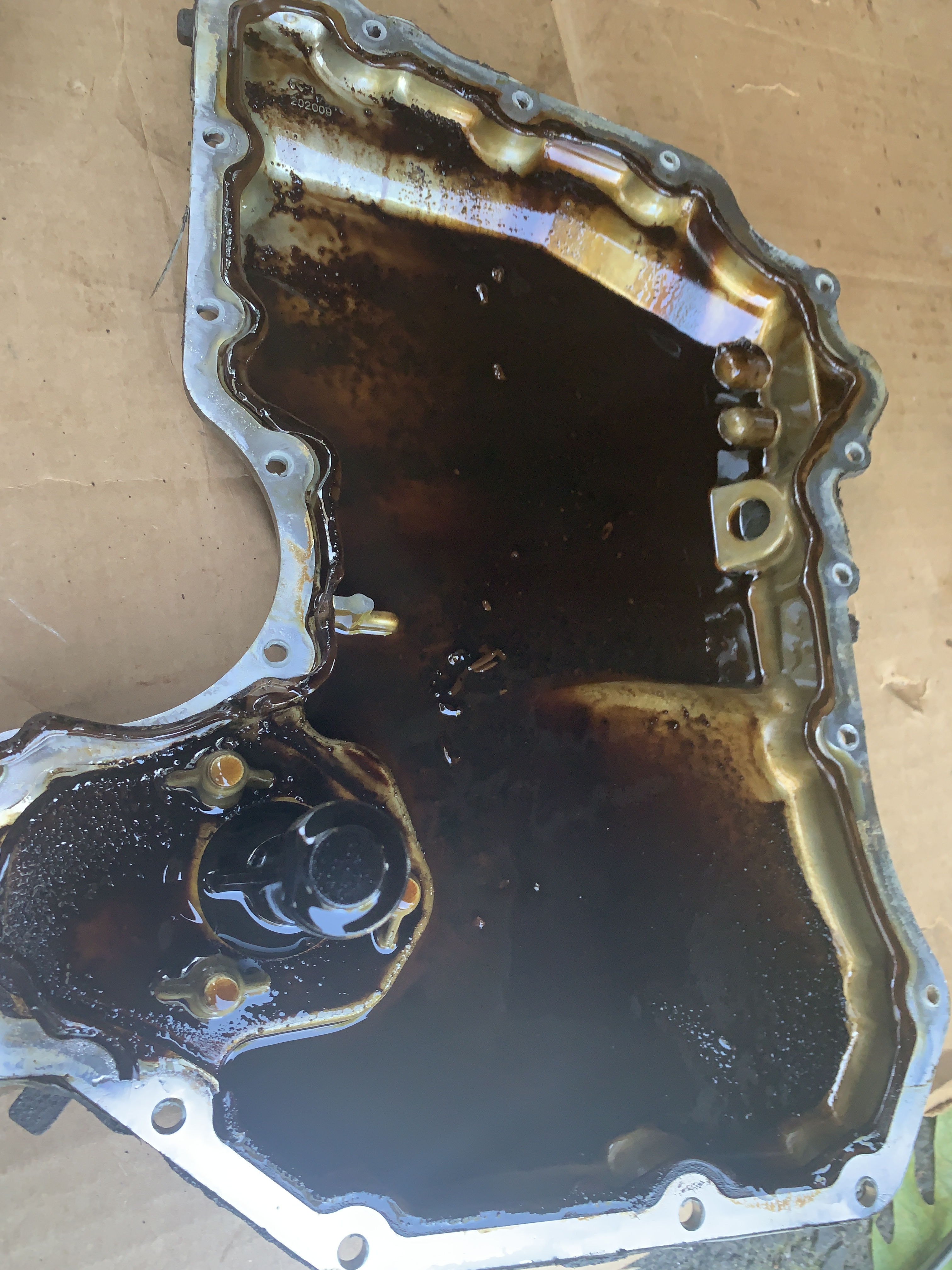

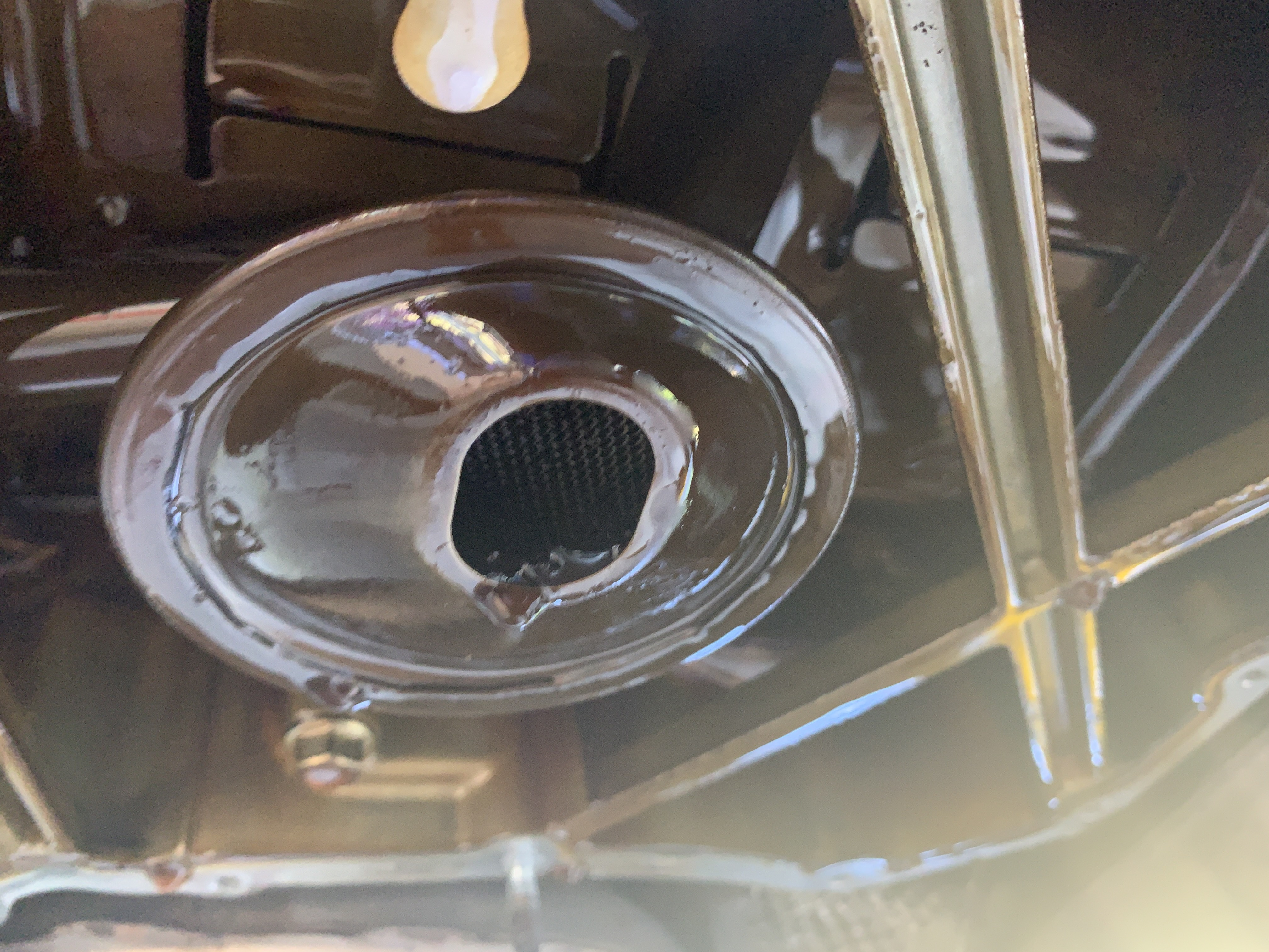

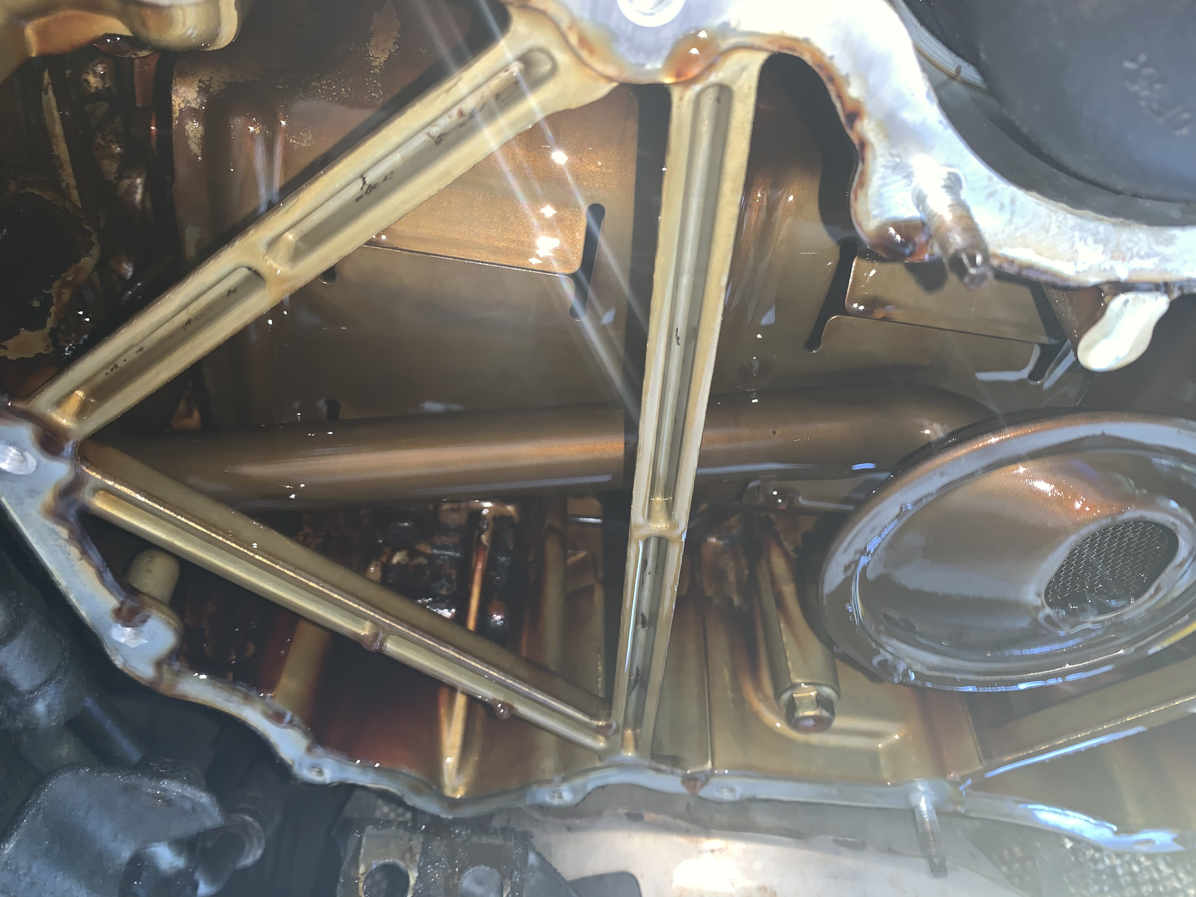

So I got the pan down and was hoping for the worst but it actually wasn't bad. I'll post some pictures. I'm going to try and get the pickup tube out and cleaned. I don't want to have to take down the walls but it's gonna be tough to get the tube bolts off. I'll see if I can get in there with a flexible extension. However the screen doesn't look all that bad so my other thought is maybe it is the pump that's failing me. As I was saying it seems to only kick on the "no oil pressure" after few miles of driving. I don't know how that could attribute to the oil pump. I would think if it's bad it would not work at all. Not work for a little and then fail. Maybe i'm wrong?

Here are some pics
