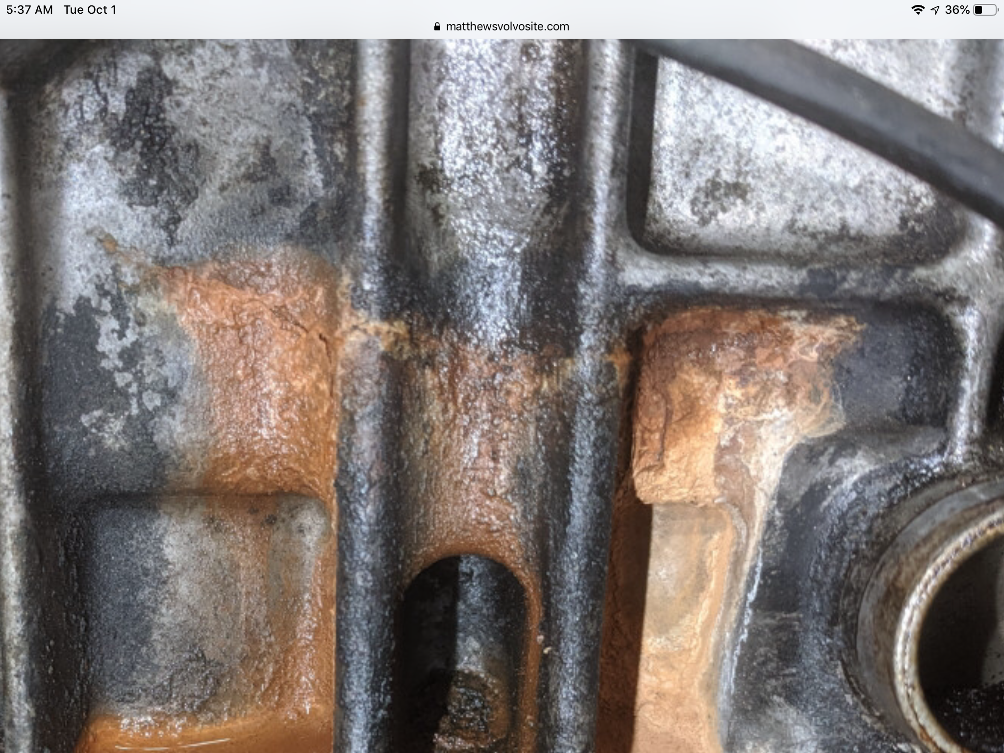

Hi all MVS members,
Am I correct in thinking that this is a cracked block? Lots of coolant loss caused me to assume that it blew a gasket then found this under the intake manifold.
Thank you for your time and expertise.

Yes, looks cracked starting at’ the coolant stain. Might be able to JB weld it to get some more life out of it.

Certainly not a common problem. It looks like a crack like abscate says. I would clean off the front of the block where the stain starts at the top. You may be able to get a dye to highlight if there is a crack.
Is the radiator good in front of where the rust is and the radiator hoses?

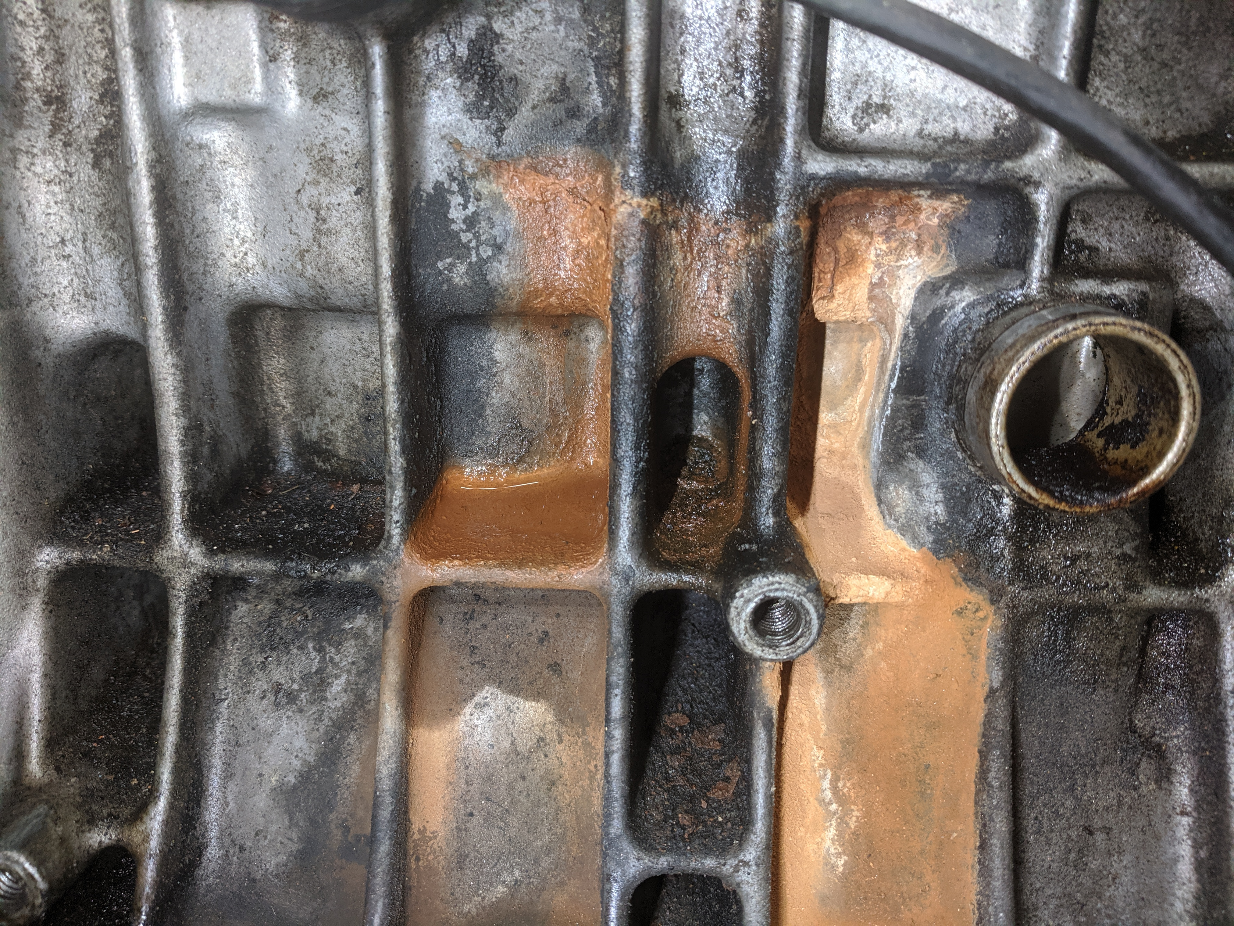

Closeup, :(

Thank you Neil, Abscate. Conclusion is that it is indeed a crack in the center of the block. Radiator and hoses check out. My next step is to do a weekend motor swap with the motor I have in the garage.
Onto the next adventure.

That is block rot cracking. It is what happens when nasty stuff sits in the bottom of aluminum and electrlysis starts and eats throgu hthe aluminum. The rust in the leaking water feeds electrolysis.If you stick dc voltemter leads in coolant tank touching the coolant and then touch block you will likely see over 250 mV (.25V)
