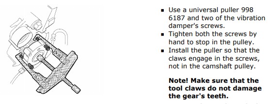

Maybe, I'm over-thinking this, but I've looked at the related VIDA repair instructions, and they show a "universal" 2-jaw puller like this to remove the crank gear.
I'm seeing similar pullers that I can get, but they come in different sizes for different gear sizes. Typically the sizes are 2", 3", 4", 5", etc. So, does anybody know the approximate diameter of my crank gear?

Cottection: The universal puller from amazon is for removing the harmonic balacer pulley.mp5802 wrote: 08 Oct 2019, 19:49Yes, I figured one of these inexpensive, flat steering-wheel-type pullers would also work. Thanks for the input.XC70Rider wrote: 08 Oct 2019, 19:43 I used this universal puller to get it off my 2.5T. The size can be adjusted.
https://www.amazon.com/gp/product/B0721 ... UTF8&psc=1
To remove the ctankshaft gear I rented this puller from autozone
https://m.autozone.com/loan-a-tools/loa ... 8_0_0?aqs=
The gear can only slide back onto the rod in 1 sequence so no markings are needed.
