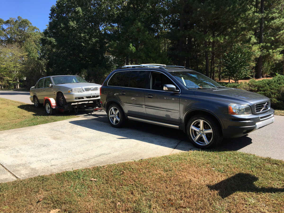

I found a Hidden Hitch at the junkyard yesterday for the XC90, bolted right on easily! An absolute steal for $28!
So naturally, I went and bought a hitch this morning and rented a dolly to go pick up my newest project.
The V8 did really well! Pulled the S70 with little effort, it felt like my cousin’s old F-150 when we pulled the 850 home. The brakes got a little hot as I got close to home (only a 30 minute tow) but I need to check those out again anyway. I just changed all four rotors and pads a couple weeks ago but I haven’t been happy with the pedal feel. Probably needs a bleed, I doubt the original fluid has been flushed out more than maybe once at 160k miles.

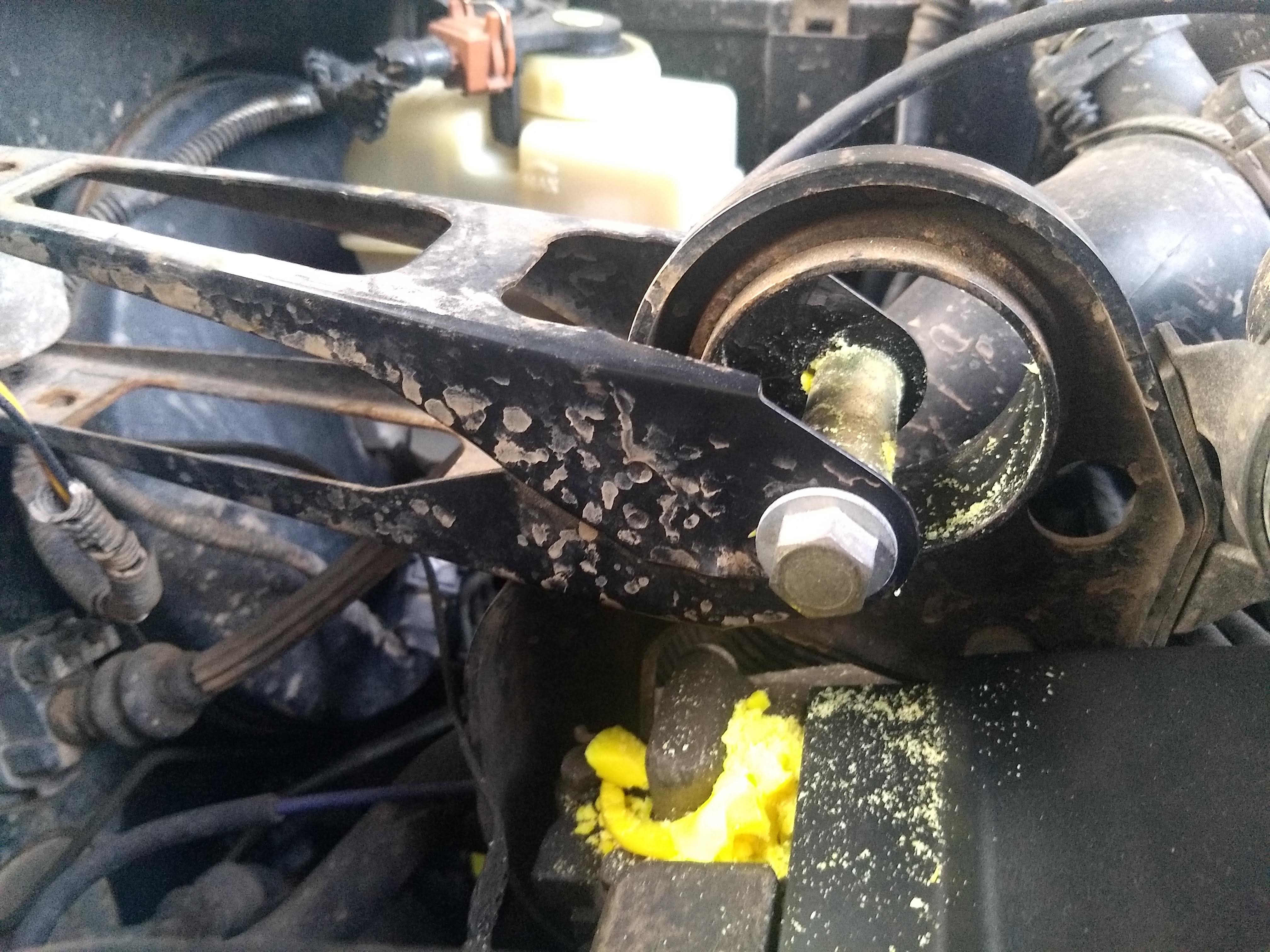

Peeked under the hood of the T5 to show my brother a crumbling polyurethane upper engine mount that the PO had installed, only to find that it had completely disintegrated. Amazingly, he had a spare one along with the press to install it.
He also checked Blue Steel, which had a bit too much play in the steering wheel, and discovered a floppy sway end link. Dry rot. He had a spare one of those, too.

That's why I only use good quality name-brand torque mount bushings!

He sure does! He showed up prepared!

Replaced top torque mount with OEM Hutchinson. The poly one was torn to bits after being in just about 2 years.
For anyone wondering, the long bolts go towards the crank pulley.

wizechatmgr wrote: 14 Oct 2019, 21:31 Replaced top torque mount with OEM Hutchinson. The poly one was torn to bits after being in just about 2 years.
P80 part change on the upper mount from -1998 to 1999- The bastards get the all cast metal housing type.
