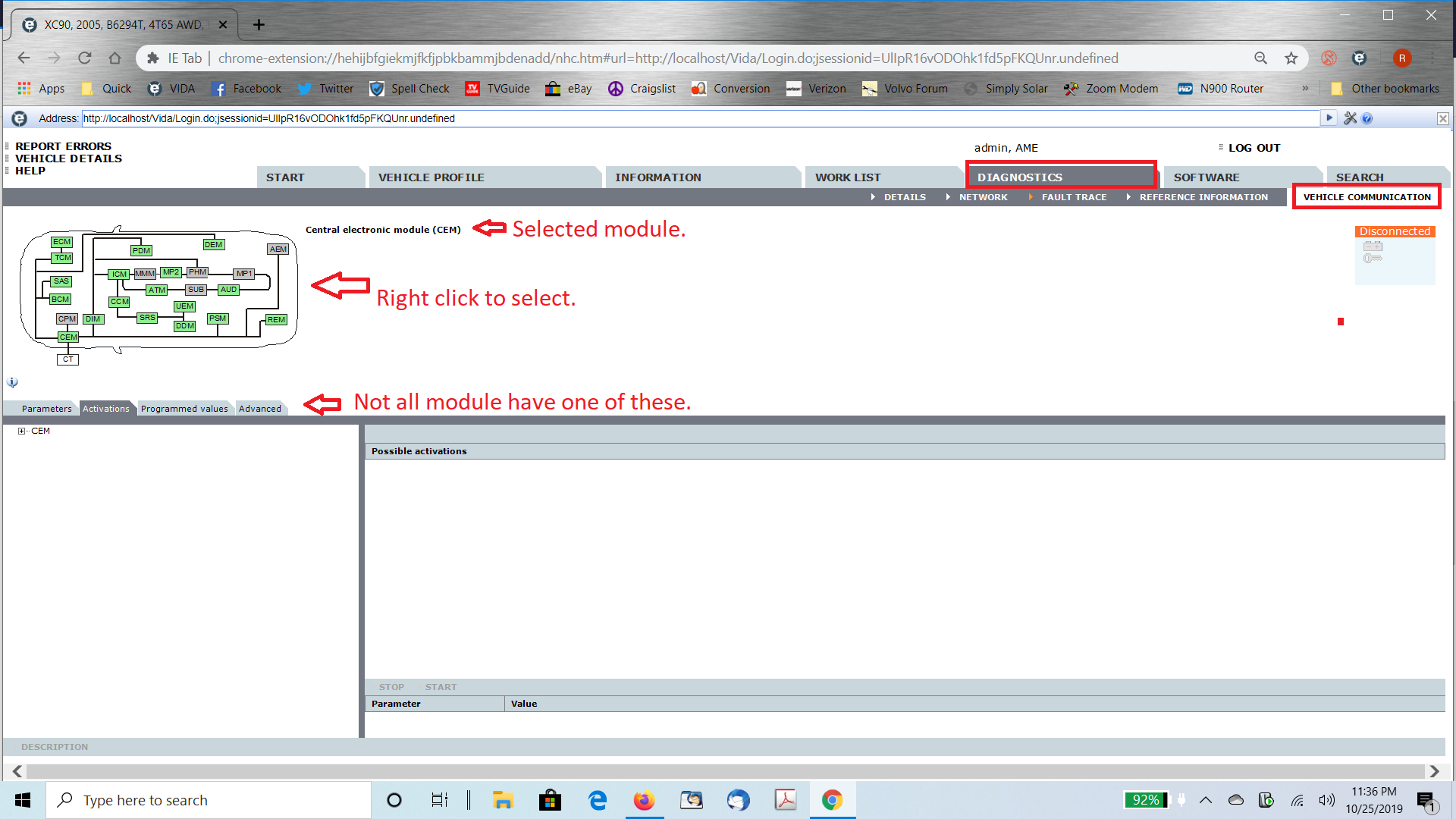

RickHaleParker
Posts: 7129
Joined: 25 May 2015
Location: Kansas
Has thanked: 8 times
Been thanked: 958 times
Post by RickHaleParker »
Right click, Right click ...
b3nb123
Posts: 8
Joined: 6 September 2019
Year and Model: 2010 XC90
Location: Essex
Has thanked: 2 times
Post by b3nb123 »
YES! Right click worked! Thanks
Quite a strange interface, needing a right click for accessing that! Also, when the information page comes up with a description of reading alarm causes, you need to click on the little graphic of the alarm module! Really isn't clear!
Also I'm sure it said the alarm triggers were 3125 days ago (Almost ten years!!) When I'm sure it meant 3125 hours (About 130 days)
All the recent alarm triggers were caused by the mass movement sensor, so I guess that could do with being changed?

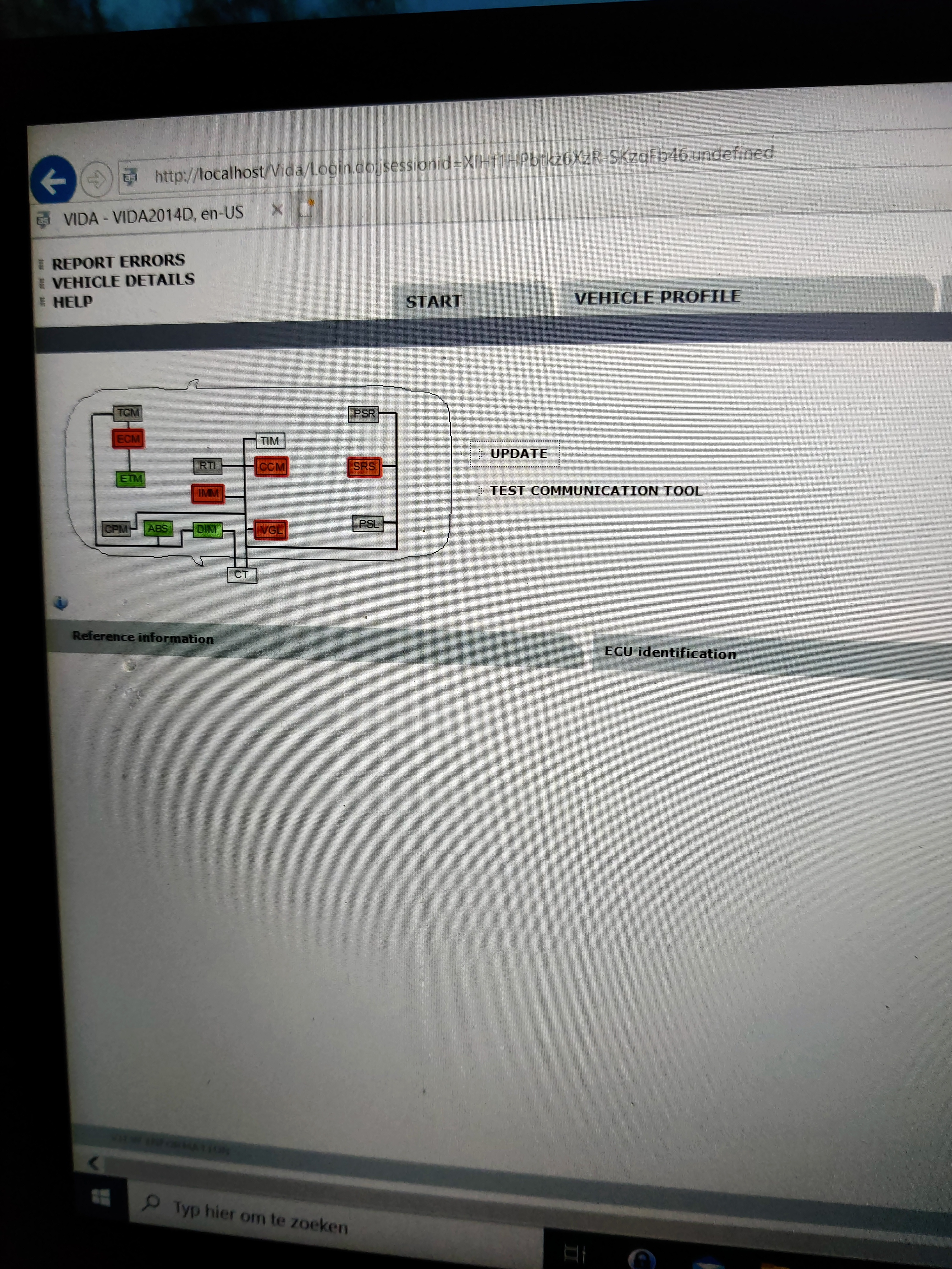

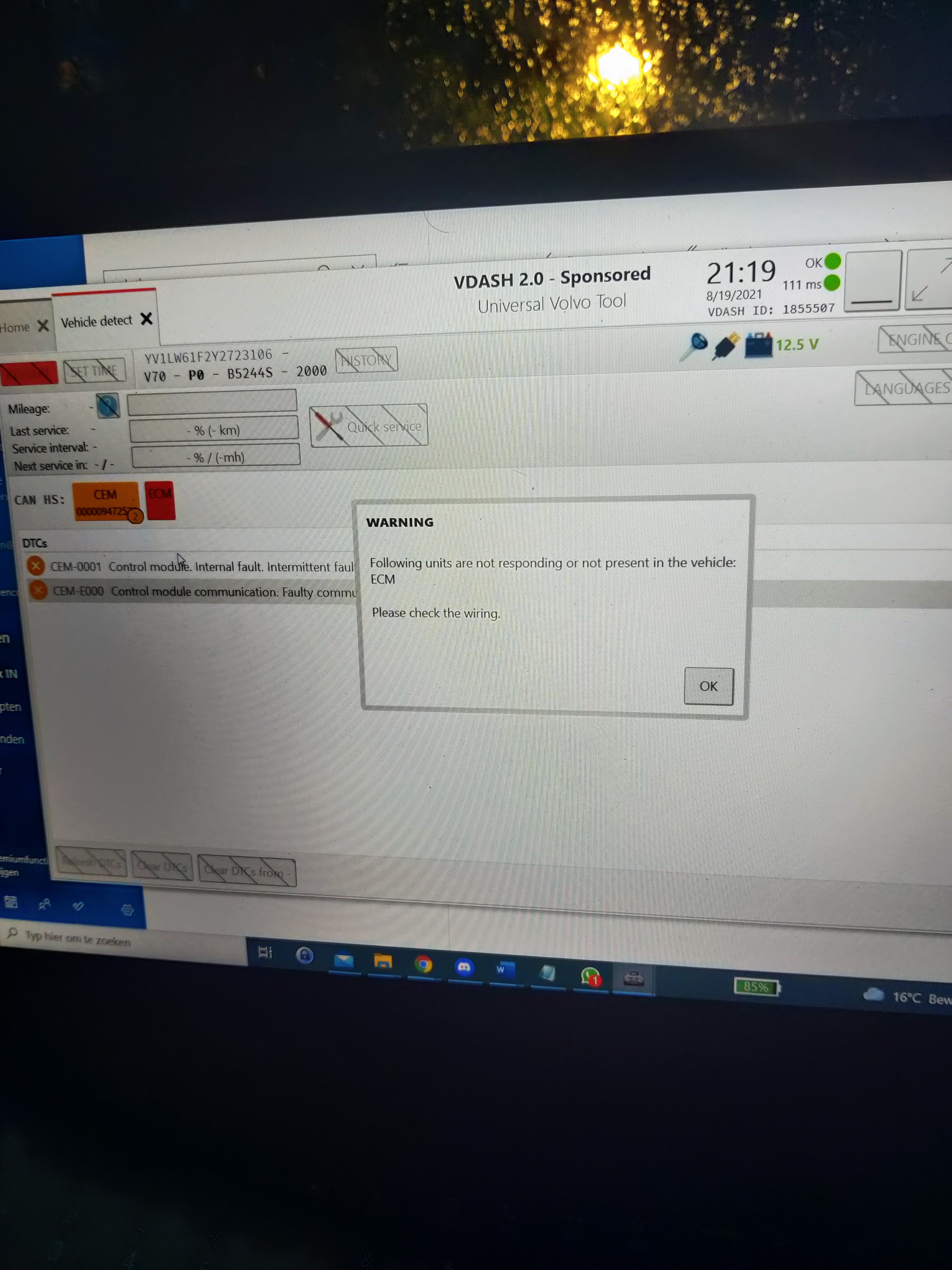

I have somewhat other problems with grayed out modules. Especially, since I could not reach any information on the ECM both with Vida and with Vdash.
Does anyone know if that would mean that the ECU is broken? Or can it still be that my stalling problem is due to MAF, IAC, Voltage Drop, Fuel pump?
I hope to hear some thoughts!
