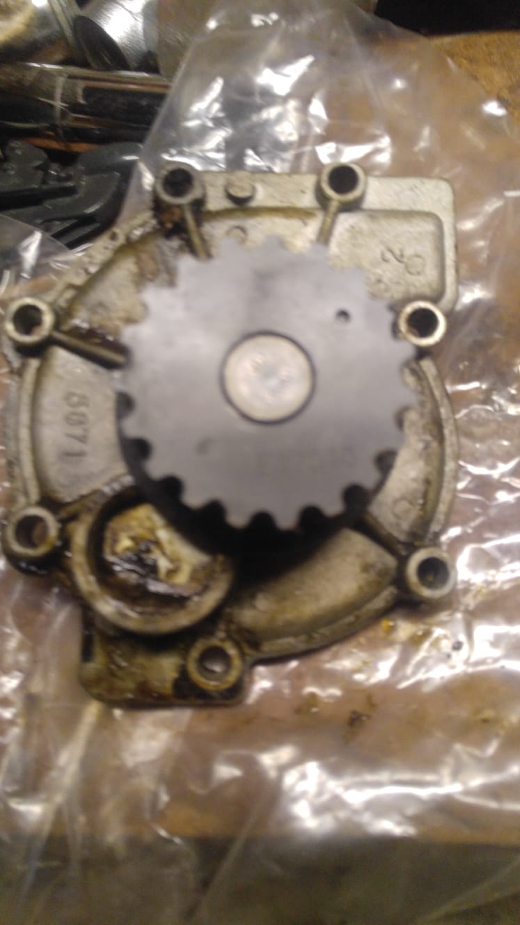

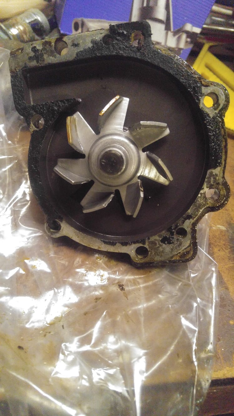

I just replaced the water pump (and a few other things since I was already there). Sounds great again. The bearings on the GATES WP were in terrible shape. Thankfully I didn't let it run like that for long...It had only been a week since I heard the noise.
Those of you with GATES water pumps keep a close eye on it. Looks like a lot of people had issues with them.

We should share this on the S60/V70 forum as well, same 2.5T engine. What was the brand - if any - marked on the pump ? Any pics ?
