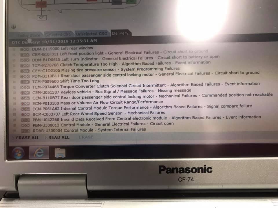

From a MVS FB post not getting any attention:
Have a 2010 XC60 the navigation screen is black like its shut off. When I put it in reverse it turns whitish gray. Could my screen be bad or is something else going on. Has navigation cd in the player in the trunk.
2010 XC60 - navigation screen is black

The last two codes reveal this with some Googling:
PBM-U300013
Definition:
Control Module. General Electrical Failures. Circuit Open
Description:
When the function is activated the Park Brake Module (PBM) checks its own system voltage. The diagnostic trouble code (DTC) is stored if the control module detects that: Direct voltage to control module is lower than 8.5 V. Incorrect value runs longer than 1 second. The control module's test for the diagnostic trouble code (DTC) starts in the event of: Control module supplied with power. Activated function. Note! The control module can only detect the fault once the test has been started and the diagnostic trouble code (DTC) is stored when the conditions are met.
Cause:
Supply voltage too low.
RDAR-U300004
Definition:
Control Module. General Signal Failures. System Internal Failures
Description:
The remote digital audio receiver module (RDAR) checks its internal status. The diagnostic trouble code (DTC) is stored if the control module detects that: An internal fault has occurred. The control module's test for the diagnostic trouble code (DTC) starts in the event of: Ignition switch position I and II.
Cause:
Internal fault in the control module.
Was this car flooded? Do you know the history?

I do not know the history it has been sitting for a year been driving it for a few days runs fine, has clean title

also have codes RDAR-u300004 control module system internal failures, RDAR-u300055 control module system programming failures not configured, RDAR u300362 battery voltage algorithm based failures signal compare failure. have checked fuses they are good.

A carfax might help here. It could be cobwebs from sitting, or it could be a flood car from the southern/midwest US states if it was owned there.
Those cars are often dumped on the used market after washing the title.
Modules that have been flooded trap water, and fail.
Otherwise it's just a normal module failure. Perhaps someone here will chime in with more insight.

I would do a battery disconnect and hold ground led to pos cable for 10 seconds and then see what codes come back and if the hard reset brings the screen back. Many of those codes look like low voltage causes.

Remote Digital Audio Receiver (RDAR) AKA Sirius Radio. If you don't use Sirius Radio I think you can disable it by unplugging the the RDAR and installing a MOST jumper, Volvo part number 8688083. Yes 8688083 is labeled as a brace, that is Volvo sneeking out a fix in the middle of a lawsuit.jessejames1205 wrote: ↑31 Oct 2019, 13:17 also have codes RDAR-u300004 control module system internal failures, RDAR-u300055 control module system programming failures not configured, RDAR u300362 battery voltage algorithm based failures signal compare failure. have checked fuses they are good.
You could replace the RDAR with a different unit. As far as I can see no software reload is required. Just make sure you get the Sirius ID off the unit before you close everything up. Just hope you get a unit with the upgraded software. The old software will cause the battery to drain.
The Multimedia Module (MMM) is on the same MOST network ring as the RDAR.
