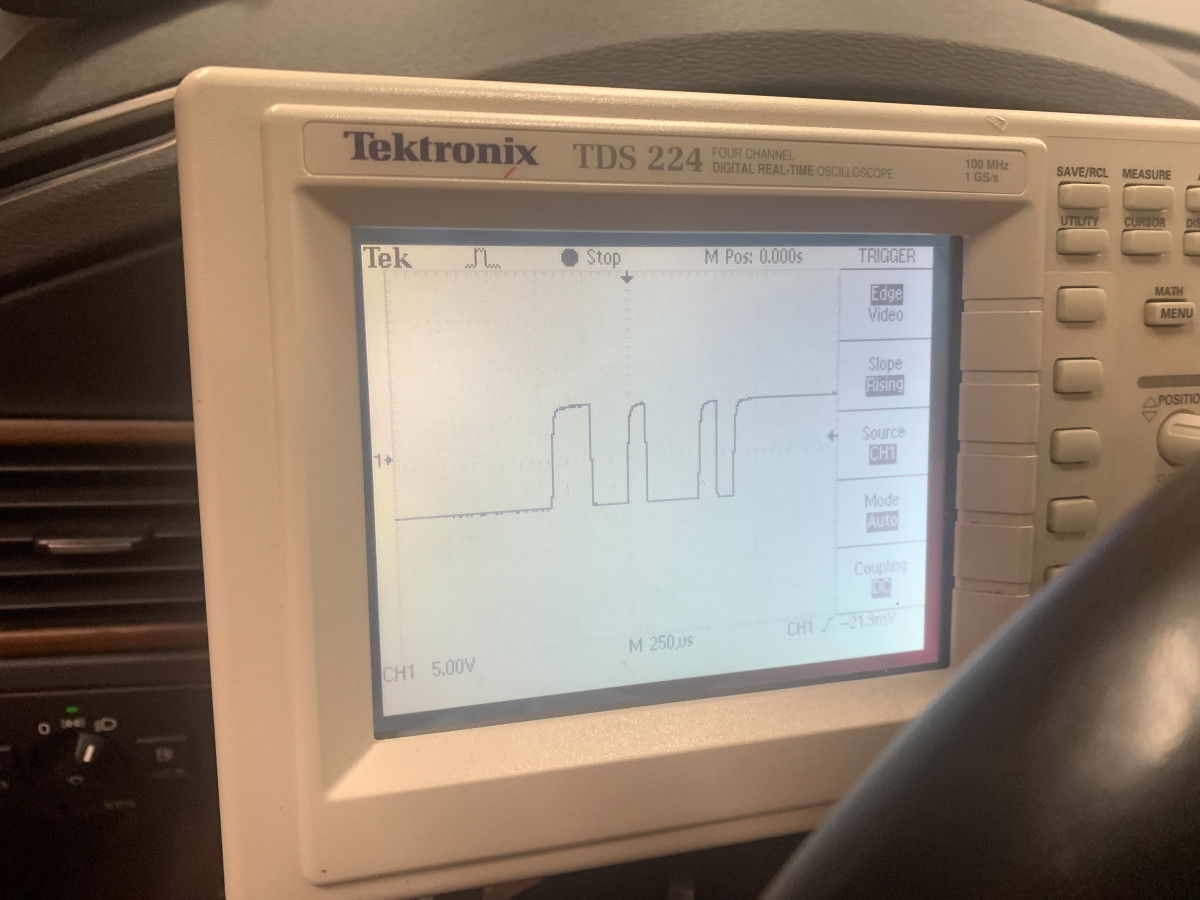

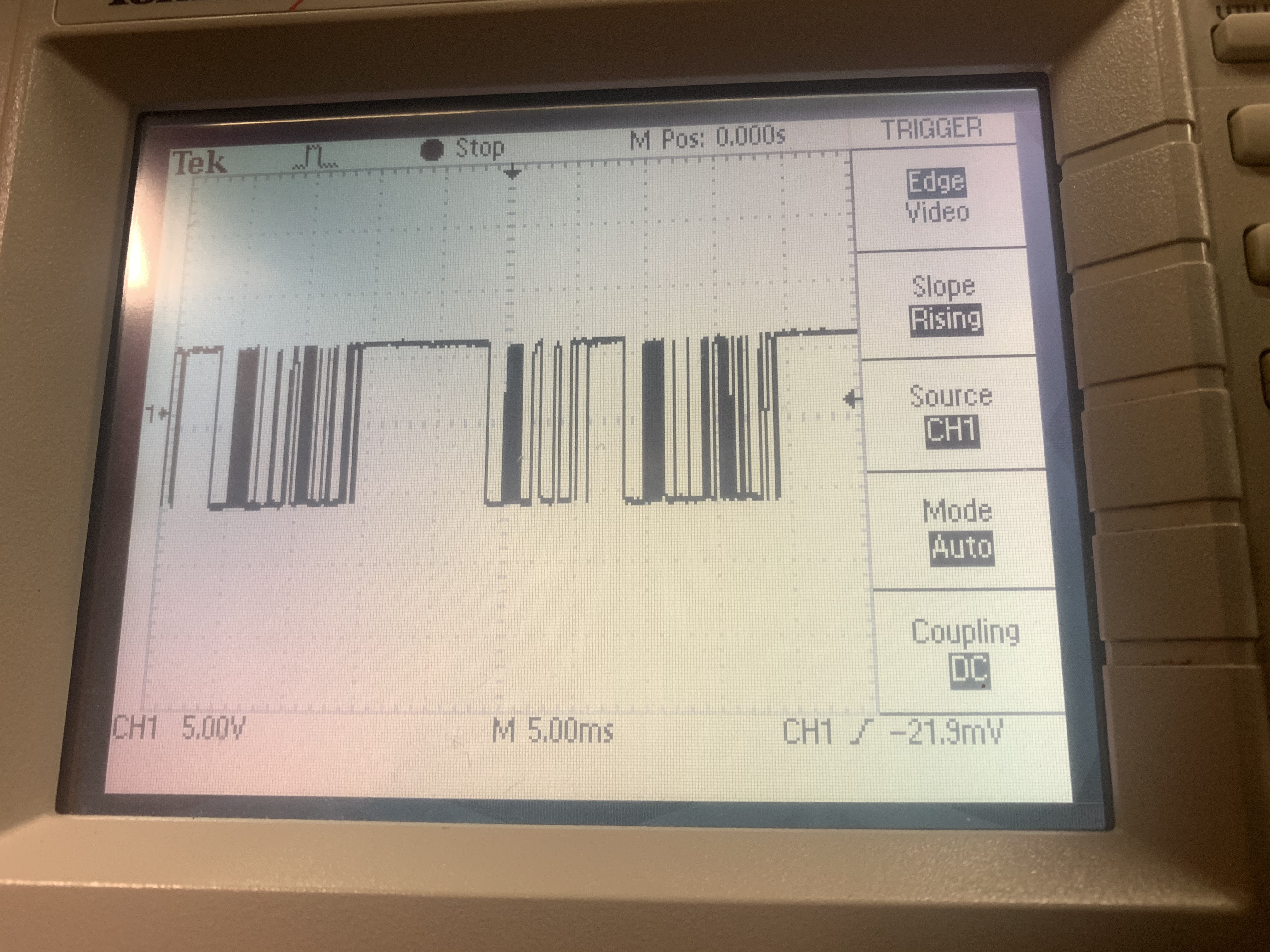

I took the door panel off, green connector looks good. I also checked the green/white wire with an oscilloscope and there is serial communication to the Left hand camera, however I don’t know the protocol so not sure if the camera is responding.
Is there anything else I should look at before spending the $$ on a new camera?
Thanks much for the help

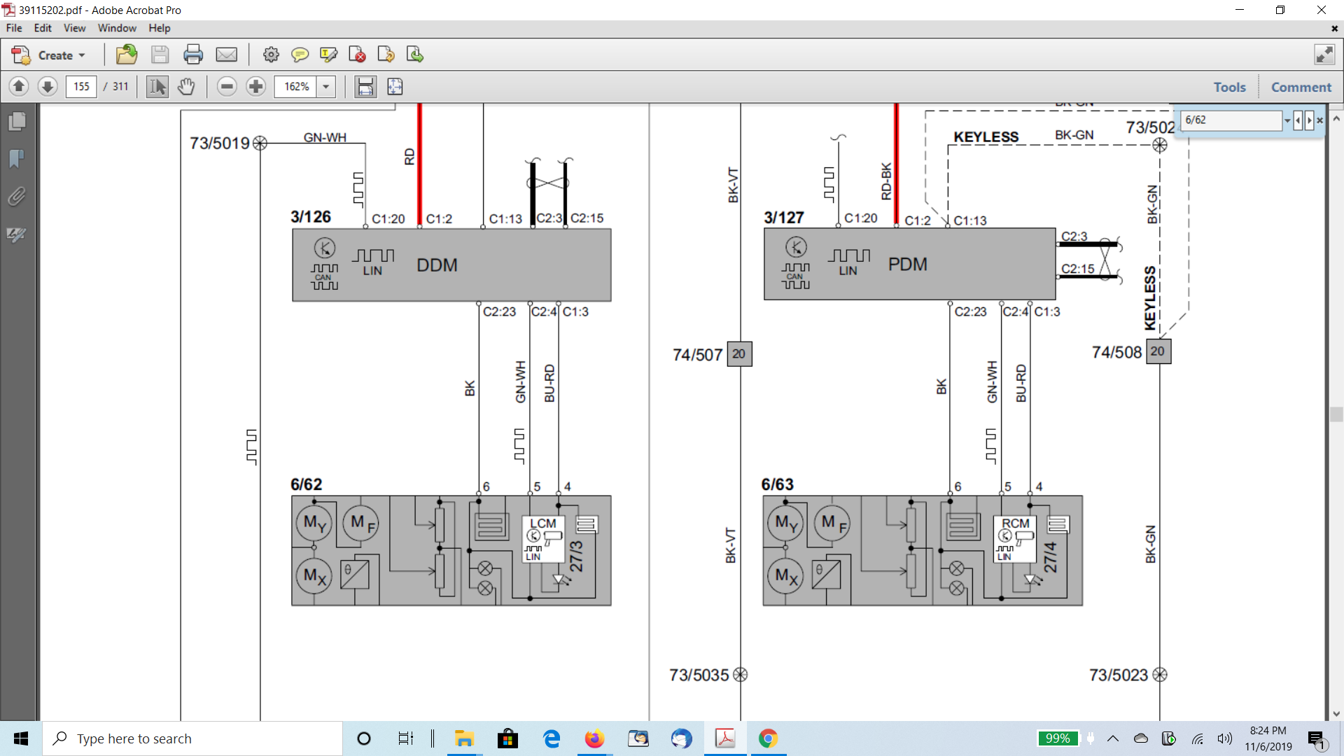

Power, ground and data all three from the DDM, covers all the I/Os.bans25 wrote: 05 Nov 2019, 20:35 Is there anything else I should look at before spending the $$ on a new camera?
