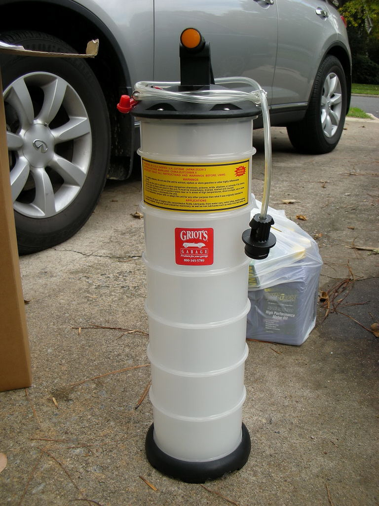

I'm bleeding brakes after installing new rear calipers. I usually do it the old fashioned way with Mrs Bart on the pedal. I have one of those Griot's vacuum bleeders that I've had in the box but never used it. They actually call it a multi-fluid extractor now. Has a tall cylinder vacuum tank and fittings.
So I'm having trouble getting the things bled correctly and I have no helper today. The fitting on the bleeder screw has to be held on with hand pressure - it doesn't fit over the bleeder like you do with a clear hose. You fill the rez filler bottle, pump up some vacuum, hold the fitting over the bleeder, open the bleeder, and then open a check valve in the hose. The vacuum sucks fluid out of the bleeder.
Sounds simple enough, but I'm getting a ton of big bubbles, it doesn't improve with time, and I've run a large bottle of fluid through it already.

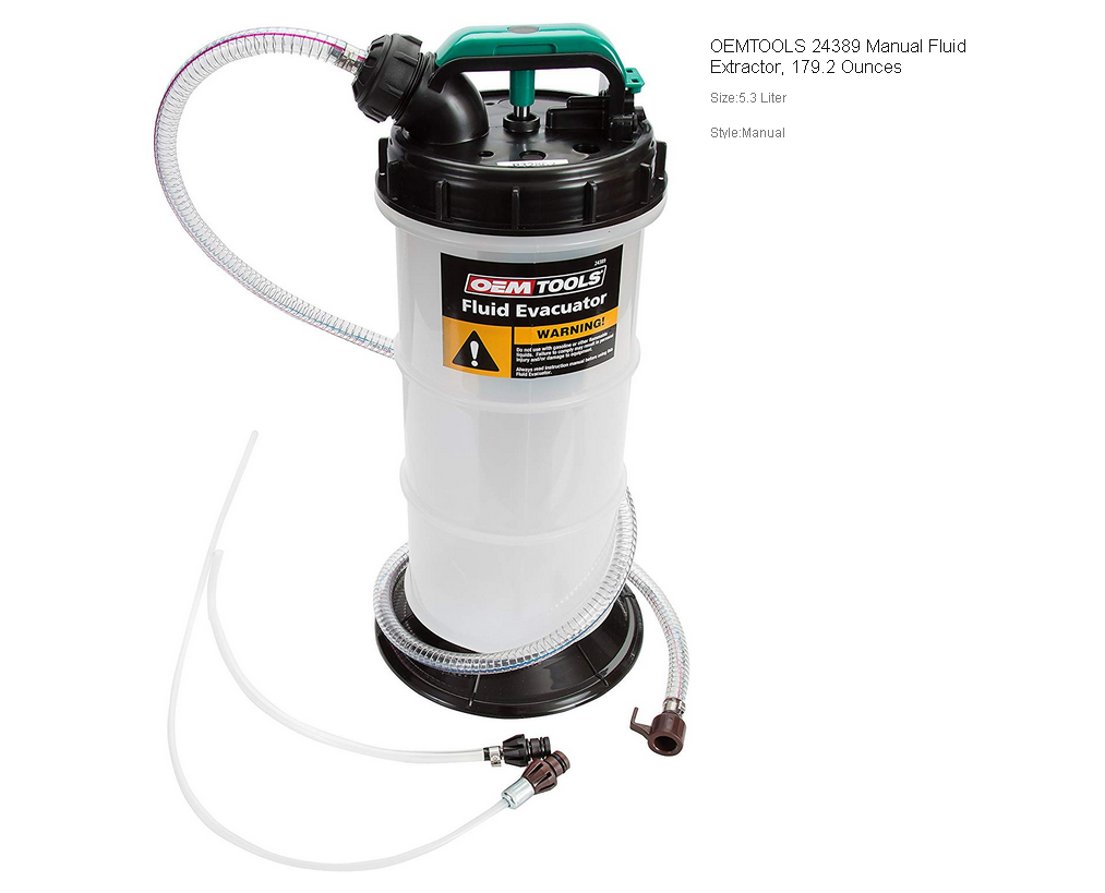

It looks similar to this - that red fitting on the hose "fits" on your bleeder.....sort of.

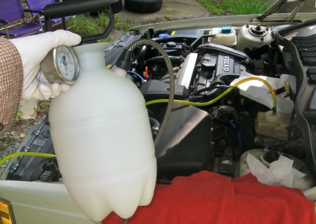

I have had good luck pressure bleeding the brake system using a home-brew tool similar to the Eezibleed system. I built it with a hand-pumped sprayer from the hardware store and a spare brake fluid reservoir cap, some fittings and tubing.

Can you post pics of your home-brew tool? Thanks, June

There is a picture of my homemade pressure bleeder here:
viewtopic.php?t=58362
