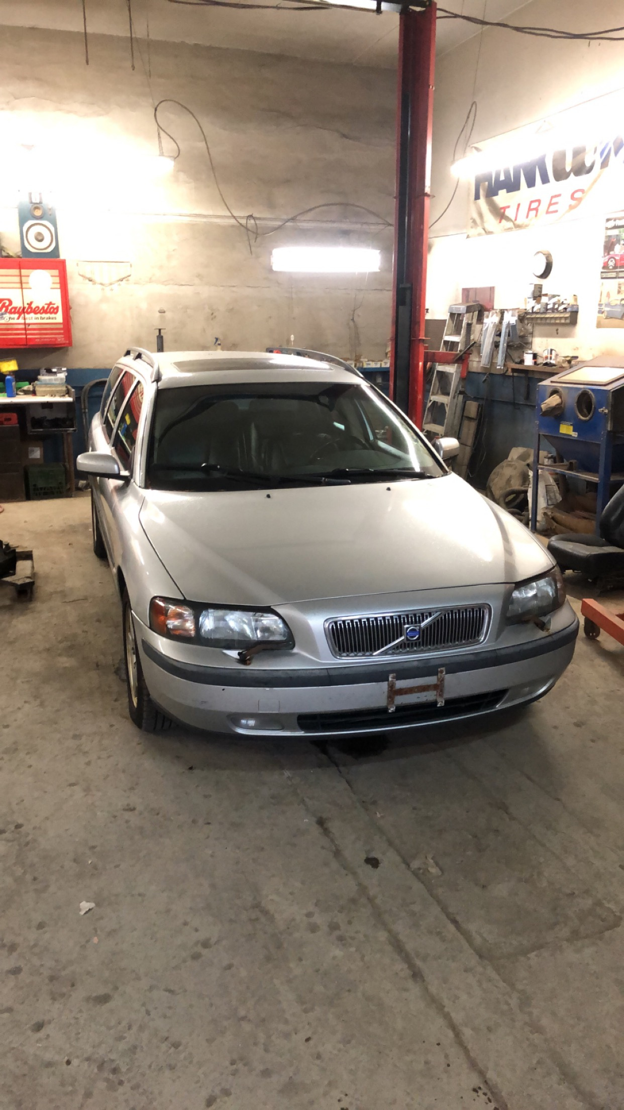

Didn't do anything to it yet but I bought this beauty today!
04 v70 T5
In stick 🤤
04 v70 T5 fwd, manual. ~206k and counting

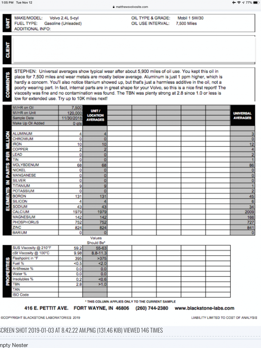

You settle the oil change interval question with data from Blackstone.
My all highway P2 driven tested like new oil at 7500 miles, even TBN was like new, no water, no fuel.
I change it at 7500 and top off the T5 with the old oil

Fleets do this to maximize value of maintenance dollars. Economically it doesn’t make as much sense for a single car (tests cost $25) except to gather info on your oil aging pattern.
Here is an example of oil changed at 7500 miles, I don’t have to guess engine or oil condition on one of my prime runners. In this case , after 7500 miles my oil is still like new. I choose to change it on this car, one of my two prime cars, and use the oil as top,off for my winter or Airport rats
