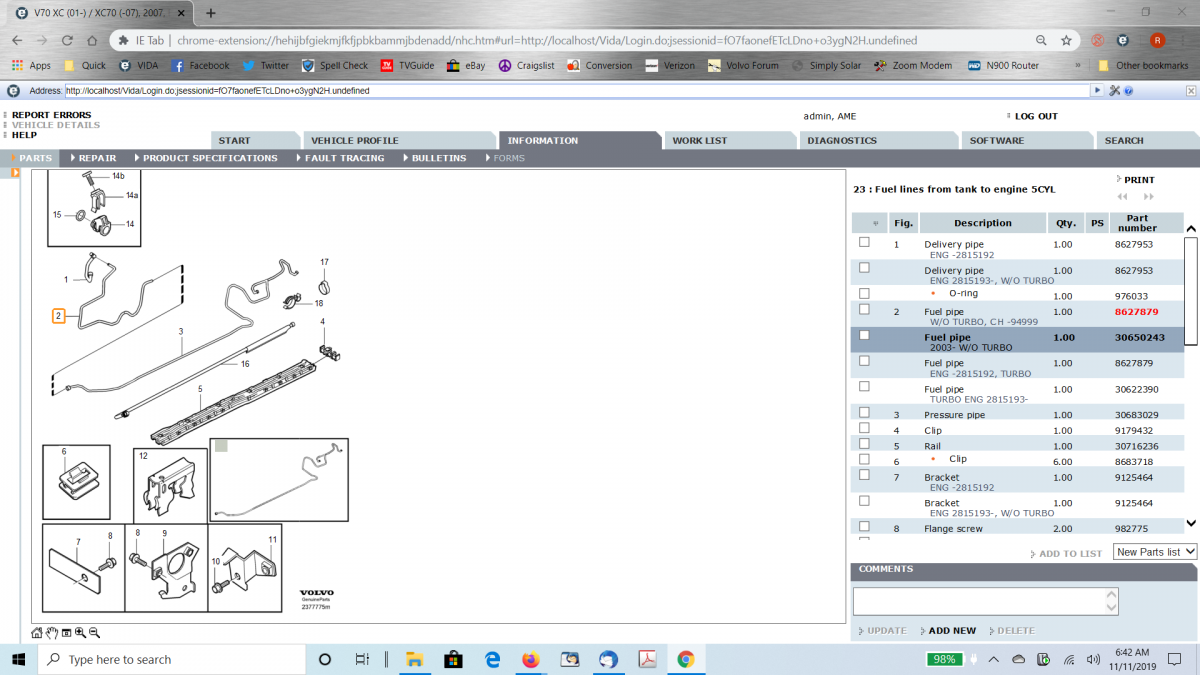

Thanks for the parts diagram / Vida dump. Is #14 fastener used to fasten the #1 fuel line to #5 rail? Does #3 pipe go back to the tank?
