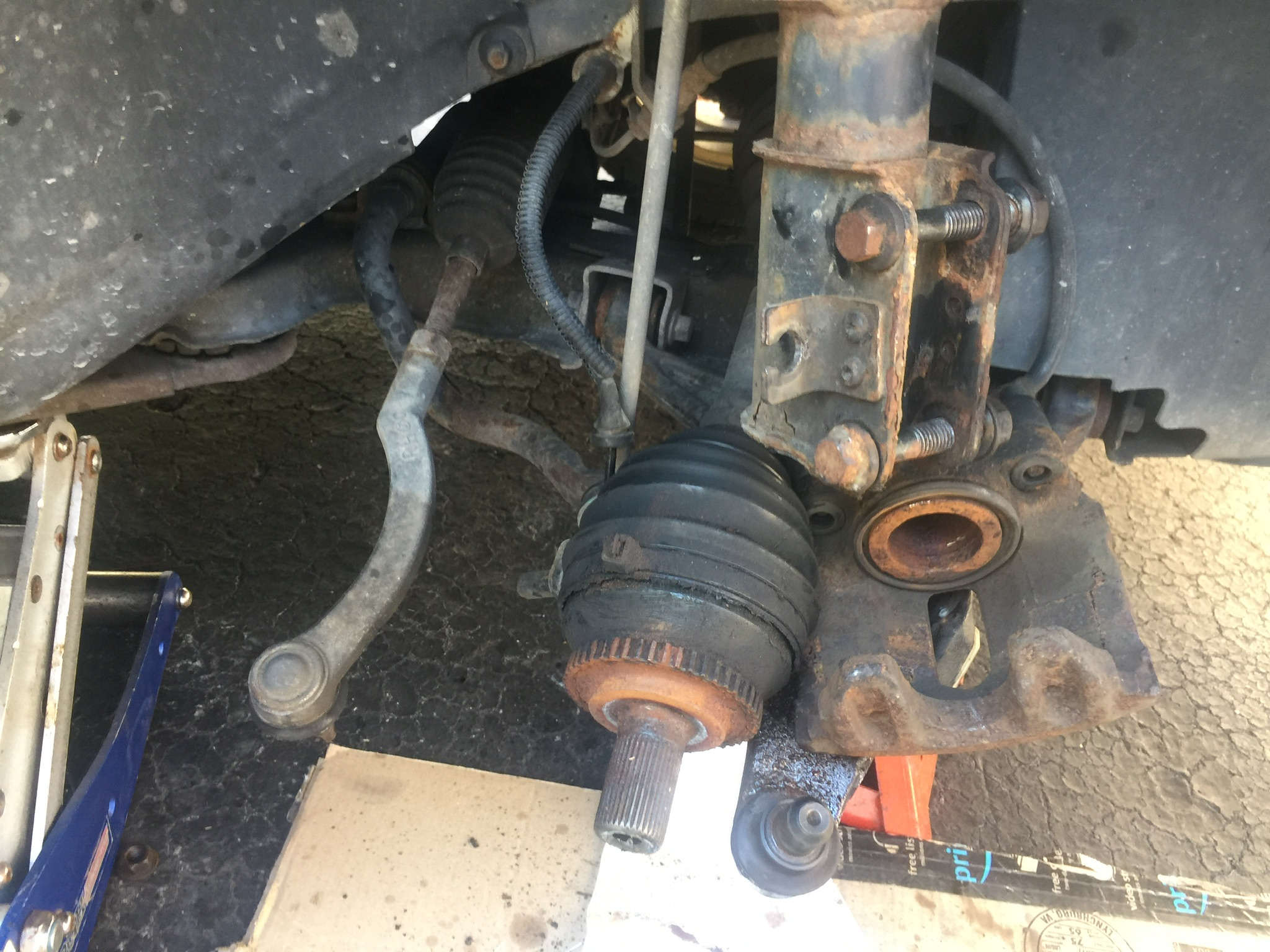

At 241k, second replacement.
One hour to knock off spindle. I stupidly used wrong socket on balljoint bolt, androunded it off. I cut it off in 3 minutes with Dremel, awesome save.
Everything else was easy. Bearing was gritty and nasty turning.
New one FAG from FCP, about $118
Used new hardware onbearing and ball joints, and axle shaft bolt (1999 M8 bolt)
Ball joint hardware
BUFO M8 x 50 mm Grade 8.8 Flange bolt 988185
Flange Nut M8 987891
I still have faint drumming on left swerve, disappears on right swerve.
Differential?
Axle shaft?
Rear wheel bearing? ( probably try this first since I have free one from 1998)
Job time, 3 hours with a 1 hour conf call in middle where I cleaned parts on bench
