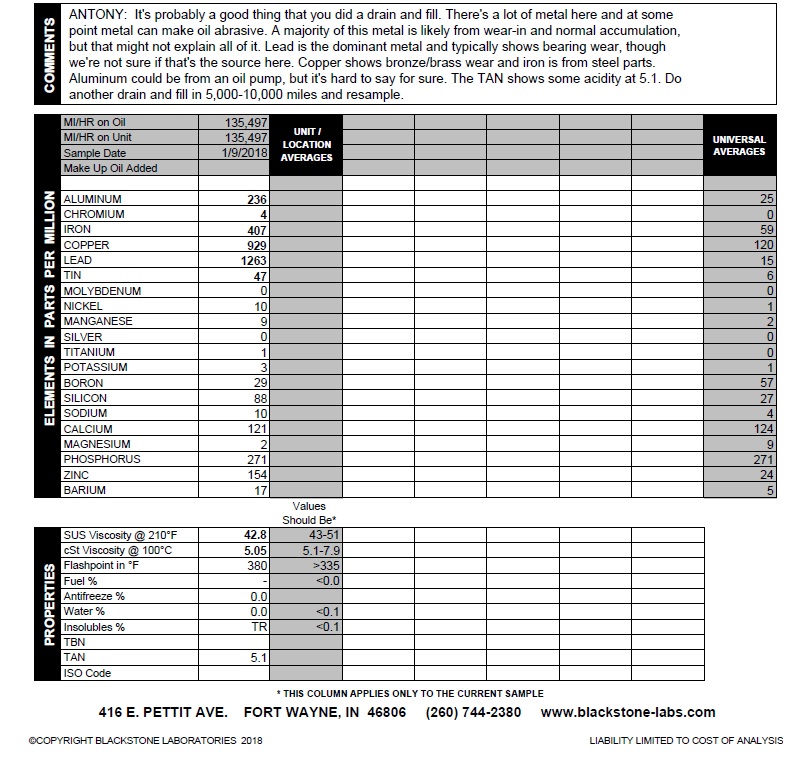

For those who are curious, I completely changed my transmission (an Aisin 55-50SN) oil for the first time at ~135,000 miles and sent out the oil to a laboratory for analysis. This was the report from the tests:
I do not yet have a comparable analysis for a clean oil or lightly used oil sample but this was more than enough to convince me to change the oil more frequently. I'm at 20k miles on flushed oil (I pumped all the oil out using the radiator drain when I sampled for this report) and it still looks red, smells new, but is beginning to mark a paper towel lightly brown. 30k miles is a good interval for a transmission of unknown history. If the oil was changed at regular intervals since factory, 50k-60k miles seems adequate to me. Volvo I believe recommends a 52,500 mile interval for "towing" applications in the maintenance schedule. Do whatever you are comfortable with, but I would not listen to those who tell you to never change the fluid.

I purchased a 98 S70 T5 with 230ish K in 2012. The transmission fluid was coffee with a tint of silver. I used the same method and flushed it and drove it for a year. Flushed the following year as it started to get dark again. Car did not have problems but felt slower. Glide again after the second flush. I've only drain and filled once or twice out of caution for Honda's but last year I flushed, bypass the radiator and installed a transmission cooler on a 220K 03 Odyssey and have not had a problem. Had the van since 154K and it's the smoothest thus far with the cooler trans_fluid.CorpsOfficer wrote: 01 Jan 2020, 15:26 For those who are curious, I completely changed my transmission (an Aisin 55-50SN) oil for the first time at ~135,000 miles and sent out the oil to a laboratory for analysis. This was the report from the tests:
Seeing your report I think I will stick to flushes rather than putting clean fluid into dirty. Diluting to eventually to have cleaner fluid I suppose gives some a peace of mind but I haven't experienced or know of a case where a flush did a transmission in.
