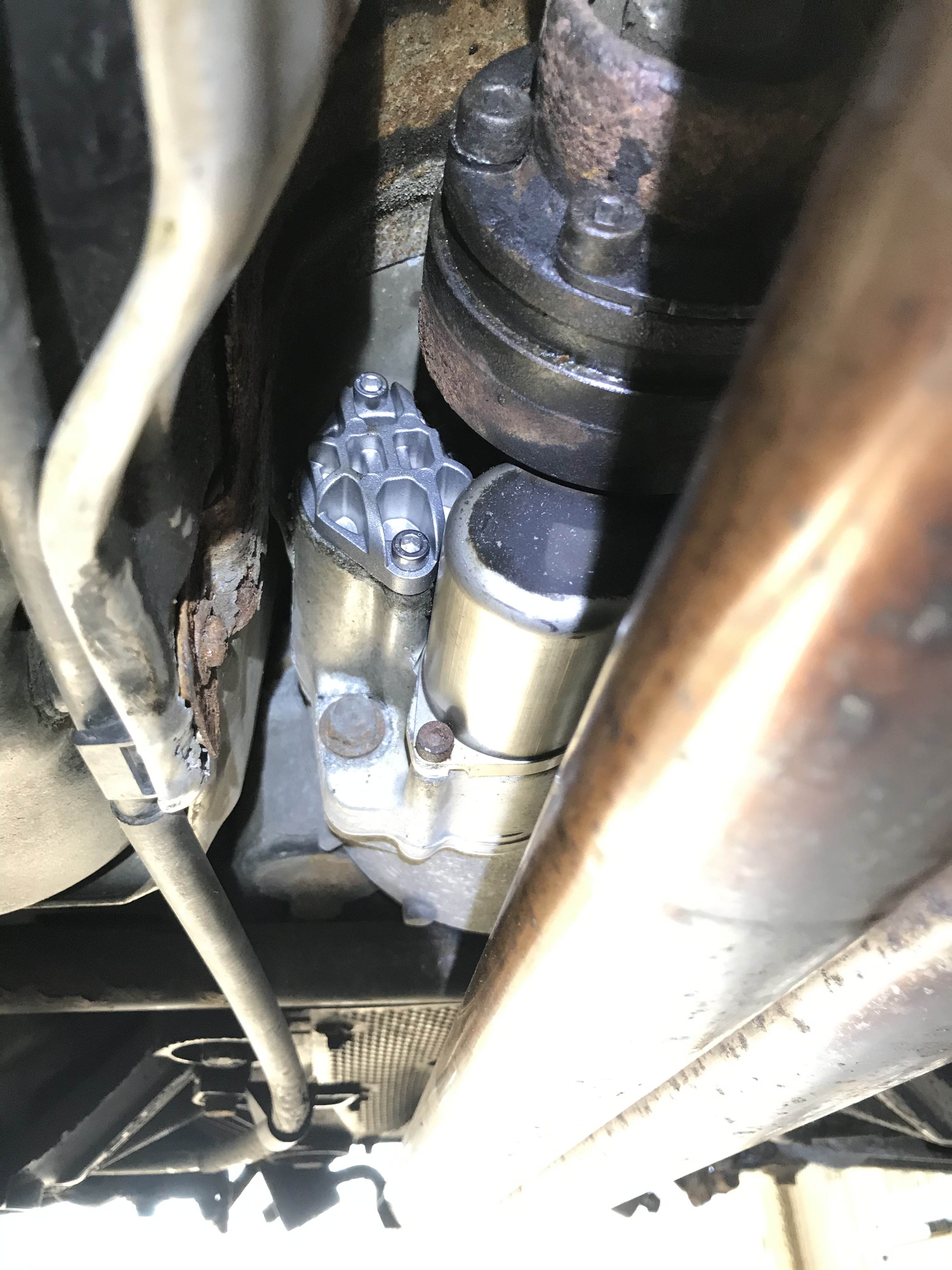

The ring VTL was talking about is on the outer CV joint on your CV axles. It spins just inside the knuckle & the hall sensor that is supposed to pick up its rate of spin is directly above it, protruding through the top of the knuckle, it’s a wheel speed sensor, basically.
You don’t even need to take your wheel off to see if the center bolt is present, loose, or otherwise. Just take out the center cap on your front/rear wheels & see if there’s a bolt there, then check for tightness. If tight, look for the next culprit. We’re it me & all 4 bolts were in place & tight, I’d start reading up on ABS module failures & Xemodex. Hopefully yours isn’t failed.
Onto the AWD, the sporadic nature of your functioning seems strange to me. Comforting in that it’s very likely your bevel gear (transfer case) is still ok & you’re facing an electrical malfunction. I don’t have a cursory knowledge of the AWD system but I have replaced a couple DEM pumps & several filters. DEM = Differential Electronic Module, often also called Haldex or AOC (Active On-demand Coupler). It lives at the front of the rear differential housing & is just aft of where your rear driveshaft mates up. The connectors on these can really be aggravating.
Do your best to not break them!
I’ve had it several times where I wasn’t able to get the connectors plugged back in all the way. In all these cases it was tiny stones resting up there in the valley between the two receptacle preventing them from being plugged in all the way. Blow out the area well with compressed air.
There was an update to the filter design on Haldex 3 systems. Here are some pics to help you get zero’d in on where it is. A wet Haldex unit is not a good thing. The wet pics are a customers car I took a quick peek at. You can see the “finned” cover on the bottom two pictures, that is the updated filter. Also circled in yellow & next to the filter is the DEM pump, black cylindrical object.
