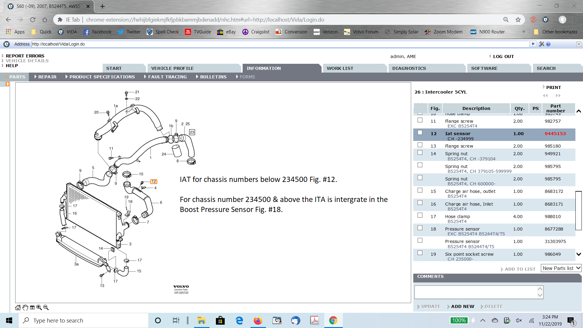

I would like to clean the intake air temperature sensor, I believe its temperature is reading higher than it should in a cold start in the AM.
Where is it located? Is it next to the intercooler on the drivers side or is that just a boost sensor? Is it below the intake manifold? A picture would be great.

There is no 2007 S70 ...
This is for a 2007 S60.

Thank you Rick! That S70 was a typo should have said S60 (which was correct stated in the body)
I saw that picture and then could not find the IAT sensor along pipe #6. I’ll look again.
The text (I hadn’t seen before) in this picture describes an alternate location, so I might have a chassis above 234500 that has the IAT combined with the boost sensor. That sensor has a bunch of wires. I must be very careful not to break it as I bet it is really expensive!

rjj100 wrote: 22 Nov 2019, 16:08 I might have a chassis above 234500
The last six digits of the Vehicle Identification Number (VIN) is the chassis number. You can find the VIN on the title, the VIN tag in the corner of the Windshield or on the Identification plate under the hood.
