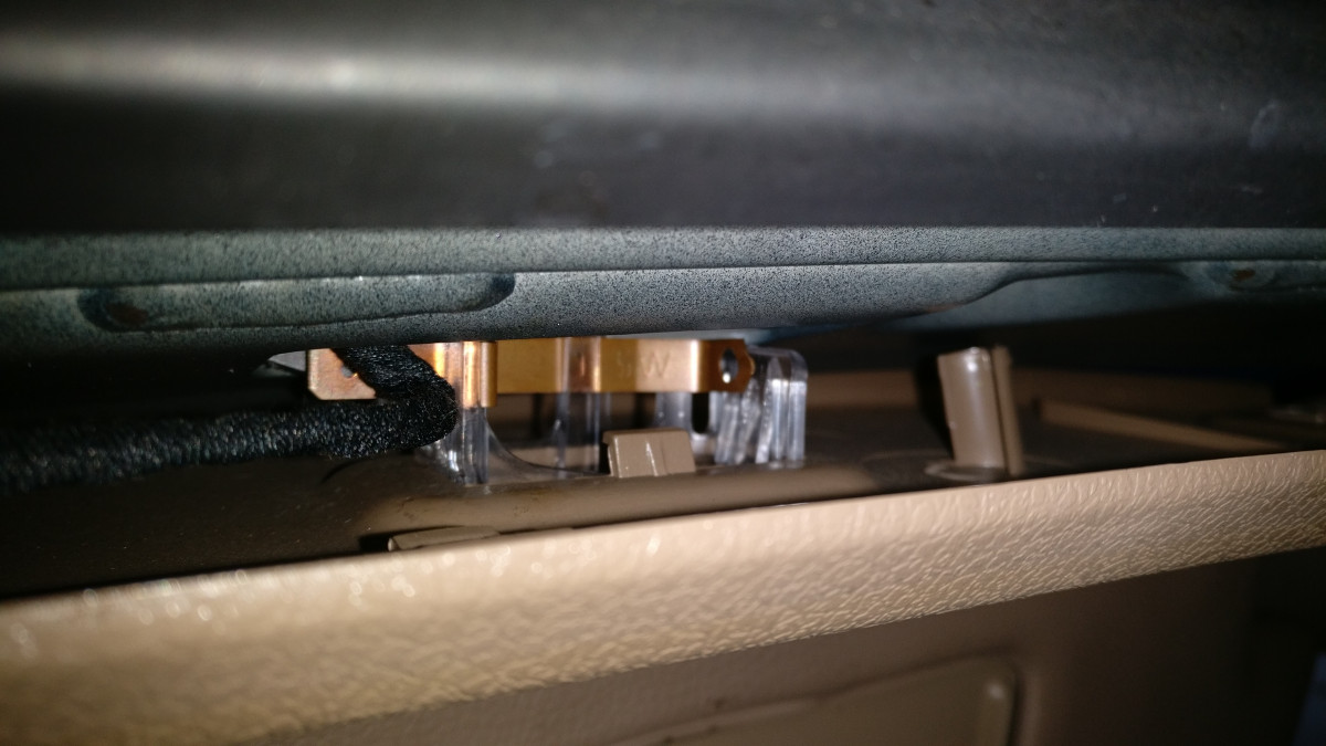

Thanks for the in depth reply. I keep getting held up by the lights themselves. Should the lights pop out of the panel itself, or should they unclip from the attachment points with the car? I've attached a picture.

Mine came out from the car, ie popped out of their rectangle slots, and I also unclipped the little harnesses from the car. So, I had the lights, completely separated from both that panel and the car itself. It is somewhat difficult to get them back in flush with the panel on reinstall.
If I remember right, wiring clips from both vanity lights hook into the main light array next to the rear view mirror. No idea how the mirror is held in place.
