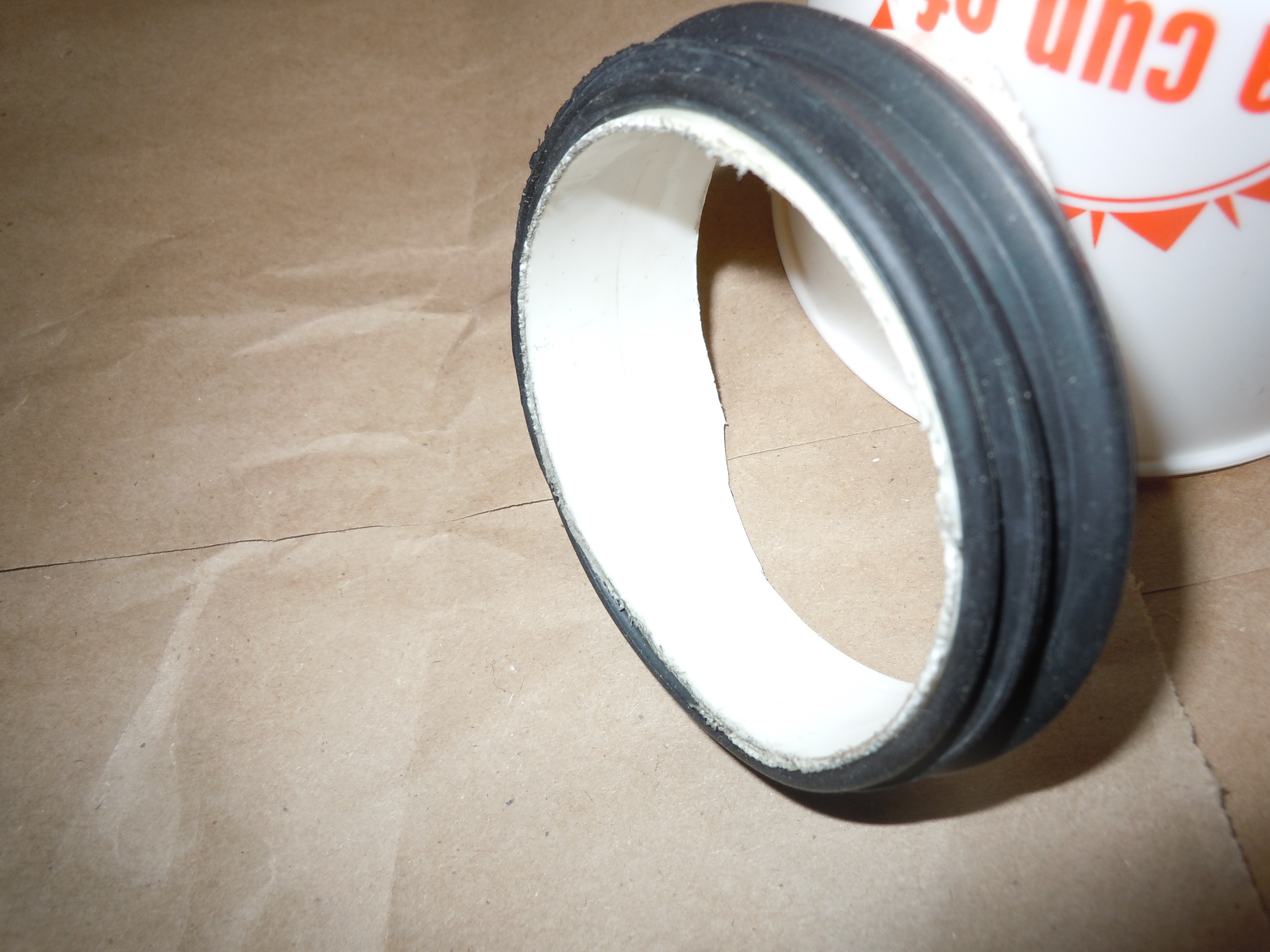

Here it is with a dust boot stretched on: The leading edge of the dust boot has a rim seal that has to seat into a groove just inside the caliper bore. Making sure everything's lubed up with SylGlyde?, you can lead the boot's rim seal off the edge of the stretcher cone and press it into its respective groove (which you have cleaned out with a Dremel and wire wheel)—taking care not to let the rest of the boot slip off the cone.
(The main piston seal is already installed.)
Now the boot is open enough to lead the lubed piston through the boot and into the bore. Using firm pressure, go ahead and push the piston in through the main seal, making sure the boot is not slipping off the cone—if it does the piston will cleave off whatever part of the boot is in the way. You need to get the piston in far enough that the boot will fully slide onto the piston when you remove the cone. It worked well for me.
Caution: If you look carefully at my closeup of the boot on the cone, you can see that the boot got a little scuffed. I just put that one on dry for the picture and probably wouldn't use it.
The last part of the boot installation, is the outer-more rim seal of the boot that slips into its respective groove on the piston.

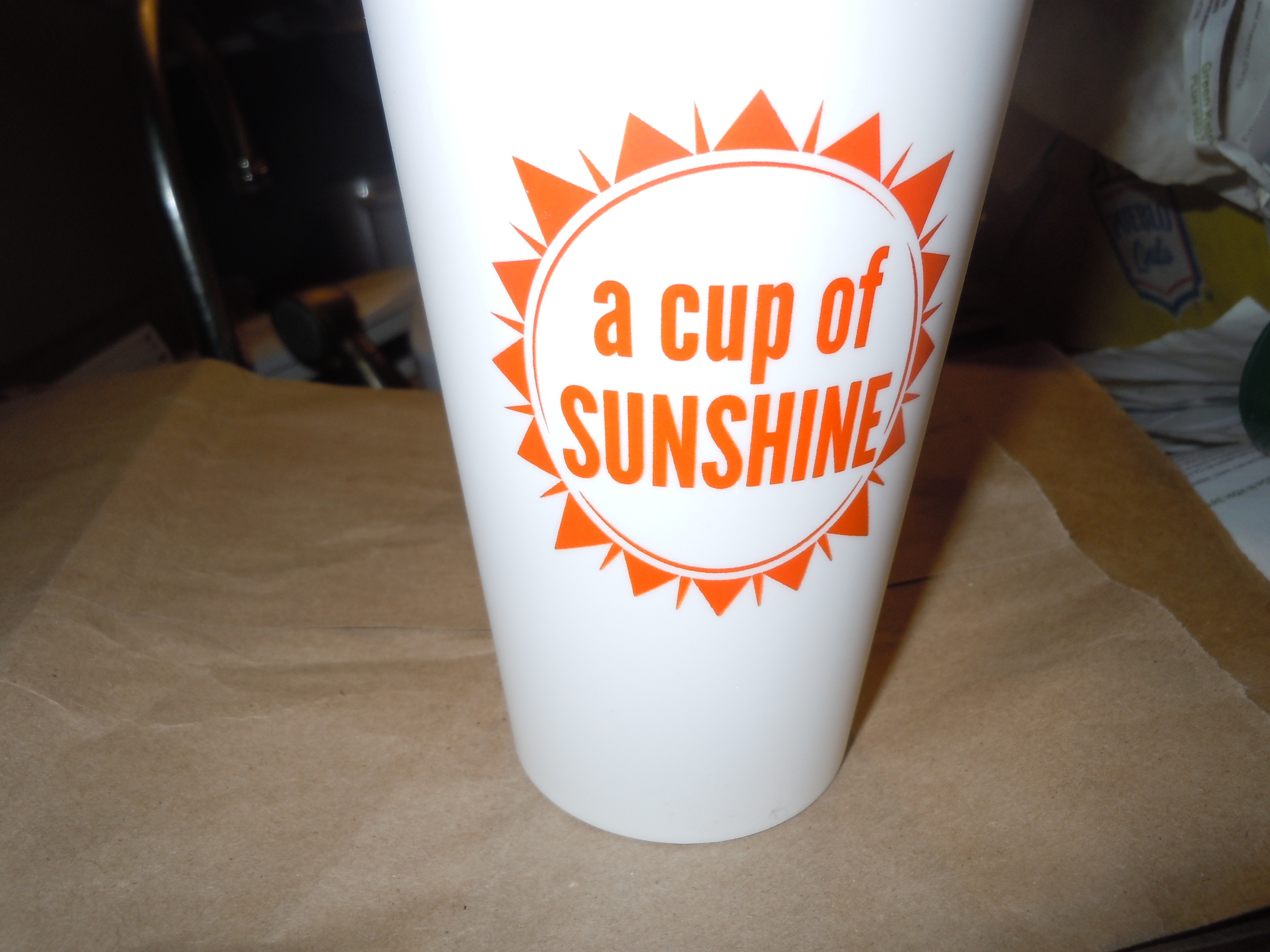

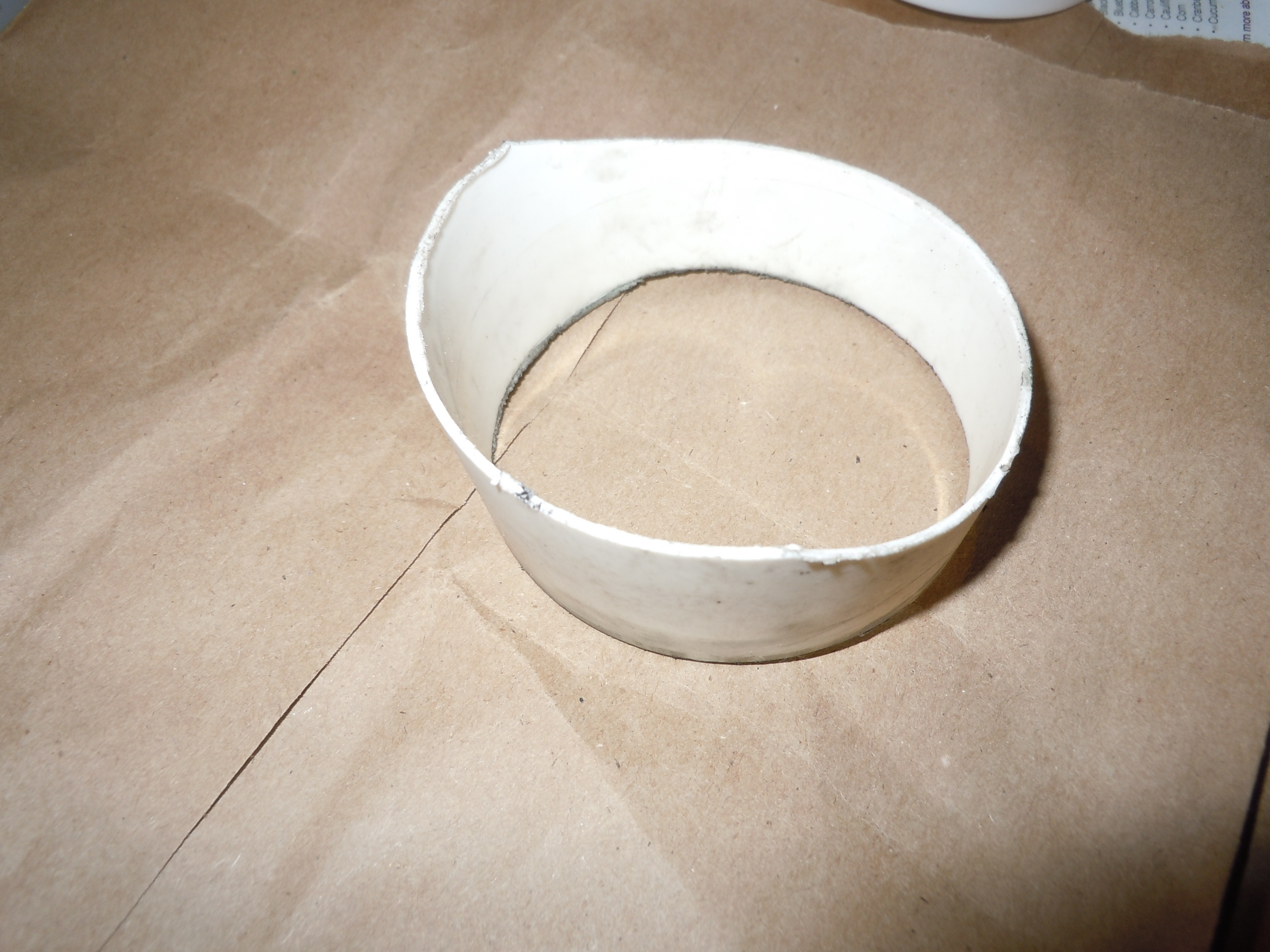

And here's what I made it from: The composite coffee cup looks like maybe a mix of paper and plastic. I tried several plastic cups but they weren't substantial enough to hold the strong elastic force of the dust boot. Dollar Tree sells the one I used: 2 for a dollar.
You have to hold the work piece while you use a fine tooth hack saw to cut out a section. I used a self threading screw and screwed the base of the cup to the face of a 2 x 4, held on edge. Then just saw off the upper part first, finish with the lower part.
You can see that I trimmed down the upper part so the piston could be easily set in the caliper breach.
To scribe the cutting lines around the cup, I stretched a wide rubber band like they use on produce up around the cup then traced a line with a Sharpie around the edge of the band.
