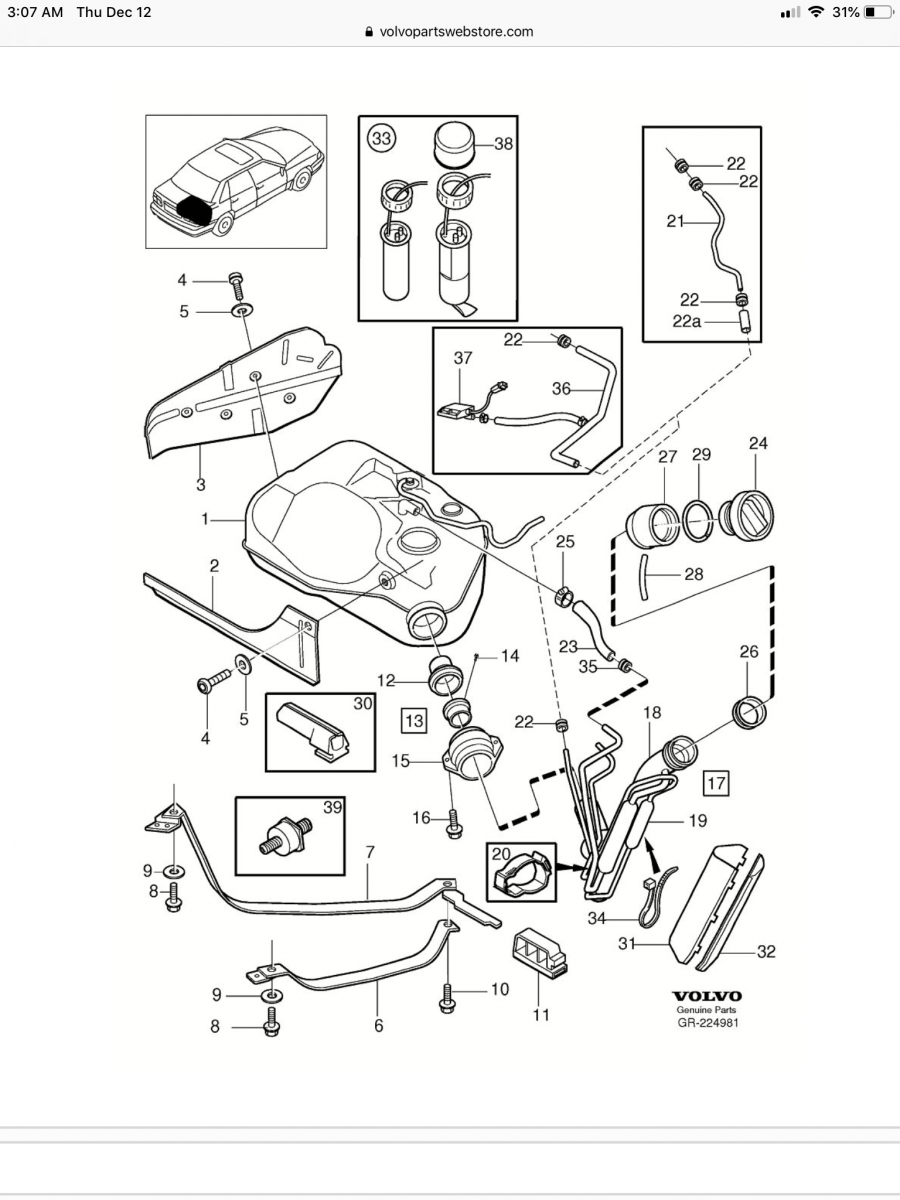

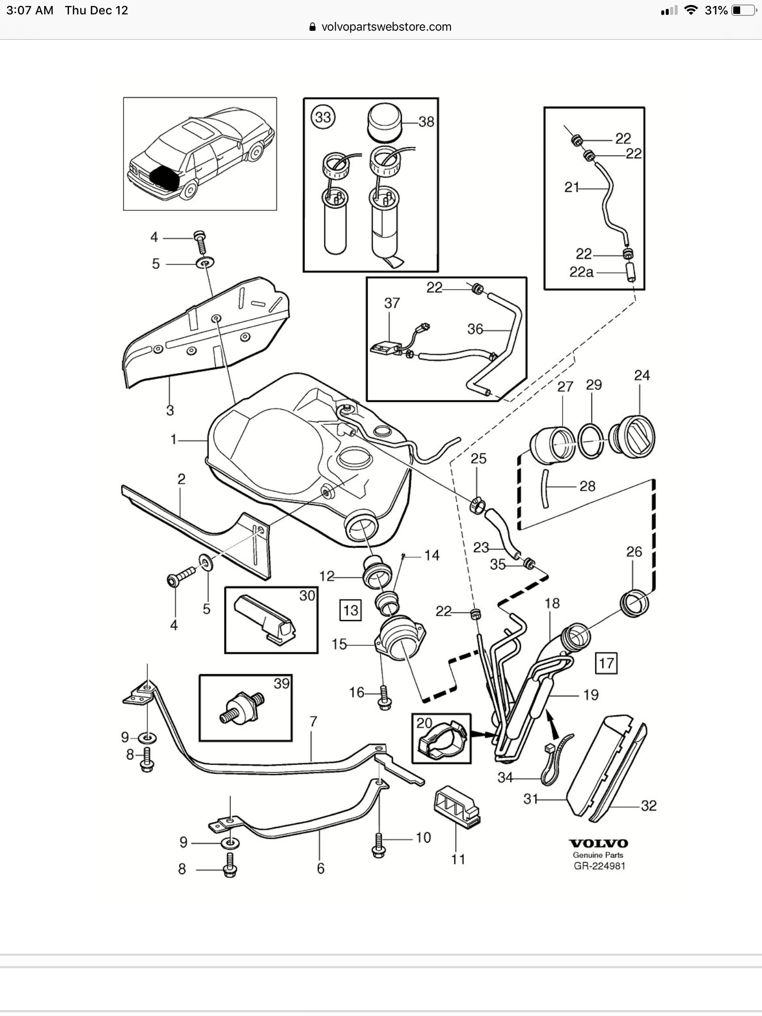

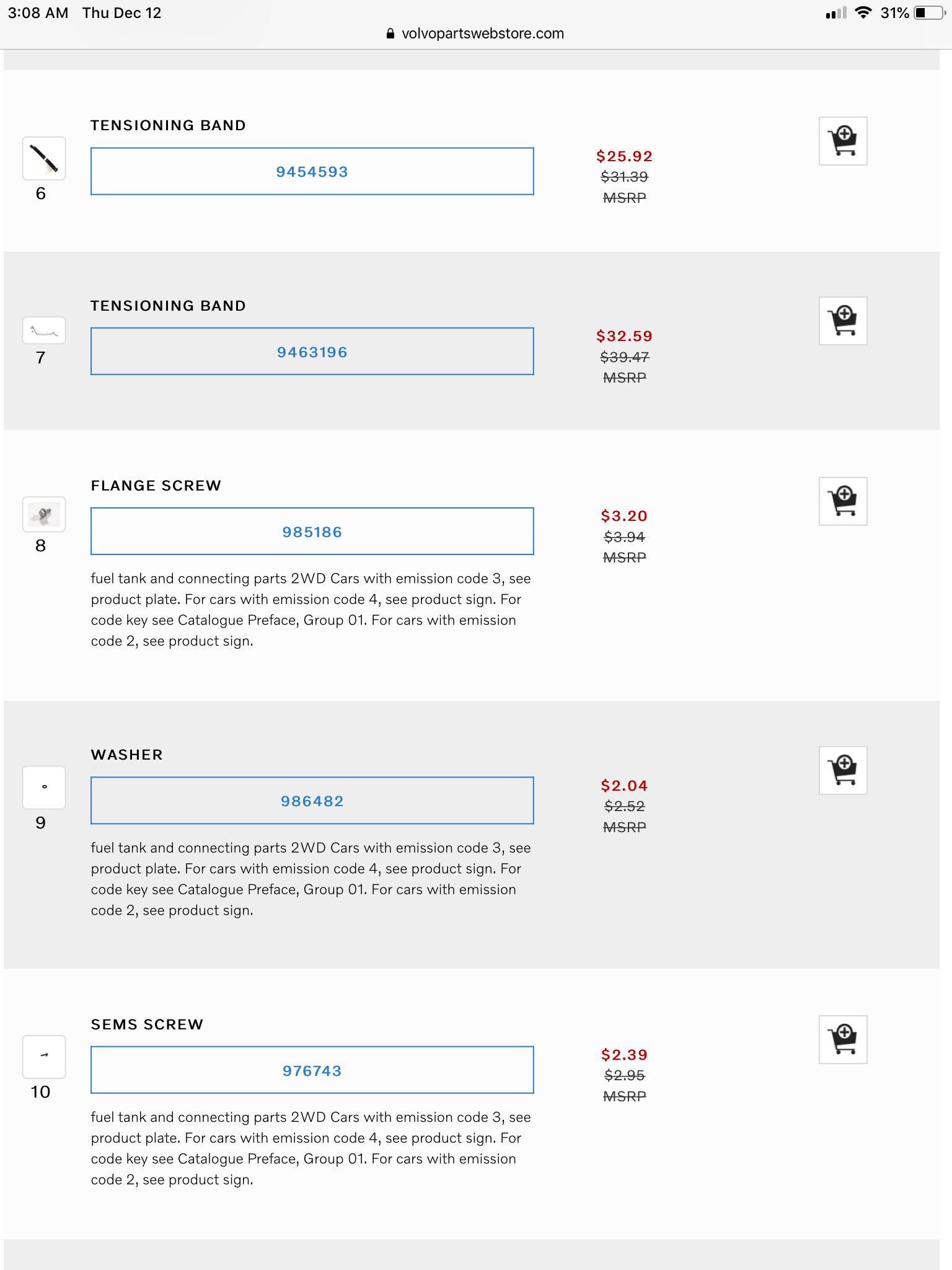

Did you ever figure this out? I am in the EXACT same boat. Gas tank plate is all corroded away and looks the same but there is NO place for straps. I've been searching for part numbers for the gas tank and am having difficulty finding anything. Did find one strap but there is no location to put them. Would love to see a picture of someone's gas tank with the corresponding straps if possible.
- Posts: 36154
- Been thanked: 4071 times
I’ve got the gas tank out of my parts 1998, so I can send pictures, might have parts you need , too.
Just drove out and back to near you, but Cambridge, not Boston
Here are some pictures of that system from the Volvo web store. Both the “gas tank straps” , which translate to “tensioning band” in Swedish , are available new for not too many kroner.
