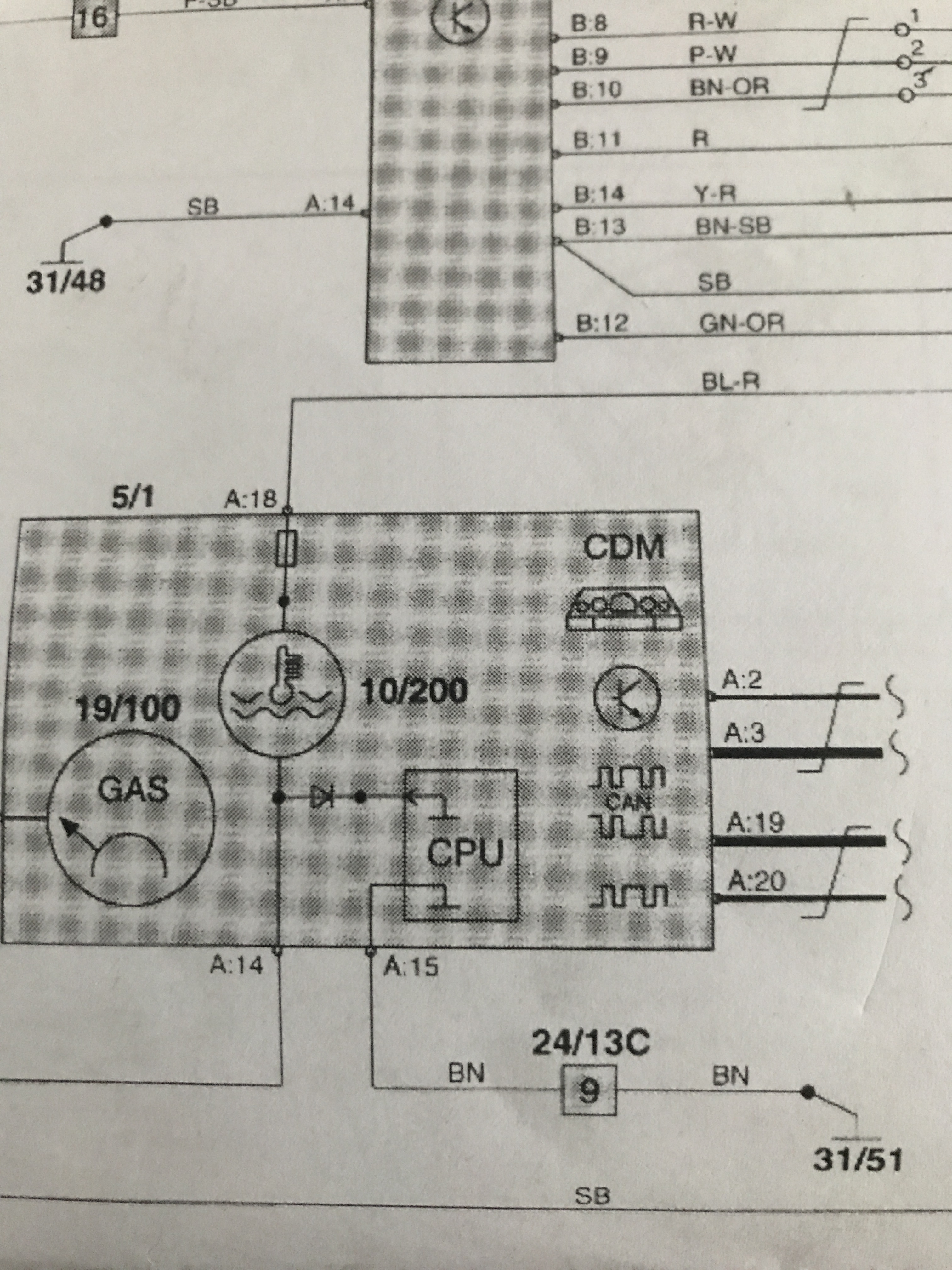

From the wiring diagram - it might be just a generic symbol - but it looks like a square wave signal.
I don’t a graphic meter or oscilloscope to measure for you. But I would think it’s more likely a variable frequency square wave pulse summed directly from the abs sensors.

I have found the following on the CPU schematic:
#B18 Signal speed (from combined instrument panel)
U ≈ Ulowor Ubat (the voltage depends on the position of the front wheels)
f increases with speed f = 40 Hz at 20 km/
But I don't think it is the one used, as, on the ABS schematic,
On the pin 6 of the connector, I see a cable Y-BN with what I suppose it is a connector 24/13C that goes to the A3 input of the dashboard to the speedometer. But no indication of the standard ;-(
