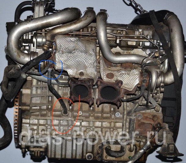

RobSir
Posts: 2
Joined: 17 Dec 2019, 12:33
Year and Model: 2001 S80 2.8 T6
Location: Netherlands
Has thanked: 1 time
Post by RobSir »
Thanks for the reactions.
In case of the XC90, is this also a B6284T engine with a geartronic gearbox attached to it? In my case it is and working from under the car I have to use extentioners the reach the bolts raching between the gearbox and the oilpan. But if this is the best option, I’ll work this way. Do I need to remove parts like heatshields exhaust parts or exhaust heatshield?
Is there anyone with tips or tricks?
HELP HELP HELP NEEDED?
With the exhaust still on
With the gearbox installed
View of oil line when gearbox and exhaust is removed
Blue mark: torx/allen bolts on the turbo. Red marking: oil return line in oilpan.

Post by precopster »
I had a pretty bad leak from the lower end going in to the block on the 2001 T5 and after trying to reseal it 3 times I purchased a new metal tube from Volvo. It must have been slightly bent allowing lots of oil past the o ring and onto the driveshaft.
