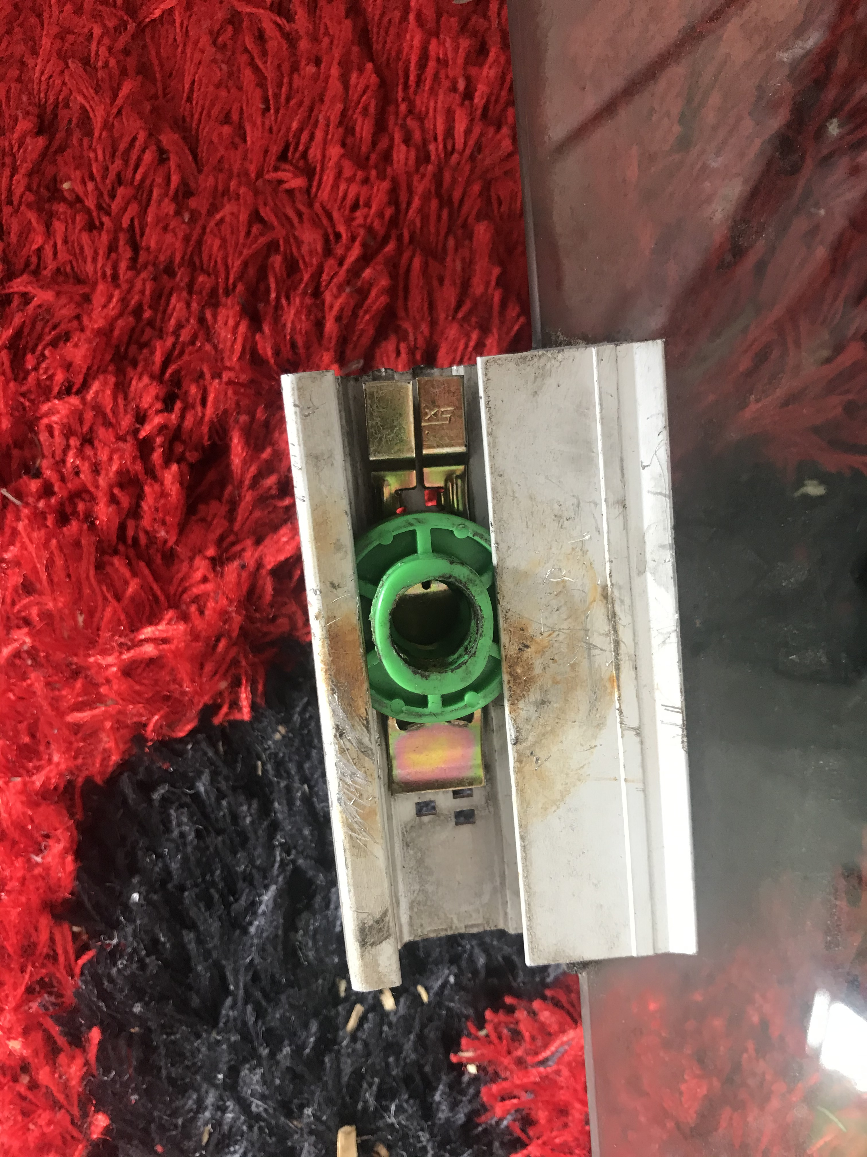

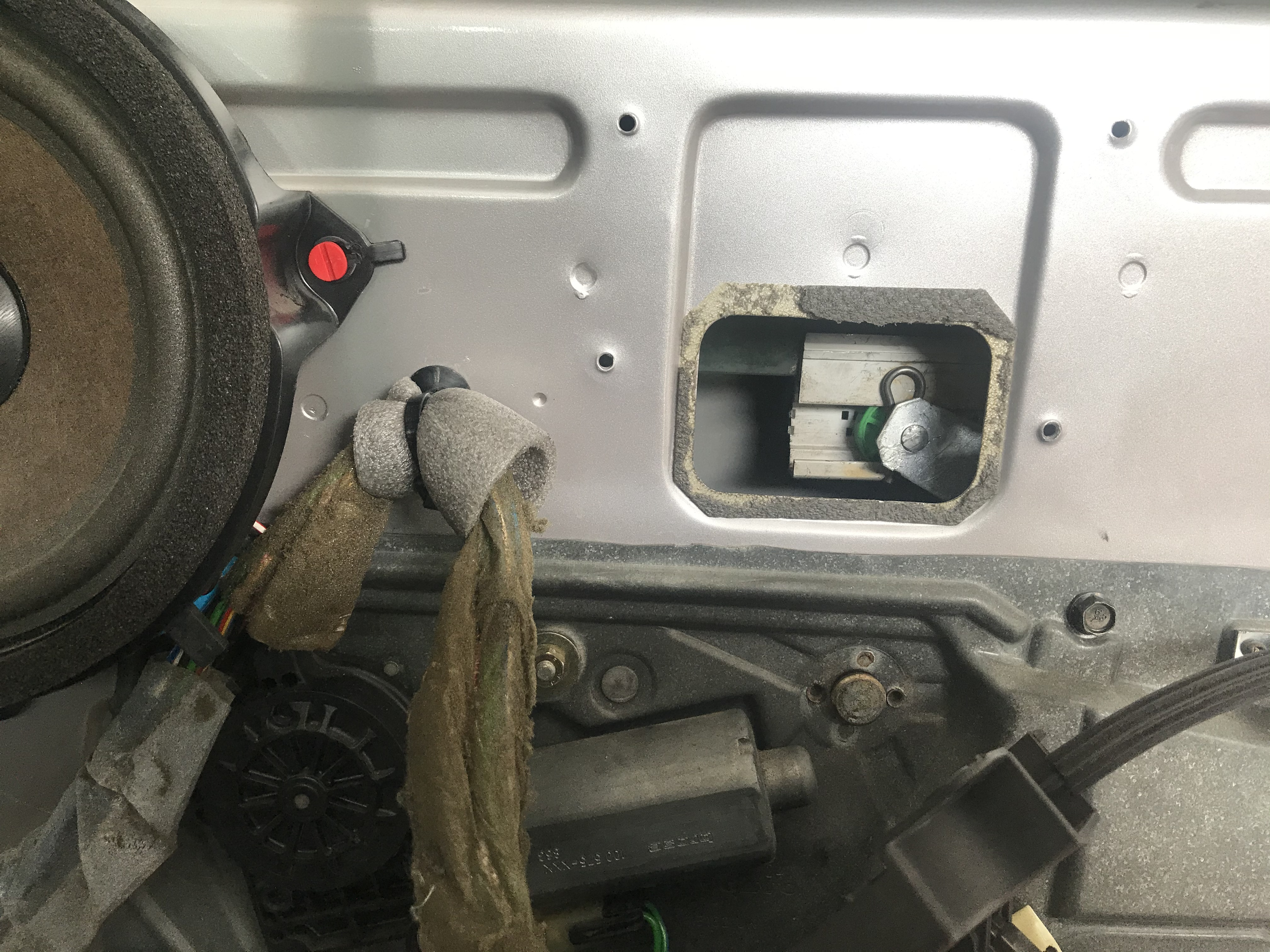

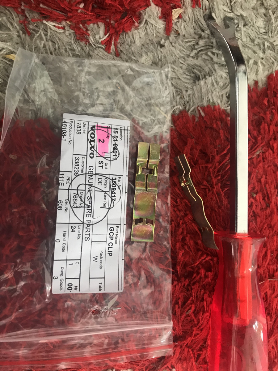

Check the door lifter mechanism, where the green rollers are... You remove the door card, door pull assembly, and the black foam covering the access hole behind it. You may have to lower the window a touch to see the rollers. The front roller should have a bendy piece of copper coloured metal in the roller Chanel under the roller. This slows the front roller causing the the glass to tilt towards the back as it raises, jamming it firmly into the recess. Also check the rollers while your there. I Had the same thing - whistling window- and wouldn’t have noticed that the steel wasn’t there had I not happened to see it lying in the bottom of the door. It has prongs that locate it in the chanel and shouldn’t move much.
Access hole- note missing spring thing
Springy steel thing
Springy steel thing
New part
New part
1998 S70 10v BiFuel - Sold
