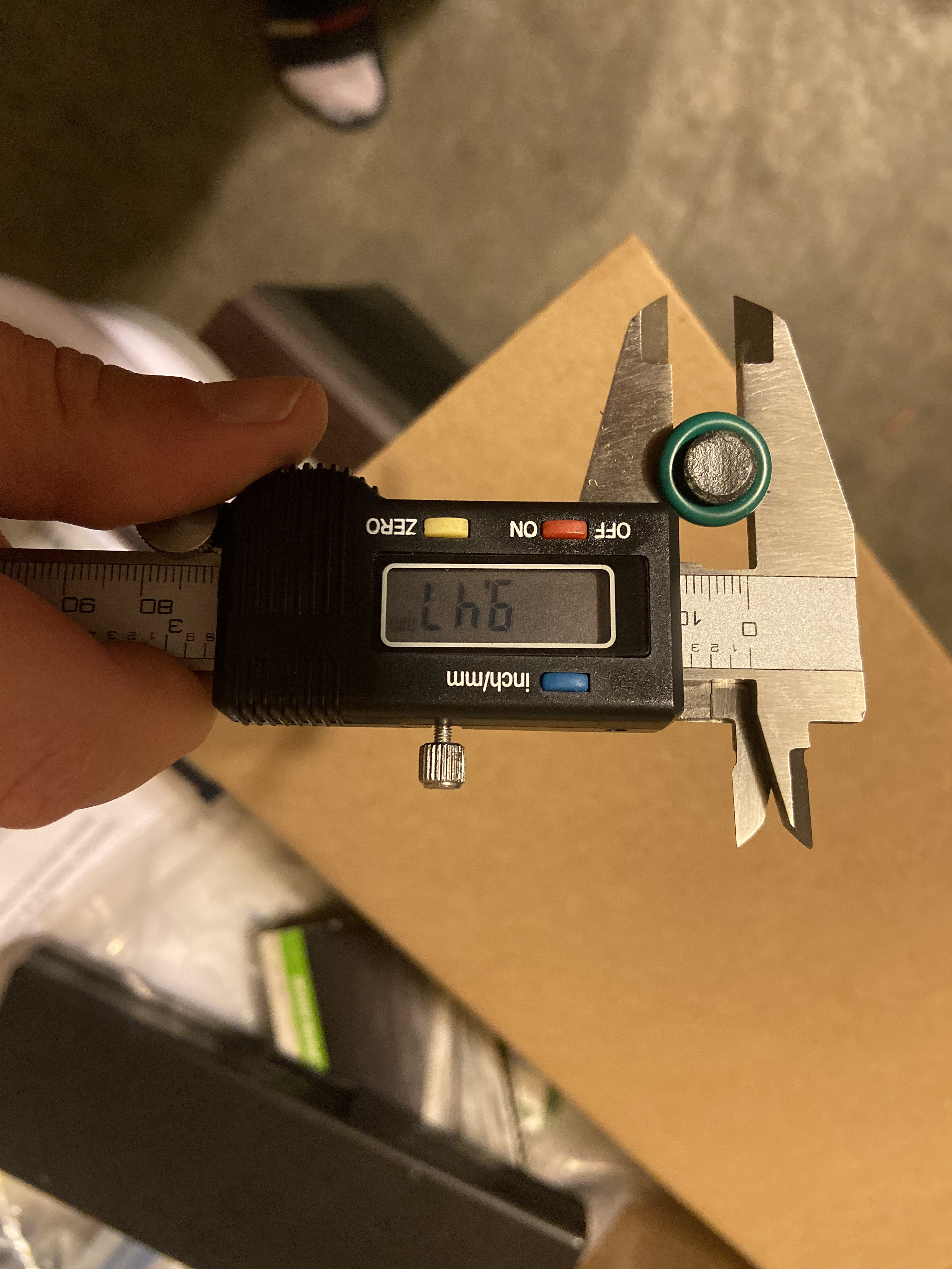

Here are the sizes for the O - rings as measured by my calibrated calipers
Green
I.D. 9.5 mm (.374")
O.D. 15 mm (.591")
Thickness 2.9 mm (.114")
Brown
I.D. 7.5 mm (.295")
O.D. 14.5 mm (.571")
Thickness 3.5 mm (.138")
I haven't found an aftermarket source
But as shown in the picture the O-rings can be bought from Land Rover Part number LR003579
If someone knows the correct Volvo part number please post it here for reference
Thanks
Paul
