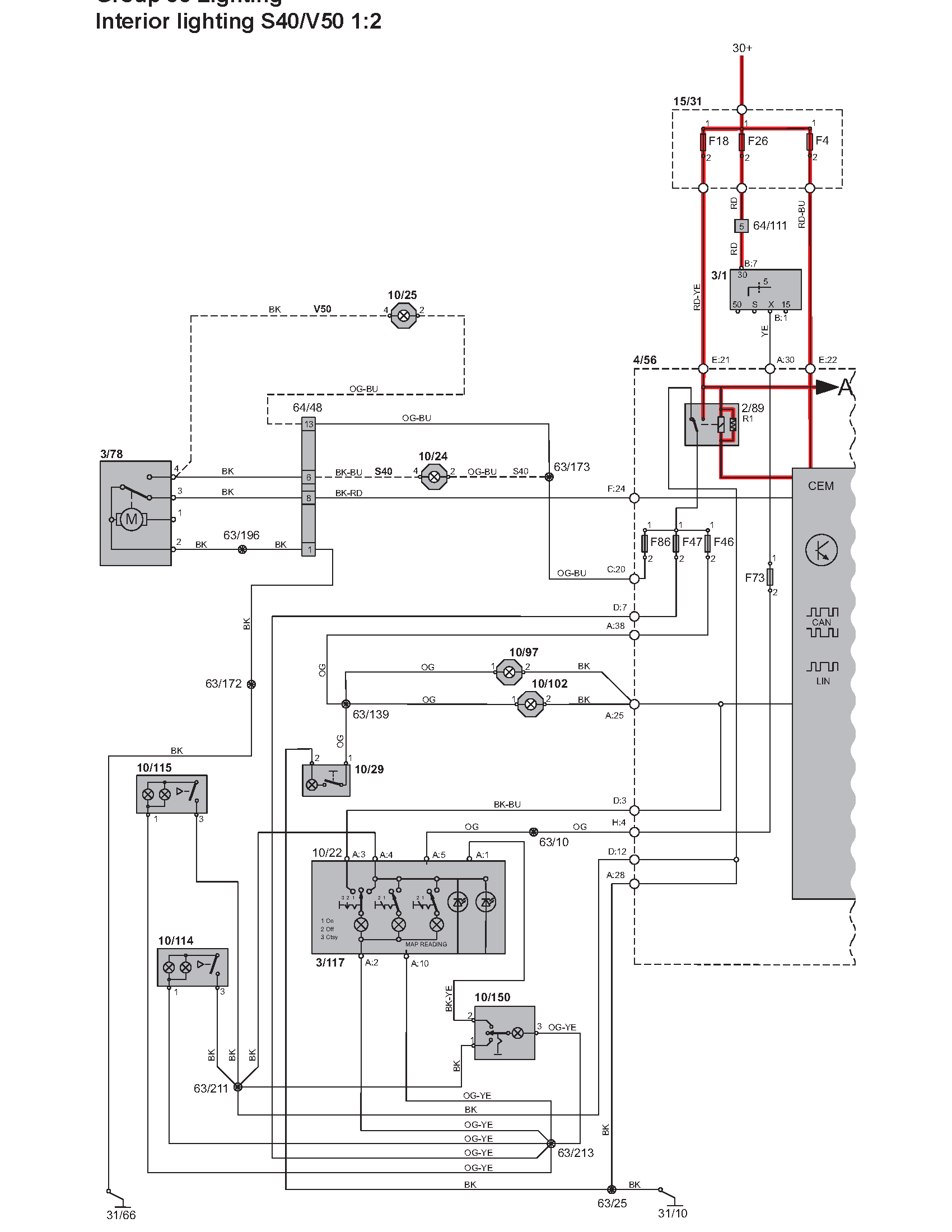

10/24 = Cargo compartment lighting.
3/78 = Lock unit, trunk lid/tailgate. (This grounds the Cargo light, turning it on)
Try grounding the Black-Blue wire on the Cargo light, see if it lights up.

10/19 = Third Brake Light.

Thanks for quick reply and diagrams, yes very helpful will check and get back to you, couldn't understand where the switch for cargo light was but is clear now.

Could be the Rear Dome/Cargo light wiring for a V50 (10/25). Do the wire colors match the colors for 10/25 ?S40volvo2007 wrote: 07 Jan 2020, 14:54 I also found this wire loose next to the light (attached picture) not sure if its related?
You might want to check the ground on the third break light.

Grounded the cargo light like you said and yes it does light up.

There are only four things it could be.S40volvo2007 wrote: 09 Jan 2020, 04:08 Grounded the cargo light like you said and yes it does light up.
1. Black-Blue wire between the lamp and connector 64/48.
2. Contacts in connector 64/48.
3. Black wire between pin #6 of connector 64/48 and pin #4 of 3/78 (Lock unit, trunk lid/tailgate).
4 Internal switch in 3/78 (Lock unit, trunk lid/tailgate).
You can determine which is defective by moving your grounding wire down the line.
1. Ground the Black-Blue wire at pin #6 of the connector. If the lamp lights the Black-Blue wire is good.
2. Ground the Black wire on the other side of connector pin #6. If the lamp lights the connector contacts are good.
3. Ground pin #4 of 3/78 (Lock unit, trunk lid/tailgate. If the lamp lights the Black wire between pin #6 of connector and the lock is good.
4. If three above are good all that remains is the internal switch in 3/78 (Lock unit, trunk lid/tailgate).

So I moved the ground down the line and heres what happened:
Connectors were good pins were fine
when i moved the ground to the pin on the lock nothing so between the lock and connector there was a fault
I have removed the wiring harness and there were 3 broken wires and they are all black and i had no measurement instrument with me lol.
Luckily one of them was thicker so that helped me. The other ones were alarm i think and boot light.
I decided to replace the whole wiring harness and guess what the light was working but evenwhen the boot was shut.
I took out the locking mechanism and inside i found the microswitch when tested it was faulty.
Since i did not have one lying around I decided to use wd 40 and basically soaked it, minute later was working fine. So thanks first problem solved I guess it was a series of issues but I am glad its working now keeping an eye to make sure it cuts when boot is closed though.

Ground pin #5 on the third brake light, see if it starts working.
Take some pictures of the connector on the third brake light. I cannot find anything for pins 2 - 4 but it looks like there should be a power line.
