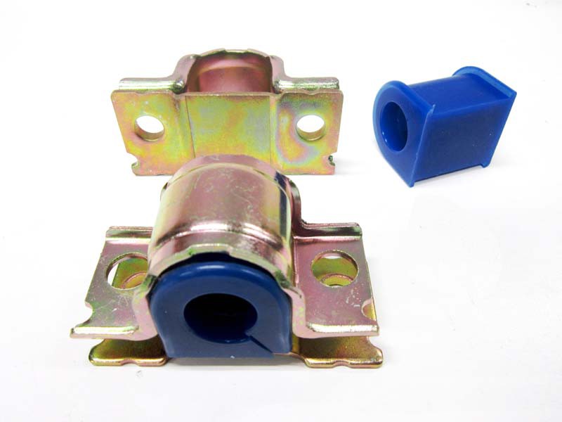

Ah sorry. I said pu. Thats how we call polyurethane. So yes, they are poly and come with brackets and are availlable in 20, 21 and 21,5 mm. So three sizes like you said.
I added some pictures of the set.

I checked parts stores and some youtube movies a bit. Just for sake of arguement. What about just changing the inserts with the poly versions? I read somewhere that should make old bushings like new. Seems like a bold statement though

I replaced the bushings on my R front bar when I installed it on my '96 GLT. They were just some Energy Suspension pieces.
Took the old bushes off the bar, cleaned up any leftover bushing residue off, and installed the new bushings.
I already had the subframe out, as I was replacing the clutch in the car, when I did mine.
