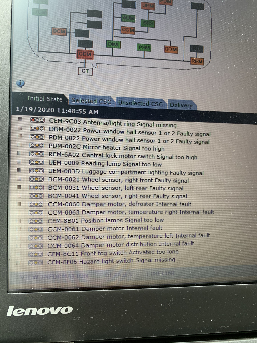

Hooked up VIDA;
Verified blend door motor request and actual value, they match
Interior temperature is reporting 20 degrees C , a bit too high.
Fan speed
Calibrated the CCM. No fault codes stored.
Cleared all codes ( ccm-0060, 0063, 0061,0062,0064 where present) but did not return, did did not resolve the issue.
I am planning on cleaning the fan behind the temperature sensor and see if any thing on top of the blower fan is blocking the flow. Other than that I am running out of ideas and looking for other suggestions.
Attached the codes before clearing.

Try to calibrate CCM first. Can be done in VIDA that you have.
What has happened to the car? Why does it have so many communication failures? Is it a weak battery and long starter cranking? That can brick the car, FYI.
