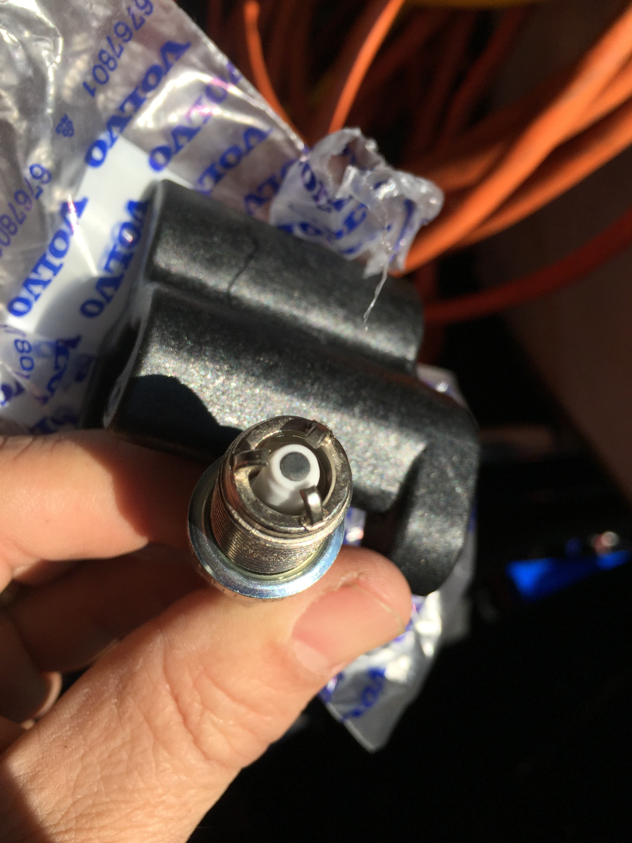

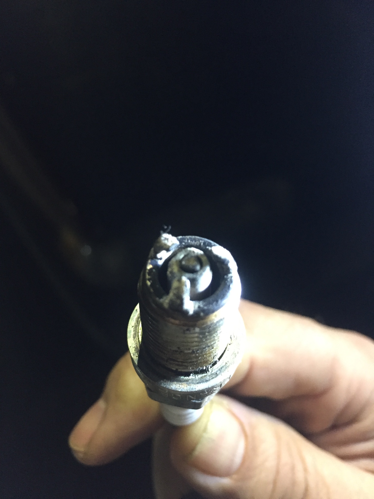

Well, we kicked butt today
Diagnosed a noisy power steering pump, defcon 3....monitor closely for changes in noise
Part options
RockAuto $60-125 with core
FCP $190 with core
PnP $30
Evaluated cooling group, hoses look old , defcon 4
Need timing belt job, now at 220k, last done 140k, so due up, defcon 3
Need plugs, distributor cap, rotor defcon 4. Plugs quite worn
Clean up main B+ terminal at starter
Distributor cap Bosch $35 3501944
Rotor Bosch $25 1367783
5 3 prong Bosch plugs $20. FGR7DQE+
Battery clamp. Free
( picture)
