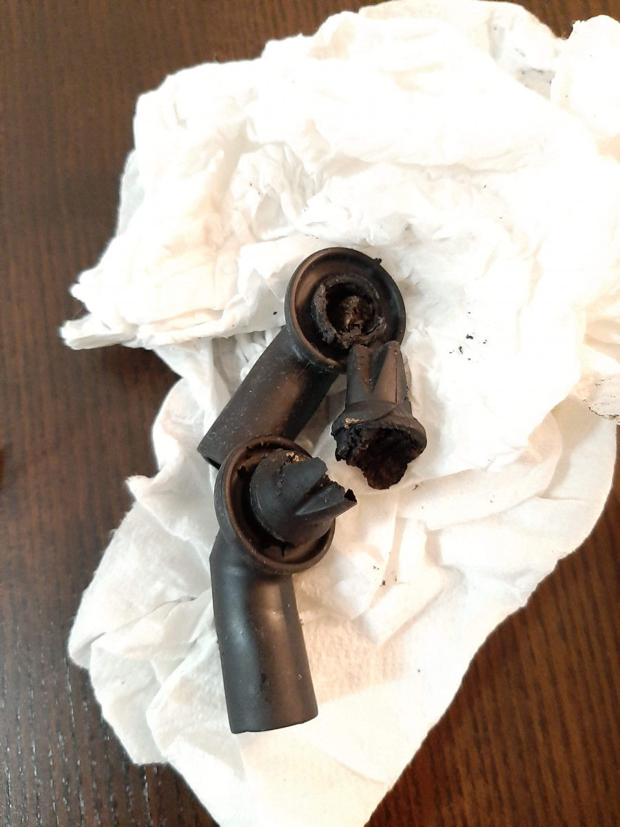

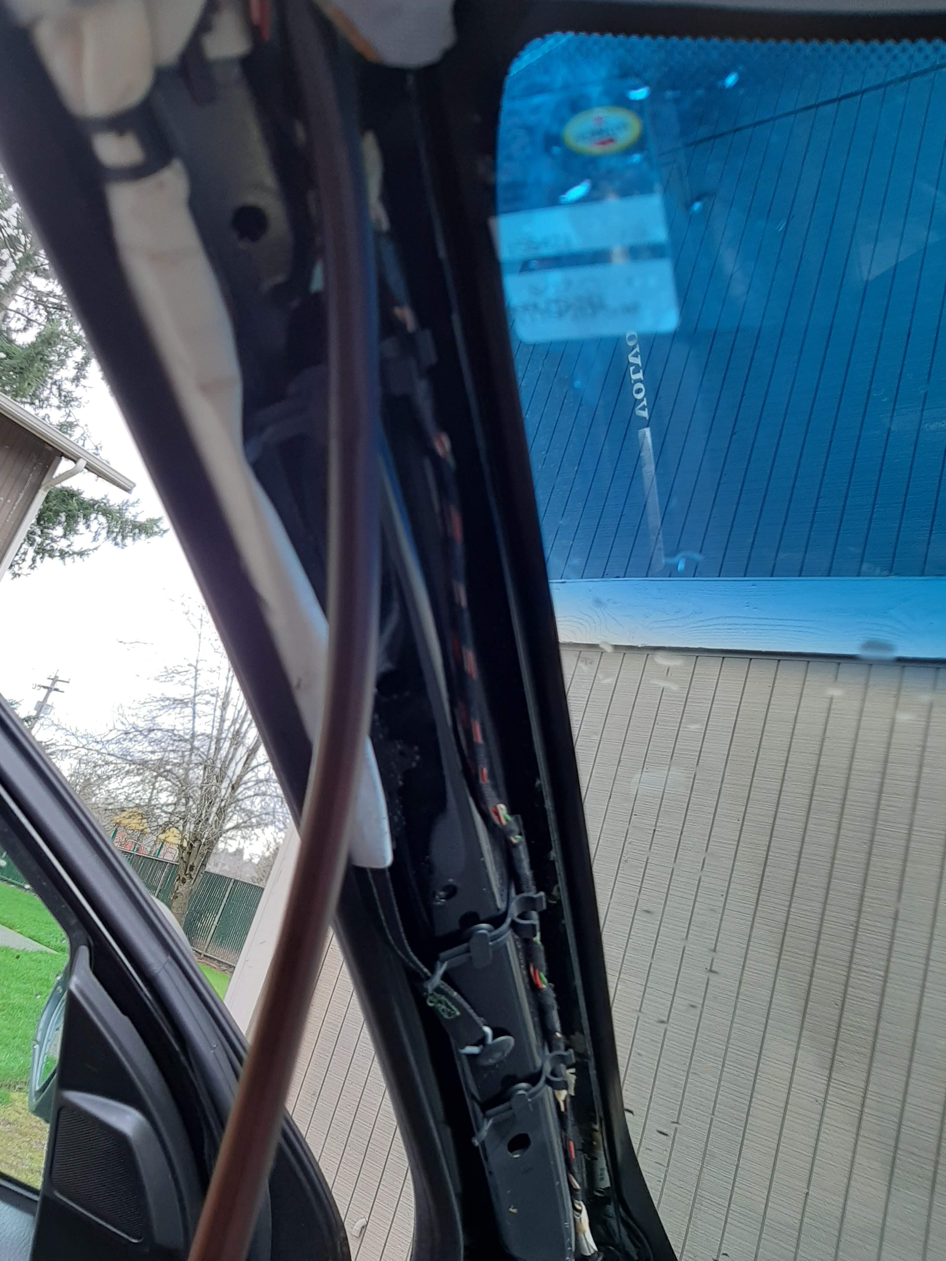

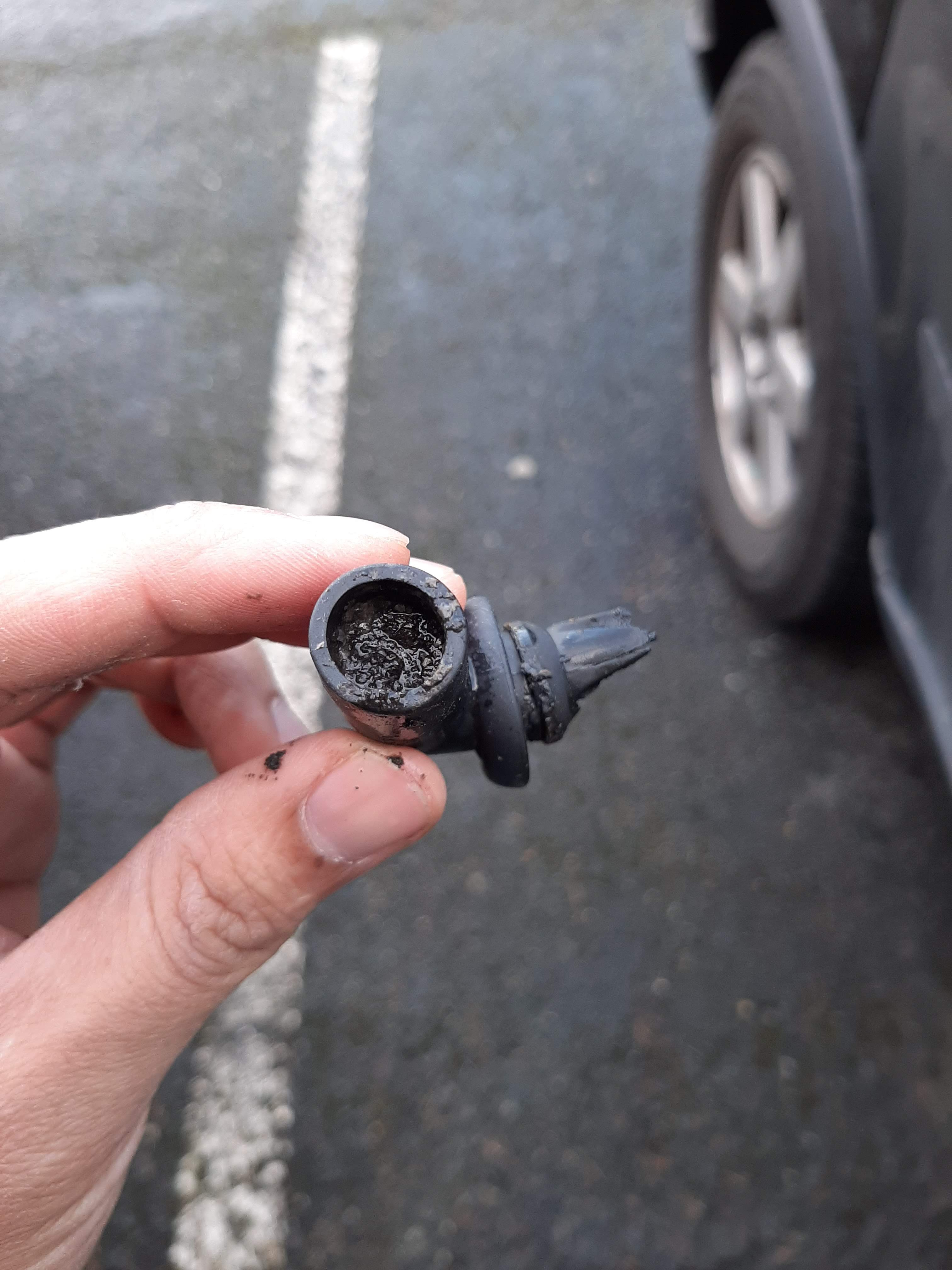

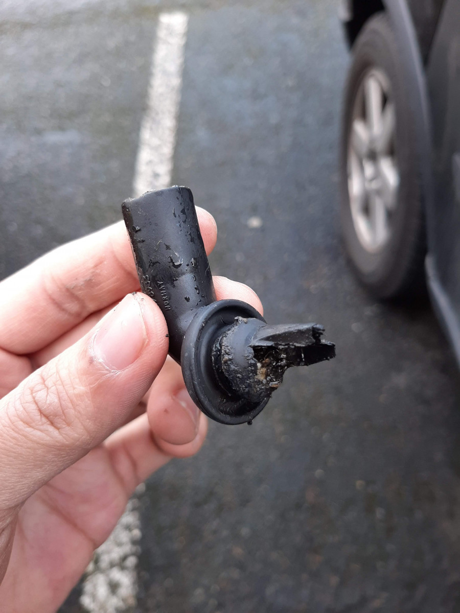

Hi,
I found issue with the sunproof's exhaust water pipe, the end of the pipe was broken .
And many things inside the water pipe, like small tree branches, leaves, and many dirts.
How dirty of the both pipes, as you can see from the color, dark brown !!!
Cheers,
/Benny

Good find. Like I said in some videos, be aware that this will happen even on cars that never open the sunroof. As they get old, the gasket around the sunroof glass is less flexible and allows water to pass by and into the sunroof tray beneath. The problem is inside the big cities rains comes down with a lot of dust/dirt, which also gets past the seal and within months or years it ends clogging the drain tubes.
