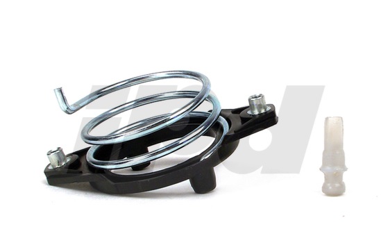

Item #1 this is the overdrive pulley - one way clutch
Item #2 - AC compressor
Item #3 - Belt Tensioner
Item #4 idler pulley (spins freely in both directions no clutch)
Item #5 - Water Pump
Item #6 - spring coupling between water pump and power steering pump
Item #7 - Power steering pump
