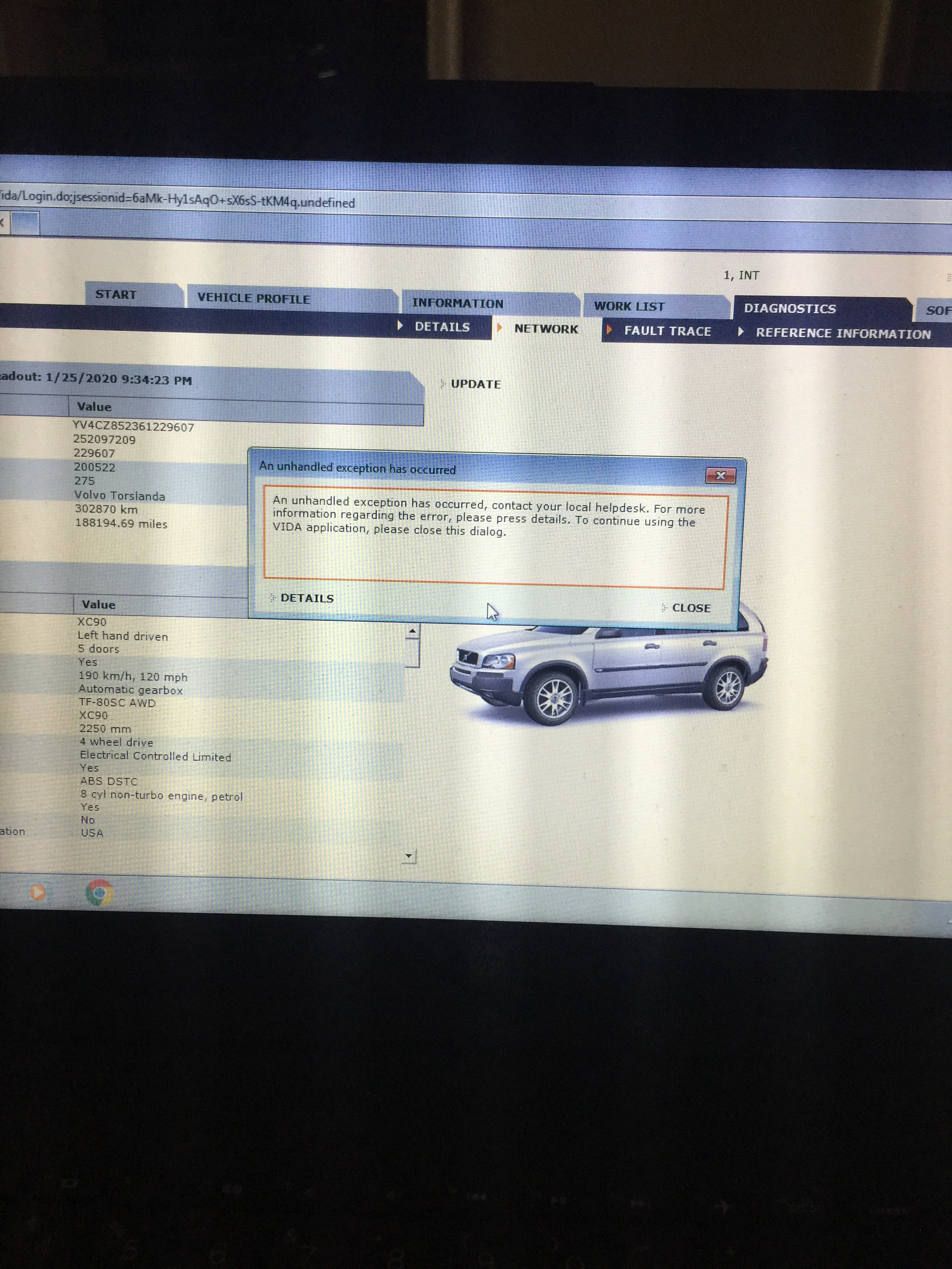

Vida software won't let me diagnose the car.
- RickHaleParker
- Posts: 7209
- Joined: 25 May 2015, 14:30
- Location: Kansas
- Been thanked: 980 times
Click on [Details]
Active
Past
Past
This is what it says:
System.Runtime.InteropServices.COMException (0x80040154): Class not registered (Exception from HRESULT: 0x80040154 (REGDB_E_CLASSNOTREG))
at System.Windows.Forms.UnsafeNativeMethods.CoCreateInstance(Guid& clsid, Object punkOuter, Int32 context, Guid& iid)
at System.Windows.Forms.AxHost.CreateWithoutLicense(Guid clsid)
at System.Windows.Forms.AxHost.CreateWithLicense(String license, Guid clsid)
at System.Windows.Forms.AxHost.CreateInstanceCore(Guid clsid)
at System.Windows.Forms.AxHost.CreateInstance()
at System.Windows.Forms.AxHost.GetOcxCreate()
at System.Windows.Forms.AxHost.TransitionUpTo(Int32 state)
at System.Windows.Forms.AxHost.CreateHandle()
at System.Windows.Forms.Control.CreateControl(Boolean fIgnoreVisible)
at System.Windows.Forms.AxHost.EndInit()
at Vcc.Vida.DiagSwdl.UI.Components.NavImage.init()
at Vcc.Vida.DiagSwdl.UI.Components.NavImage..ctor()
at Vcc.Vida.DiagSwdl.UI.Diagnostics.NetworkForm.InitializeComponent()
at Vcc.Vida.DiagSwdl.UI.Diagnostics.NetworkForm..ctor(IWorkshopSession workshopSession, INetworkFaulttraceWF networkFaulttraceWf, IAdvancedWF advancedWf, IInfoElementsRepository infoElementsRepository, String currentCommToolName, ICarComRepository carComRepository, CarStatus carstatus, IDiagnosticSessionWF diagnosticSessionWf)
at Vcc.Vida.DiagSwdl.UI.Diagnostics.DiagnosticManager.GetNetworkForm()
at Vcc.Vida.DiagSwdl.UI.Diagnostics.DiagnosticManager._networkStatusButton_Click(Object sender, EventArgs e)
at System.Windows.Forms.Control.OnClick(EventArgs e)
at Vcc.Vida.DiagSwdl.GuiComponents.FlatButton.OnClick(EventArgs e)
at System.Windows.Forms.Control.WmMouseUp(Message& m, MouseButtons button, Int32 clicks)
at System.Windows.Forms.Control.WndProc(Message& m)
at System.Windows.Forms.Control.ControlNativeWindow.OnMessage(Message& m)
at System.Windows.Forms.Control.ControlNativeWindow.WndProc(Message& m)
at System.Windows.Forms.NativeWindow.Callback(IntPtr hWnd, Int32 msg, IntPtr wparam, IntPtr lparam)

Olsi wrote: 27 Jan 2020, 20:55 This is what it says:
Something is not correct in the registry entries. The first one is a communication error. Try reinstalling the Dice software, Vida Media:\3PP\Products\DiCE\
Go to Vida Media:\Install\Utils\ You will find the other Windows Registry files, run them if reinstalling DiCE does not fix the problem.
If you run the EnableIEHostingxXX.reg make sure you run the correct one for your operating system 32 bit vs 64 bit.
