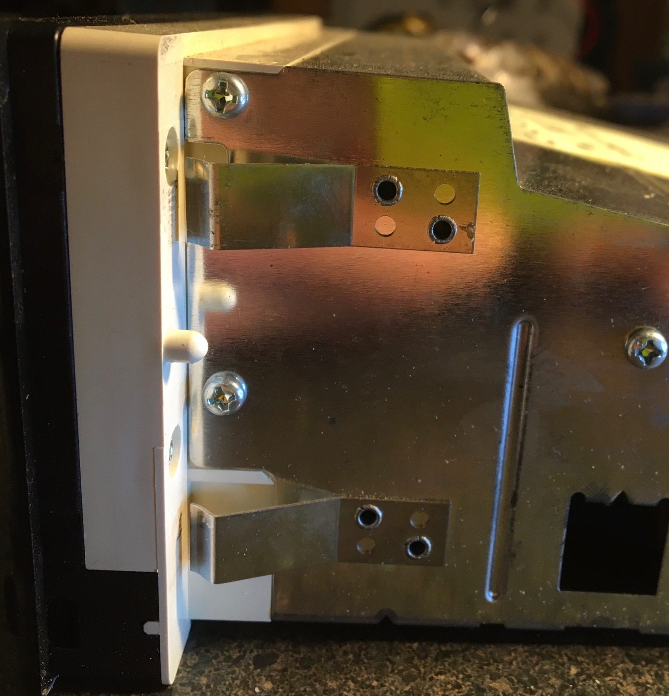

The ECC is held in place by tension from four band springs, two each side. My best guess is cold weather has caused the space between the springs and the frame to contract and tighten up. You might try placing a electric space heater in the cab and let everything warm up.
Watch the video, you will see the springs on the side of the ECC when Robert sildes the ECC out.
Good views of the springs after 2:38.

There is also a white pin on each side of the ECC unit that slots into a hole in the face of the opening.

Thanks to all who've replied. I received my replacement unit and it looks just like image provided by jreed. I tried the heat method recommended by RickHaleParker, with a space heater and a hair blower, got the temp inside up to high 70's F, used the hair dryer for direct heat application, then tried to push it out toward the rear of the car as mentioned by abscate. BTW, that's how I've been trying all along, but it's not budging. I think I'll be removing the top of the dash to see what's hanging it up. I tried some metal putty knives, going in through the opening left by the radio, trying to slide them in along the sides to depress the side bands, but that's really awkward and so far no luck.

SUCCESS!!!!!! Last night I tried again to remove the ECC Unit by pushing / pulling it toward the rear of the car , this time more forcefully, and heard what sounded like plastic cracking, at which point I stopped. The unit did not appear to have moved from it's position, so I decided to remove the dash the following day.
Once the dash was out I tried to see the retaining tabs on the passenger side of the unit. It's wasn't easy to see them, but I saw enough of them to work with. I used a long flat blade screw driver and worked it into the area to place it against the top passenger side tab and pushed against the tab while reaching behind the unit and pulling / pushing the unit toward the rear of the car. The top passenger side of ECC unit began to come out slightly, but the lower tab was still holding. I moved the screw driver down to the lower tab, repeated the process, and the right side popped out a little more. I then positioned the screw driver on the driver's side of the ECC unit, again from the top and, with limited clearance, was able to see enough of the tabs to press against them. I pressed the top tab first while grabbing the unit and pulling on it. The entire unit then popped free and I disconnected the wiring. Once the unit was completely out I looked at the tabs, comparing them to the replacement unit and saw no differences. I don't know why the original unit was so difficult to remove, but it's been in there 24 years so maybe the metal tabs were losing their spring effect. I'm thinking about using some silicone grease on the tabs of the replacement unit before I install it.
I wonder why the original ECC Unit failed, I might open up the housing and look for capacitors that might show signs of damage.
Update: The reason I replaced the ECC Unit was because of the blower running at full speed when the key was in the on position, so whenever the car was running the blower was full blast and could not be controlled by the ECC. When the engine was off, and key was off, the blower stopped. I replaced the Blower Motor Resistor earlier, which did not correct the problem, so the ECC Unit was bad.
I replaced the dash, reconnected everything and turned on the key, problem is fixed I tested the replacement ECC Unit and now my controls are working properly.
