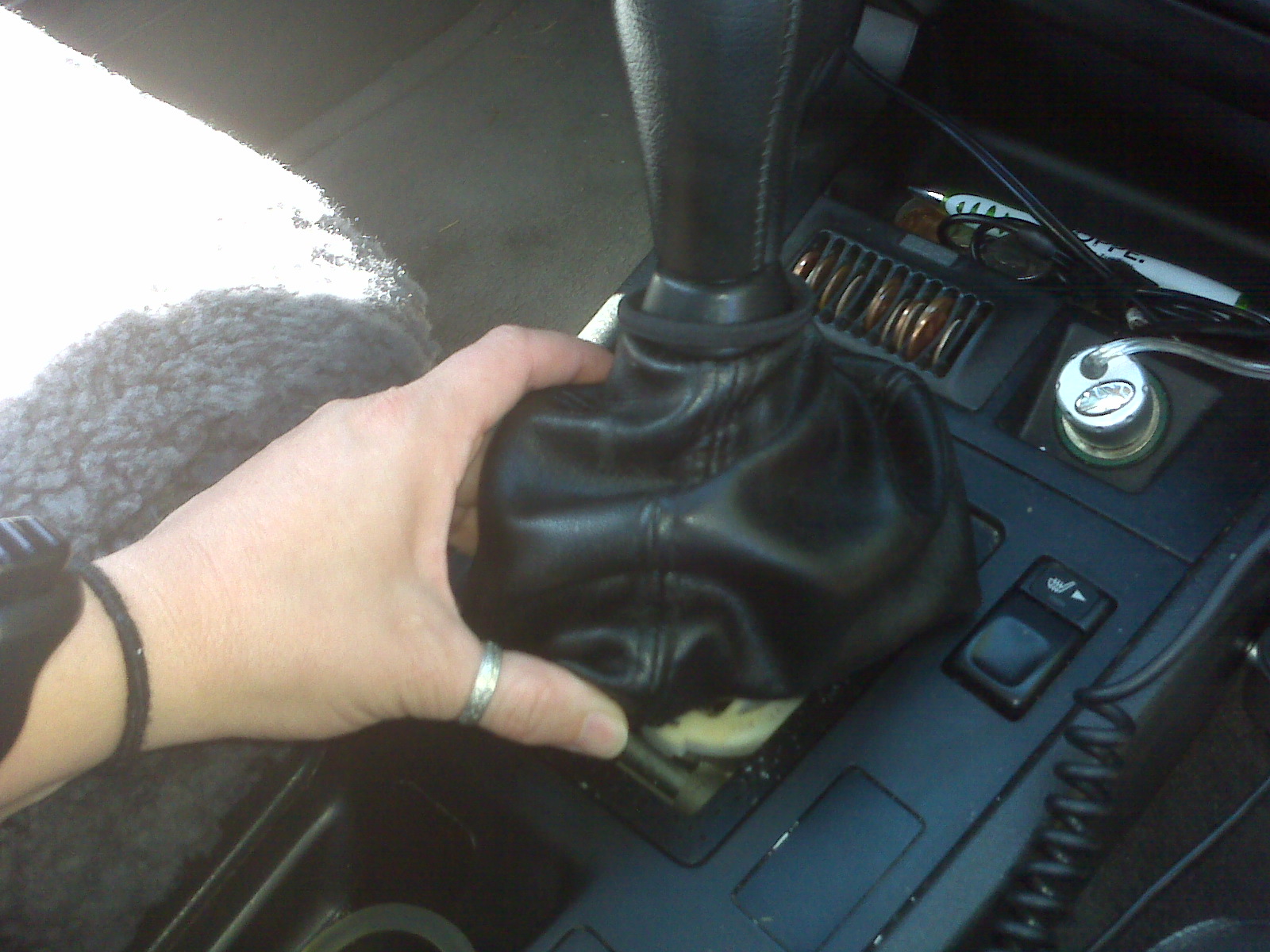

Hello there! I've searched the Internet and haven't found an answer, so I thought I'd ask my fellow Volvo drivers. I have a 1996 850 wagon with a manual transmission. Mechanically it's fine, but the plastic piece that holds the gear shift boot down to the center console has broken and now the boot isn't attached to the console (see attached photo). I've tried to find only this plastic piece or even a whole new leather boot with that plastic piece attached, but have been unsuccessful. Even without that I don't know how to take the gear shift apart without breaking it. I've tried to find a service manual with blow up drawings that might help me get the gear shift apart, but can only find Haynes or Chilton's, and not the actual parts manual I want.
Can anyone direct me toward a parts manual or directions for how to take apart my gear shift? Thanks!

At long last... success! I had hoped that I could replace the boot and reuse the shift knob, but after I finally broke down and went to a Volvo dealership, I decided that I should just order a new shift knob too since I would have to destroy the old one to get it off (it's held on because it locks into a groove on the metal gear shift, so it's not removeable or reuseable). I ordered part 6801666-6 (Boot or gaiter) for $56 and 6814305-6 (Gear shift knob) for $54. It took just one day for the parts to arrive. The parts people were also kind enough to print out the VADIS instructions for me, which I'll include here and supplement with my own details.
1. Cut off the outer casing on the knob with a knife. (I used a utility knife)
2. Remove inner sleeve using pincers so the locking groove is exposed. (I couldn't find any pincers so I used a mini hacksaw) You can see I made quite a mess of it....
3. Remove knob. (This took a lot of pulling, but it finally popped loose) 4. Remove cover under parking brake lever. (I skipped this step since my problem was that the snap fastener faceplate was broken)
5. Detach gear shift gaiter from center console by pressing on rear of the gaiter on the snap fasteners from below via the hole under the parking brake.
6. Pull off gaiter from the gear shift. (I used the mini hacksaw and just sawed off the plastic top of the gaiter since I didn't want to fight through the two locking grooves) 7. Guide lug on the gaiter ring must align with the guide groove on the shift. Press ring down until it meets the lower locking groove. (I used a hammer and two sockets to get it onto the shift and past the two locking grooves) 8. Secure the gear shift lever gaiter on the center console by first pressing on the catches at the front edge, then the clips on the sides and rear edge.
9. Install cover under parking brake lever.
10. Install gear shift knob. Guide lug on gear shift knob is aligned on the guide groove on the gear shift lever and pressed down to the locking groove. Success!!! Hope this helps other Volvo drivers out here!
