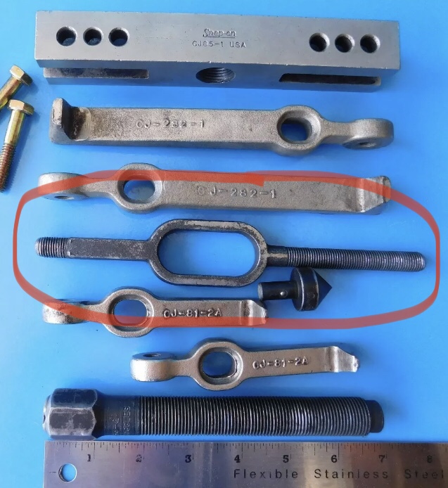

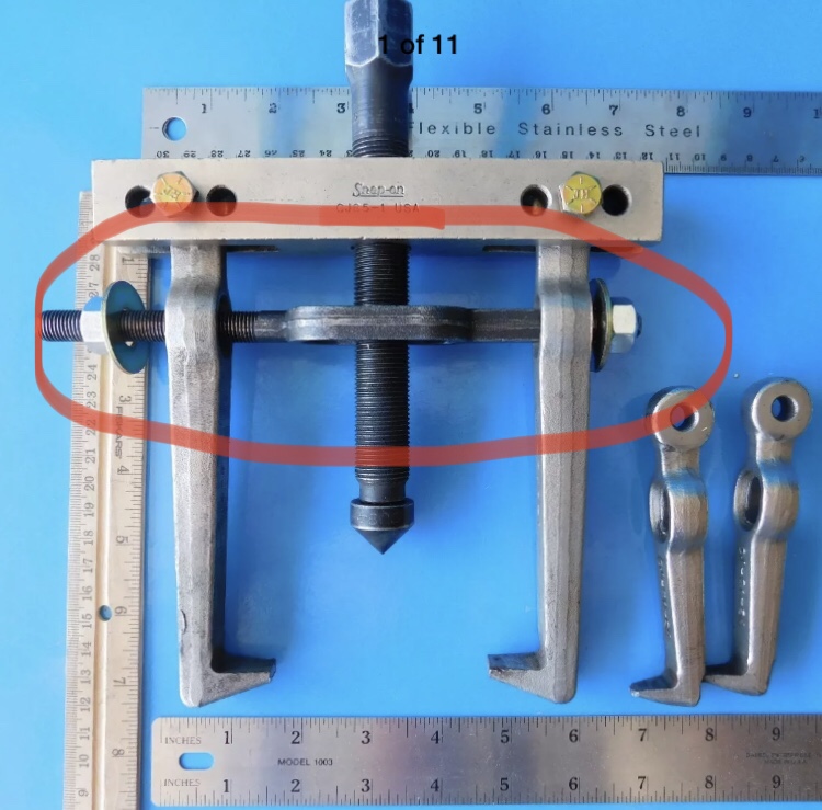

You’ll need a puller of some sort to get the crankshaft timing belt pulley off the nose of the crank as well. You’ll need a puller that you can “lock” the jaws on. The rear face of the pulley is “sloped” or “domed” so a puller that does not have “lockable” jaws will just slip off of it.
This is the exact setup I’ve used for the crank pulley
You could possibly get by with a crank gear puller as well, just saying be prepared for that particular pulley.
Another alternative is, once the crank nut is off, leave the 4-small 10mm bolts attaching the harmonic balancer to the crank pulley. Then use a 3-jaw puller to pull on the harmonic balancer which will then draw the crank pulley off as well. I’ve never done this, simply because I don’t like the idea of using a puller on the harmonic balancer which has a rubber damping section to it.
