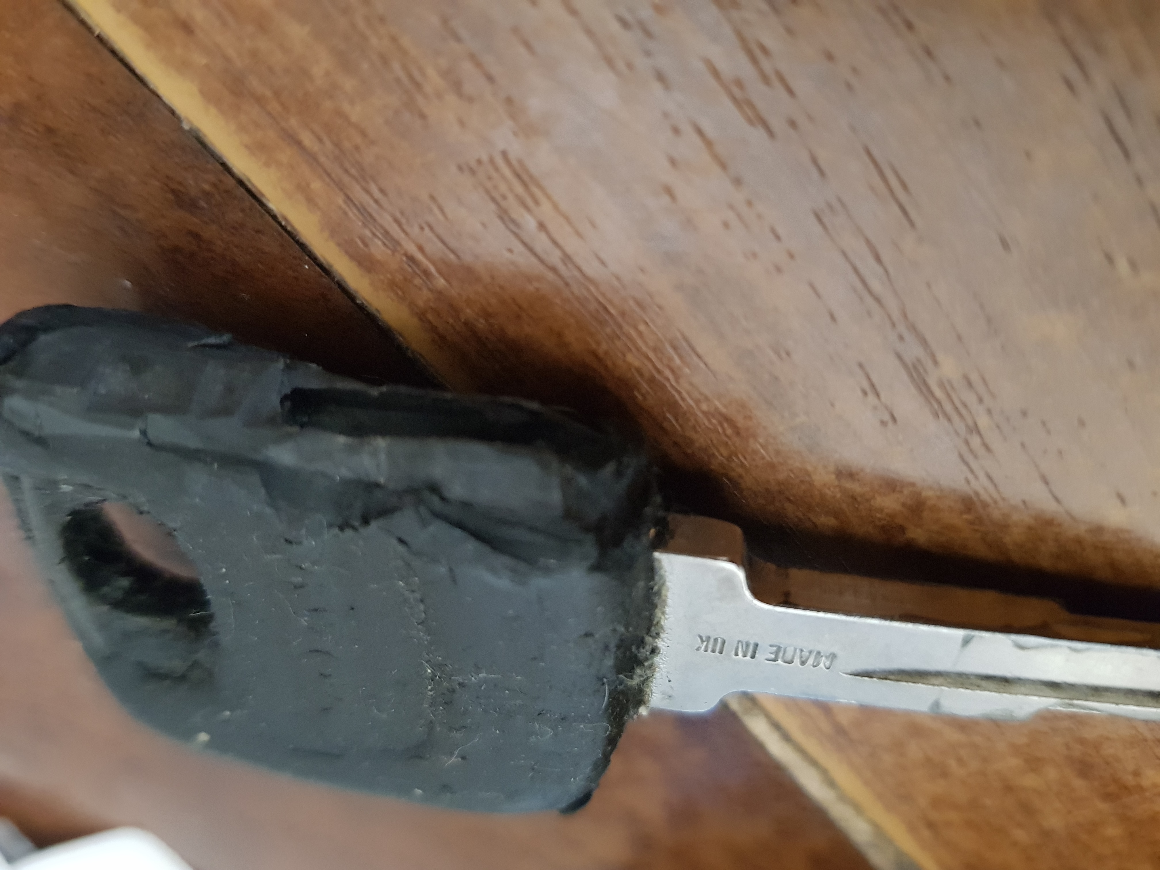

Yagger is in California. I've had no problem getting through to him and I'm halfway across the world. Try Skype username Sergey (yagger) just as I typed it.
Dice is from fleabay with Vida thrown in
ARD can do it if you supply your ECM to them for cloning. With the other guys you need the Dice diagnostic tool (you don't need Vida to be installed) and an internet connection
If the immobiliser info on your ECM is lost ARD can't help either. Best to use Yagger as he can add a new key to the whole system. You'll also need a new ID48 transponder to insert back into the key head (usually from eBay)
