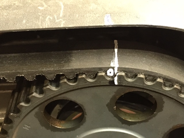

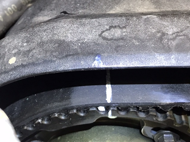

Next, with your 30mm on the crank nut & a breaker bar, go 90* clockwise beyond, stop, then roll it back to your timing marks.
Then blast the nut off with your impact.
Remove serpentine pulley, put nut back on finger tight & realign timing marks w/breaker bar. It never hurts to do the 90*’s past once again if you want to. After that, blast the crank nut off with your impact again (crank & cams should not move), verify timing marks are still correct. I make white paint marks on these - top timing cover which correspond to the notches below, timing belt itself, and fronts of cam sprockets.
You can install the cam locking tool now or after the timing belt is removed. I’ve done it both ways. In fact, I’ve done several timing belt jobs on which I never used the cam locking tool.
Once the cam tool is in & the timing belt is off the fun should begin. With the 2.4T I was able to install the cam tool without the use of the additional spacers & long bolts. I used just the bare tool, short bolts, and 2 washers on each bolt to make up for the extra length. You’ll understand when you go to install the tool. Without the washers in place the bolts are too long and don’t tighten the “locks” into the rear of the cams fully.
After this is when you’ll need to make more white paint marks on the top of the valve cover which will correspond to where your cam sprockets will align. Intake isn’t tough since it’s non-VVT. Exhaust, transfer the white paint mark you made for timing to the valve cover. You will end up with 2 marks - one at full retard (me) & one at full advance. Be cognizant of where your head/eye is positioned when you make these marks!
Did you get a cam locking tool yet? I can send mine if you wanna save some money. I think I paid $85 for mine but that I believe is on the low end for a CTA tools one.
Edit: the 2.4T’s are goofy to me with how everything aligns. For example, in the photos below my crank is aligned exactly as it should be - with the line on the block pointing right between the 2 marks on the crank pulley.
