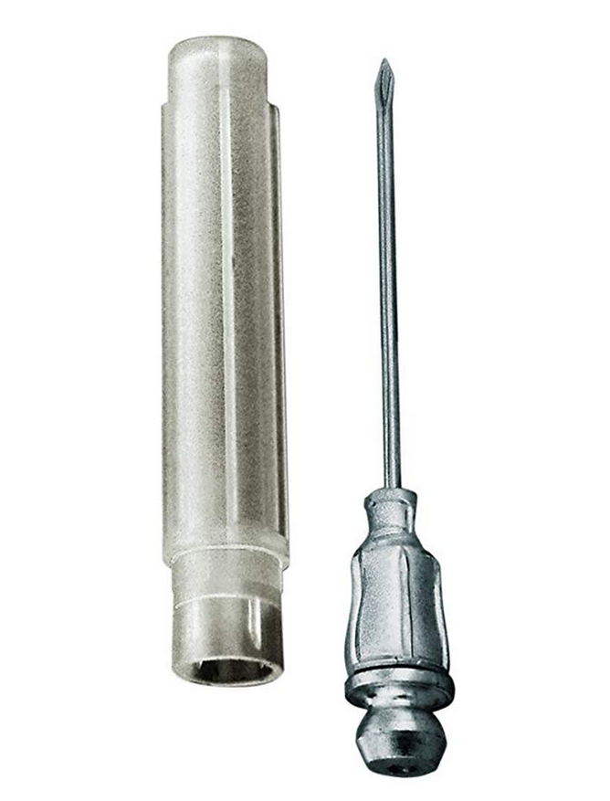

For any part that has a rubber boot that you suspect is bad due to age, try injecting some grease into it with a small needle. Has help postponed CV axle, bushing and sway bar link replacements. It can also potentially help eliminate sounds which were not traceable to anything obvious.
Did this to all the bushing our 2003 Lexus GS300 and the car became super smooth and quiet on the road as if it were riding on oil. Other uses were for a leaking inner CV joint on an 03 Odyssey and the sway bar links with cracked boot.
Plews 05-037 Grease Injector Needle $2.49
https://www.amazon.com/Plews-05-037-Gre ... 96&sr=1-20
