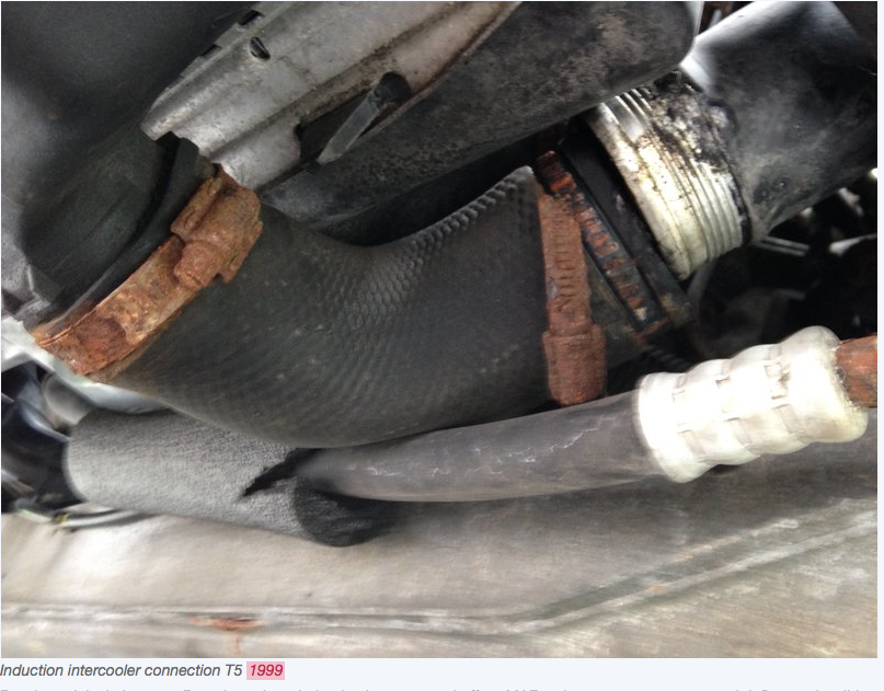

Four things
The open notches cut the rubber into pieces
The bottom of the bolt portion has two sharp edges on the cheap ones which also slice the rubber
The tolerances on the cheap ones suck
The metal quality in the cheap ones is silver cheese and looks like this - yes - these were 'stainless'

Those are all excellent points. I have been a little spoiled on some of these issue as I inherited a huge number of hose clamps from my dad. He was a sailor and had a lot of stainless clamps rated for marine use. ie: real stainless.abscate wrote: 11 Mar 2020, 14:01 Four things
Some/most still suffer from the hose cutting issue but they do not rust.
