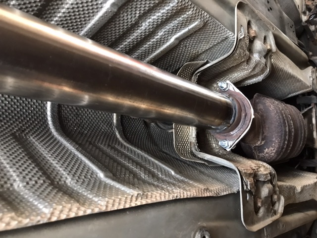

Like Oragex pointed out, look in that vicinity, but also at the resonator (just rear of the cat/flange). The resonators rot out seemingly more quickly than the remainder of the exhaust. No big deal, just cut it out and replace with 2.5” pipe.
2.5” OD pipe will just slide right over the back of the flange as well as the remainder of the exhaust piping - you will not need any adapters, unless it’s an R exhaust.
The flange, also as Oragex mentioned, in front of the resonator will likely need to have the studs cut off & and holes drilled. If you separate at this joint you’ll need to make or buy a new gasket. I’ve made gaskets out of high temp header gasket material, but you can buy online too. $5-6 from IPD.
https://www.ipdusa.com/products/11920/1 ... 45-9179056
The flange is ferrous so you can weld pipe right to it, but make your cuts on the resonator as close to the ends as possible. The pipe itself is not magnetic, but I was able to MIG the 2.5” parts store exhaust piping right to the SS Volvo pipe.
The bonus is you get a little nicer sound coming out the tailpipe
Not louder though.
The hangers towards the rear rot out as well. If they are rotted the exhaust forward from there can sag.

After getting under and looking as close as possible it looks like resonator to cat pipe flanges are rotted pretty good. That also seems where noise is coming from. I like Petes idea if eliminating resonator and replacing with 2.5 pipe. Thanks all for replies, now I just have to get high enough off the ground to work comfortably.

I usually start with a 3’ chunk of 2.5” & then cut it down to an appropriate length.
